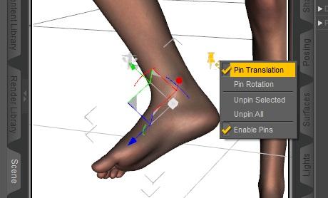

    - Select the foot in the viewport
    - Click on the "pin" and check "translation" in the menu
    - If you move the hip the foot will stay (until you move it to far then the foot will point at the its original location)
    Maybe this is also a solution for your issue.
    EDIT: Sorry forgot to mention this menu only shows when you have the universal tool selected in in the tools menu (use it by default).
