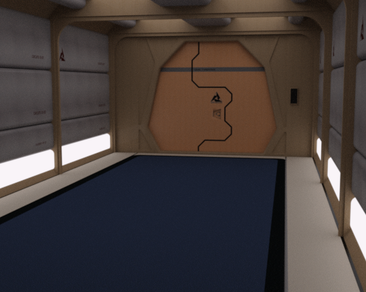

    tjohn said:
    I've seen some renders by Totte and others that appear to be Dimension Theory HDRI sets, including shadow catchers, in Iray.
    Could someone give some step by step on how this is done? Please? :)
    Shadow catching appears to be automatic.
    Render settings for this image:
    Environment mode: Dome and Scene
    Dome mode: Finite sphere (just because HDR image was too low resolution for infinite sphere and in finite mode theres an option to adjust sphere radius).
    Environment Map: HDR image
    Except for reduced sphere radius, rest of the setting ware default.
    Thank you! I'll try that out. :)

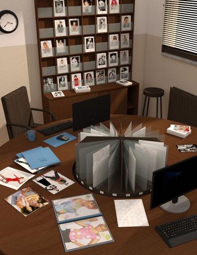

  • macleanmaclean Posts: 2,438

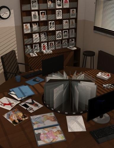

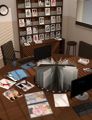

    I've been looking at promo scenes from my products in Iray, and I thought you might be interested in the results.
    I'm not keen on the sun-sky environment in Iray. It gives good results, but I prefer a light I can look through to see what's going on. Setting latitude/longtidute, date & time is not my idea of fun, so I'm experimenting with the Photometric light instead.
    Render settings
    Environment - Scene Only
    Tone Mapping
    Ev 13.94
    shutter speed 1/1000th
    f-stop 2.8
    ISO 200
    Photometric light
    Shadow softness - 0%
    Lumens - 200,000
    Temperature - 5000k
    Ceiling light panels - Emissive shader
    Temperature - 5500k
    Lumens - 20,000
    Render 1 - Strong sunlight
    Photometric light - Point
    Render 2 - Weak sunlight
    Photometric light - Disc
    All other settings as above
    Render 3 - Hazy sunlight
    Height - 3.00
    Width - 3.00
    Render 4 - Medium sunlight
    Photometric light - Cylinder
    Height - 1.00
    Width - 1.00
    Render 5 - Default settings
    Height - 10.00
    Width - 10.00
    Ev 13
    shutter speed 1/128th
    f-stop 8.0
    ISO 100
    All render times approx. 10 mins/90% convergence
    The last Iray render at default settings is of course, too dark, but I wanted a comparison. To get a better result, I would have increased the PM's Lumens, upped the film ISO or Ev.
    Re the Photometric light's dimension. Basically, the trick is, if you want harder shadows, decrease the size. for softer shadows, increase it. In photography, fill panels (large white panels) are used to fill in hard shadows and the larger the fill, the softer the shadows will be. so it's the same principle.
    Also, I would have added an emissive shader to the monitor screen, but I can't figure out how to add the texture to it. Can anyone tell me how to do that?

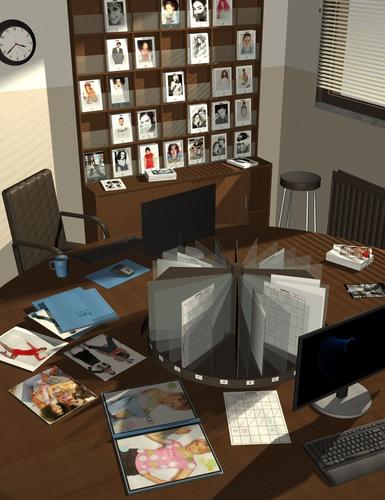

    As a comparison, here's the original promo rendered in 3Delight.
    I can't remember what the render time was. It has 4 lights - sun, room and 2 fills.

    Nice looking Renders.
    First things first. LOL.
    Lat-Long, Time of year/day is only one way to use the sun. You can also use the sundial or just put an object in the scene (Usually a null) and on the environment section of the render settings you can go to the SS Sun Node dropdown pick your object. Wherever you place your object is the direction that the sun is coming from.
    As for adding an image to an emissive shader, set the emission color to white and add your map there, (also put it in the diffuse channel as normal). You may have to adjust the temperature to get a more correct color from the light, though 6500K should give you, about, what you are looking for.
    Your observation on Photometric lights is correct. Think it like comparing a bare photo strobe to a Soft box.
    Yes, I know about the sundial and null, but I still like to look through a light.
    After I posted, I played with the monitor screen and figured out the map had to go in emissive color. I don't have a diffuse channel though, and I had to ramp up emissive to a few billion to get a result.
    Still playing with it though.

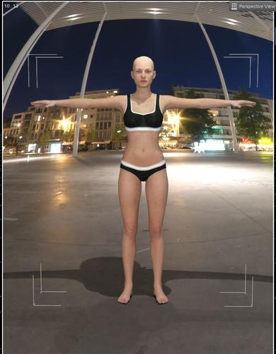

    Yes sir. Setting scale multiplier to 10, and just dialling the dome radius between -30-10 did the trick.
  • Zev0Zev0 Posts: 7,123
    edited March 2015
    Is there a way to reduce the Z-scale of the dome? when I reduce size to match scale to figure, the fisheyed lense effect is kind of strong.
    I've tried all of the settings, still can't figure this one out myself.
    edited March 2015
    I think they need to add scale dials for each axis (X,Y,Z) of the dome. This will be extremely useful..Unless they already exist somewhere and I am just blind lol.

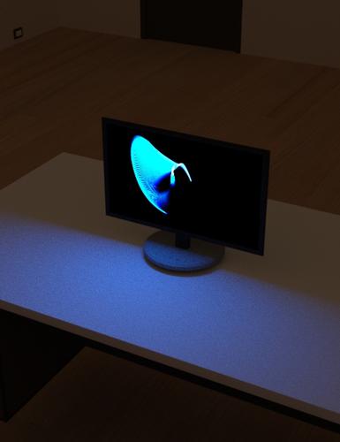

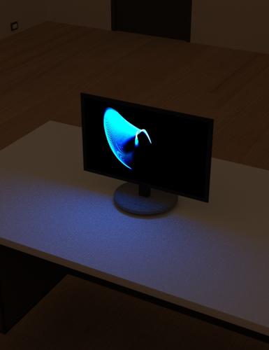

    My experiments on the emissive shader with a texture - in this case a pc monitor with a screensaver.
    Render 1
    Ceiling panels + Emissive shader
    Emission Temperature - 4000k
    Luminance - 3000
    (I kept the ceiling panels' emissive level low, to make the monitor appear brighter)
    Monitor screen - Emissive shader + texture
    Base Color = white + texture
    Emission color = white + texture
    Luminance Units = W (Would it have been too much to use the full word 'Watts' instead of a cryptic W?)
    Luminous Efficacy = 5000
    Render 2
    Luminous Efficacy is set to 20,000. All other settings as above.
    I tried a render at 50,000, but not many monitors give out that much light. It would depend on the rest of the scene and how it's lit.

    Render 2

    Excellent work--thanks for the tips. I much prefer the first because it looks like the bright part of the screen saver is what is lighting the desk. The second one doesn't look natural--like the 'black pixels' of the monitor are sending out as much blue light as the swirly whirly part.

    I'm wondering if object area has an effect on lighting level? In the image below, I set Luminance to 40,000 (from the default 5,000), and although it could definitely be lighter, it's not pitch black. But there are 6 fairly large lighting panels as a single material and I applied Emissive to them. All other settings are at default..
    So maybe instead of trying a candle or ball, you need to use something pretty big. This is just a guess on my part, but in the real world, 6 large panels will give more light than a candle.
    mac
    This is a definite, mac. Something I've learned the hard way with unbiased rendering... IF you want to light an entire scene, your light source is going to have to be physically plausible. A candle in a completely dark room is just not going to light the whole thing. And you need to adjust the tone mapping. Unbiased rendering requires a lot more knowledge of photography than does a biased engine like 3Delight.
    I'm betting you did not change any of the tone mapping settings in that render. If you changed just the Film ISO you'd see the difference. For indoors, I'd start with at least an ISO of 400 and tweak the other camera settings from there.
    There is going to be a somewhat steep learning curve here; one really needs to learn the renderer from scratch.

    In this render, I set the light sources (walls and ceilings) to emissive.
    I changed nothing on the lights but to set them to 6500 Kelvin ('daylight').
    However, I changed the tone mapping settings: Flim ISO = 400, F/Stop = 5.6
    This was just a quick render, I changed nothing else... no shaders, nothing.
    The tone mapping settings are still not quite right... but I stink at those.

    ok, still nothing special. I toned down the wall lights (5000 kelvin to make them warmer and 1500 luminance), slapped some metal and plastic shaders on the walls and doors and adjusted the tone mapping (ISO = 300, f/stop = 4).
    Even though unbiased rendering is great with light, to think that we can throw away all the tricks we've learned about lighting a scene is a fallacy. You have to think about it differently, but a lot of it still applies.
    This scene is in no way ready for a character or big prop. I'd need some more area lights or spots or points to give my subject the light I am really looking for. All I've done to this point is setup the environment to something like what I would want.
    I hope this information is of some help to someone.

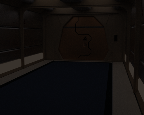

    I realized I should have included a render with the default tone mapping settings so one could easily see the difference (these are much darker appearing on the forum than the renders appear on my monitor.. so I'm still not quite right). Anyway, these are default tone mapper settings of ISO 100 f/stop 8 with the lights the same as the image immediately above.
