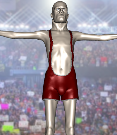

    So, I decided to take on Mec4D's Wrestling Singlet.
    I find that DAZ tends to have problems with "strappy things" around the torso, as they often follow the breasts/pecs in a manner that real straps wouldn't. Like so:
    It probably didn't help that the above example uses auto-fit to put this G2M item on a G8M. But even in the promos you can see some awkwardness around the pectorals.
    So, dForce. Here's the scene before the animation starts:
    Freaky! surprise
    And here's the result:
    Gotta say, I'm very pleased!
    (I did get some minor cases of awkward geometry in some spots which I corrected in post.)
    dForce surface Settings
    Friction: 0.2
    Stretch Stiffness: 0.01
    Self Collide: OFF -> this avoided some mini-explosions that I would otherwise get around the garments edges.
    Gallery link

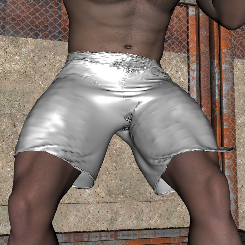

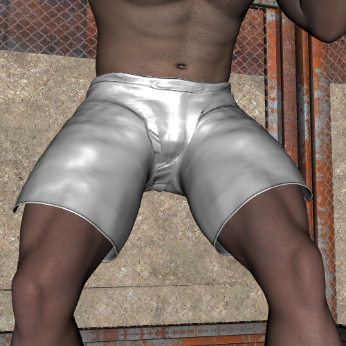

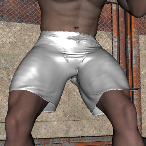

    Does MMA Shorts for G2M dForce? Well, yes... kinda sorta.
    It's clear that the item is not meant to be dForced. The simulation takes quite a long time for what should be a simple garment. The result has some awkward geometry. Some of that you can lessen with a smoothing modifier. But turn up the values too much and the whole thing explodes.
    The slits on the side of the legs don't help, either. In my below example there's this weird little flap on the left leg that won't go down no matter how long I let it stabilise.
    Despite all that I still think the garment looks better dForced than without.
    Only autofit:
    Autofit + dForce
    Autofit + dForce + Smoothing Modifier

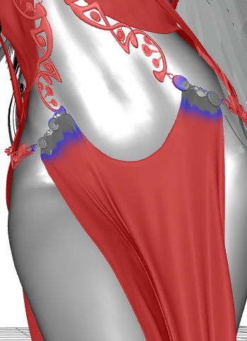

    So, does the Mistress Arachne Outfit dForce?
    Yes, but only if you weightmap it.
    In my example only the front flap is affected by dForce. The back flap poses well enough without dForce and the rest of the outfit is form fitting anyway.
    To keep the front flap from falling to the floor, use weight mapping to disable dForce on the upper part.
