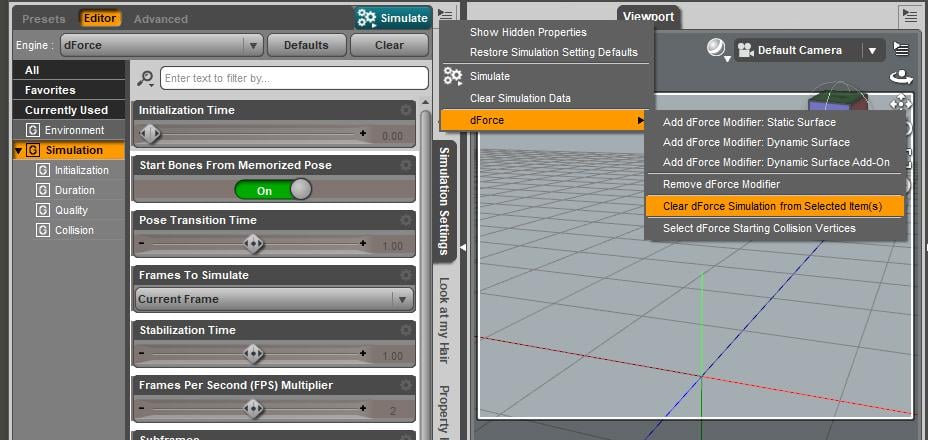

  • barbultbarbult Posts: 27,382
    edited December 2018
    Odaa said:
    marble said:
    RGcincy said:
    Also, something that catches frequently catches me, DON'T use the Clear button on the Simulation Settings pane!. Even if an item is set to freeze the simulation, the clear button overrides that and you'll lose what you had done.
    I have now added two actions to my main toolbar:
    1. Clear dForce Simualtion for the Selected item - (I had to find an icon for the toolbar because th action doesn't have one). This avoids using the main Clear button which clears everything (including frozen items). This is saving me much frustration. smiley
    Where did you find the option to do that, before you added it to your toolbar? I've only ever noticed the Clear Simulation on the Simulation tab, just below Simulate, and that of course clears everything.
    On the Simulation Settings hamburger menu.

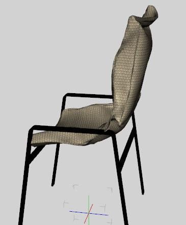

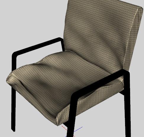

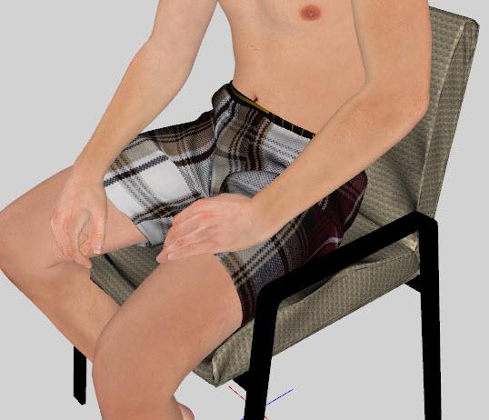

    64. Chair Cushions. Here’s an example showing how to get a chair cushion to deform from a figure sitting in it. I used a chair from Back Door Walkway. As with clothing, some chairs simulate well and others will explode or crash DS. The only way to know is to give it a try and use a weight map to remove as much of the unneeded geometry from the simulation.
    a. Load a chair. Set the viewport to Wire Shaded and check for trigons (which make objects harder to dForce. The chair I selected had quads as shown in the image).
    b. Select the chair in the Scene pane and go to the Surfaces pane and see how many surfaces are present. If only one, you will need to use the Geometry Editor to select all the polygons associated with the frame and assign them to a new surface.  If more than one, your chair model likely has that done already.
    c. Add a dForce dynamic modifier to the chair.
    d. Go to the Surfaces pane and for any surfaces related to the chair’s frame, set Visible in Simulation to Off.
    e. For cushion surfaces, I would set Density to 25 as this will give a stiffer surface.
    f. In the Simulation Settings pane, set Gravity to -0.2 as this will let the cushion move up and around the figure. Set Frames to Simulate to animated timeline.
    g. Load a figure that is standing in front of the chair in frame 0 and set a keyframe on the animation timeline. At frame 10, apply a sitting pose on the figure. Adjust the figure so the buttocks are embedded somewhat down into the cushion and the figure’s back is embedded in the seat back cushion if there is one.
    h. Run a simulation to see how the cushion deforms. You will likely find the cushions deform more than you want (as is the case for this chair, see image. Note that I’ve hidden the sitting figure). Since there’s a lot of deformation around the sides and top, I added a dForce modifier weight node.
    i. Select the added node and choose the Node Weight Map Brush tool in the Tool Settings pane. First add an influence weight map then use the brush or other tools to select all the polygons associated with the underside or backside of the cushions. Once selected, right click in the viewport and choose Weight Editing/Fill Selected and set to 0. This will keep these polygons from changing during the simulation. The first image show all the cushion and frame with an influence weight of 1 (it doesn’t matter that the frame is at one as we turned its surface Off for Visible to Simulation). The second image shows the underside and backside polygons are free of red, so the influence weight in those areas is 0.
    j. Run the simulation and you should see the cushion move up and around the figure. How it moves depends upon how the mesh is structured, the shape of the figure, its pose, and other factors. The left image shows the figure in the chair. In the right image I hid the figure so you can see how the chair deformed. If this is more deformation than you like, you can choose an earlier frame or set density even lower.
