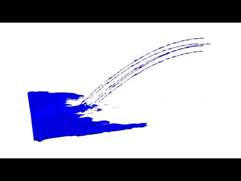

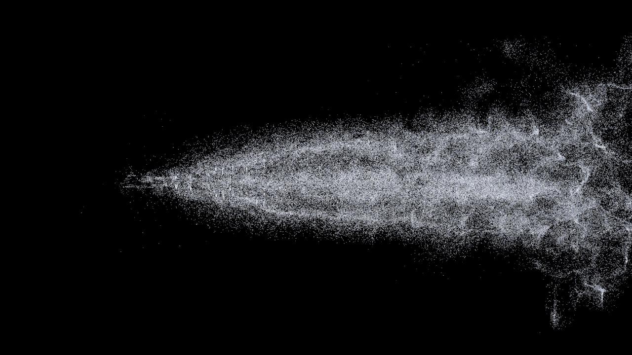

  • AlbertoAlberto Posts: 1,458
    gerster said:
    And raid? Or a shower? wink
    A shower can be done just now. Imago's example is here:
    Imago said:
    Glad to have been helpful! wink
    For GLE, here a quick example. I used five sources here without any noticeable increase in the simulation's time. You can use more than that to obtain your shower! laugh
    Spray can be simulated enabling diffuse particles in Domain and the Mesher.
    duf
    duf
    spray.duf
    25K
    1280 x 720 - 495K

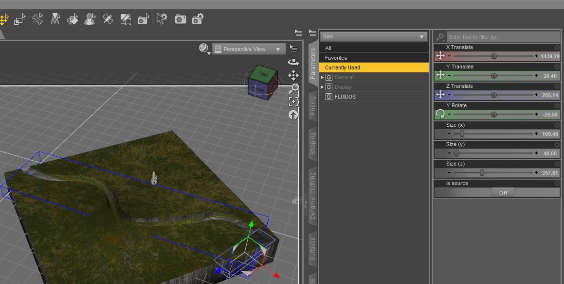

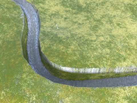

    This is video of a river flow simulation.
    This is the setup of the river. There is a source in one extreme of river bed, and a sink in the other. A cube is used for the initial water. It was added a little value to Force X to force the water to flow. The smoothing is for avoid the staggering over the river bed. Diffuse particles are enabled.
    Here are the Source Properties. All velocities are set to zero. The body forces will push the water.
    Here are the Sink Properties
    The cube properties:
    The terrain acts as a obstacle, thus, no changes were done, but the parenting to Domain.
    These are the properties of the first mesh, for reconstructing the water mesh.
    These are the properties of the second mesh, for reconstructing the Whitewater (Diffuse particles).
    The meshes should be enabled after concluiding the simulation process.
    The .duf file is attached. If you load it in Daz Studio, don't forget to adjust the preferred device.

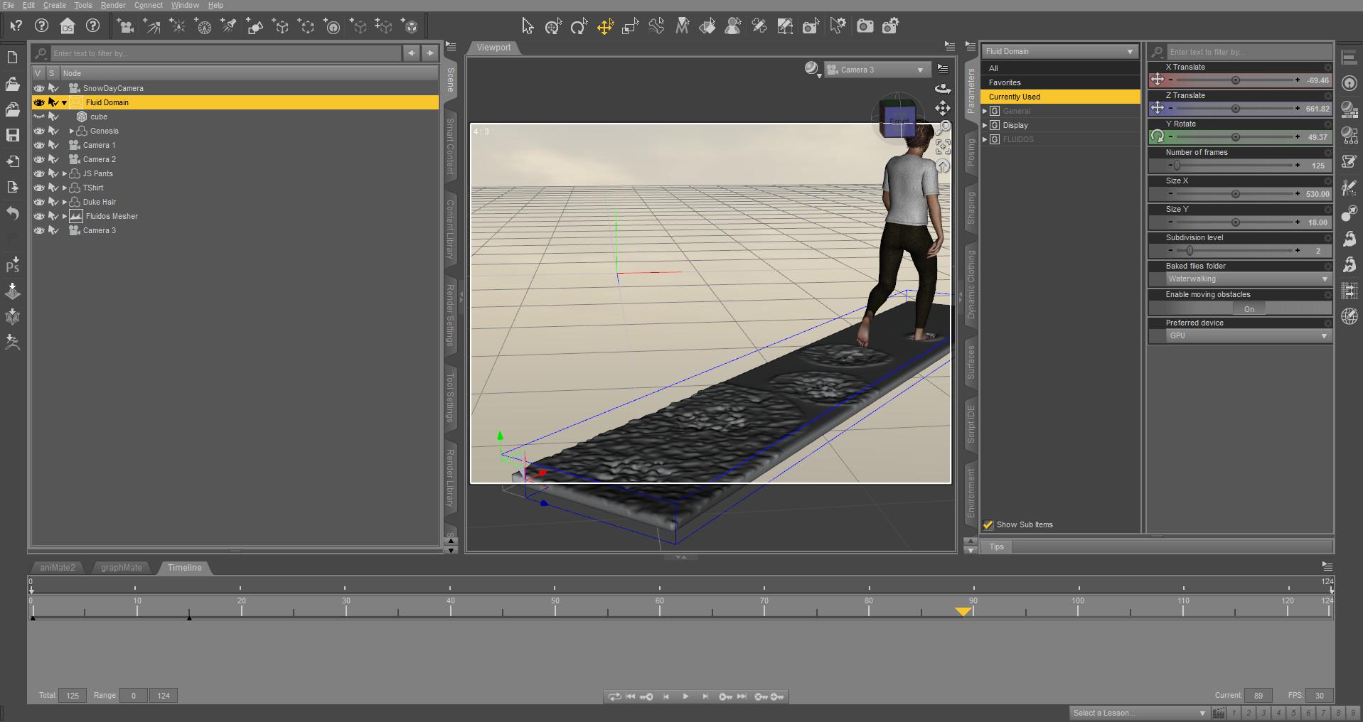

  • smaker1smaker1 Posts: 281
    Hello Alvin
    having fun with Fluidos :-)
    What would be the best way to have a "calm" water cube with someone waking and making ripples on the surface ? I tried to liquify a cube but my results was not good
    Thanks for you help
    smaker1 said:
    Hello Alvin
    Thanks for you help
    You are parenting the figure to the domain, and turning the fluid body option off so that it's an obstacle? That said, I am not getting the results I would expect from a cylinder pushing into and out of a block of water - there are not ripples propagating away from the point of intersection, just a dent there. This is with force on for the cylinder prop, the last frame of a 200 frame simualtion:
    878 x 942 - 80K
    smaker1 said:
    Hello Alvin
    Thanks for you help
    Turn ON "Enable Moving Obstacles" in Domain's Main settings. This way, the cylinder could push the water.

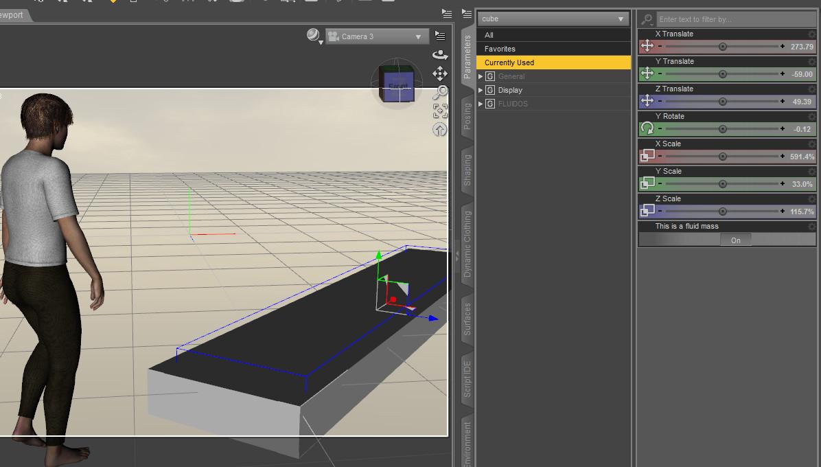

    smaker1 said:
    Hello Alvin
    Thanks for you help
    Try to use the shallowest water you can (to get faster simulation). Set ON "Enable Moving Obstacles" in Domain's Main settings.
    This is the same I used in Genesis walking over snow in the second demo. Here, viscosity is disabled.
    The cell size is 2.5. You could resize the domain (and the cube), but try to not reduce the resolution. In this scene, the Grid size is 217 X 7 X 40 = 59,360 cells. Thus, any modifications should have around  60,000 or more cells.
    Here you see the Domain settings.
    Cube settings:
    If you use aniblocks, bake them so the plugin can recognize the keyframes.
    The .duf file with the Domain and the cube water is attached.
    1196 x 680 - 141K
    1917 x 1016 - 264K
    duf
    duf
    shallowWater.duf
    11K
    Many Thanks Alvin !
    This look very promissing. I'm gonna study this tomorow (too late for me right now!)
    Fluidos open plenty of new possibilities. Congratulations!!!
    Thanks again for the support

    https://www.dropbox.com/s/y4h890dl1wvrew3/Fluidos Ripple Test II.avi?dl=0
    Oh, the cube is hiding the mesher.  Set Visible to OFF. I think this is the reason of the dead flat. You don't need to run again the simulation.
    Any mesh supposed to be fluid mass must be invisible for rendering.
    Ah, that was it yes - thank you.
