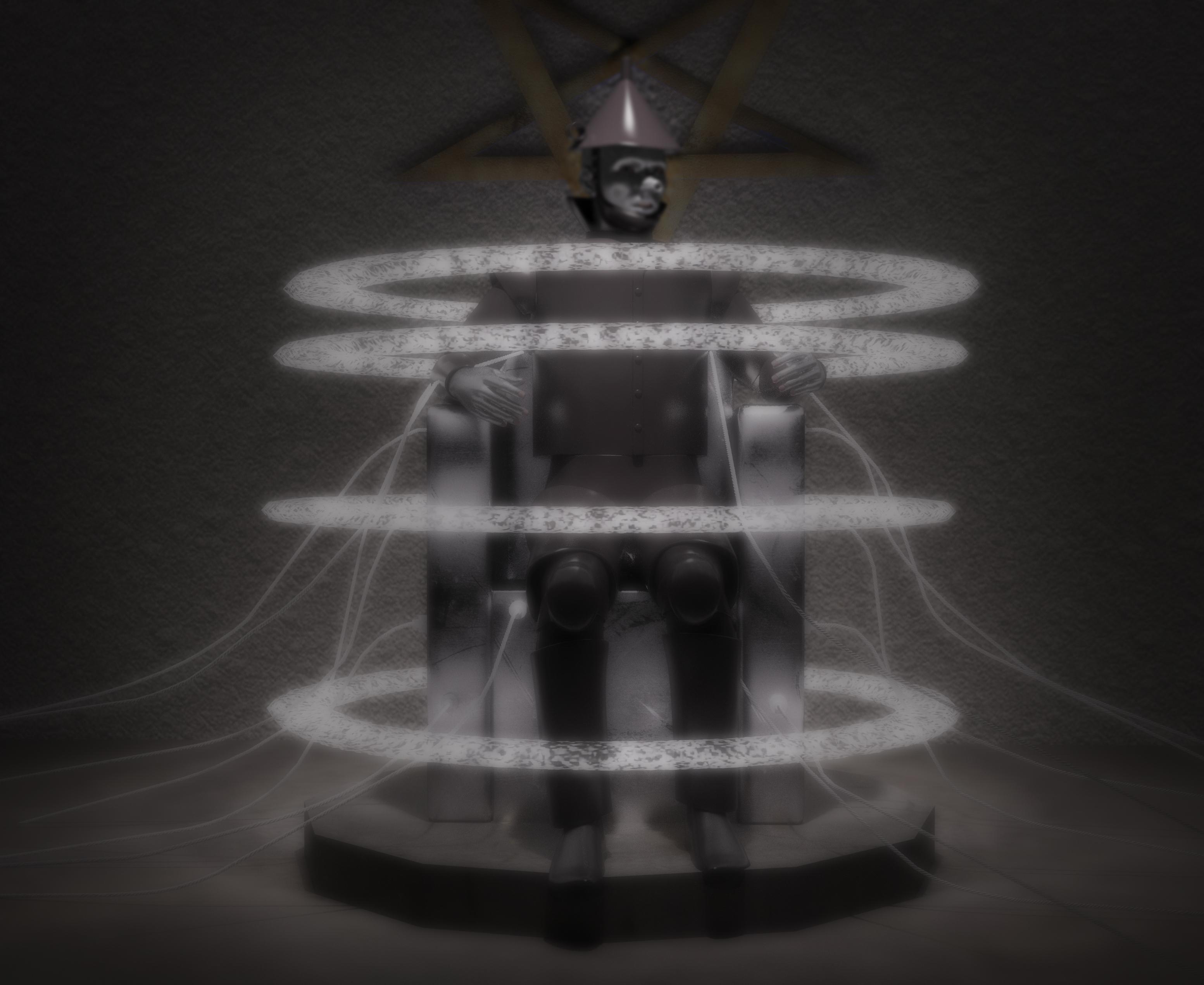

    edited April 2018

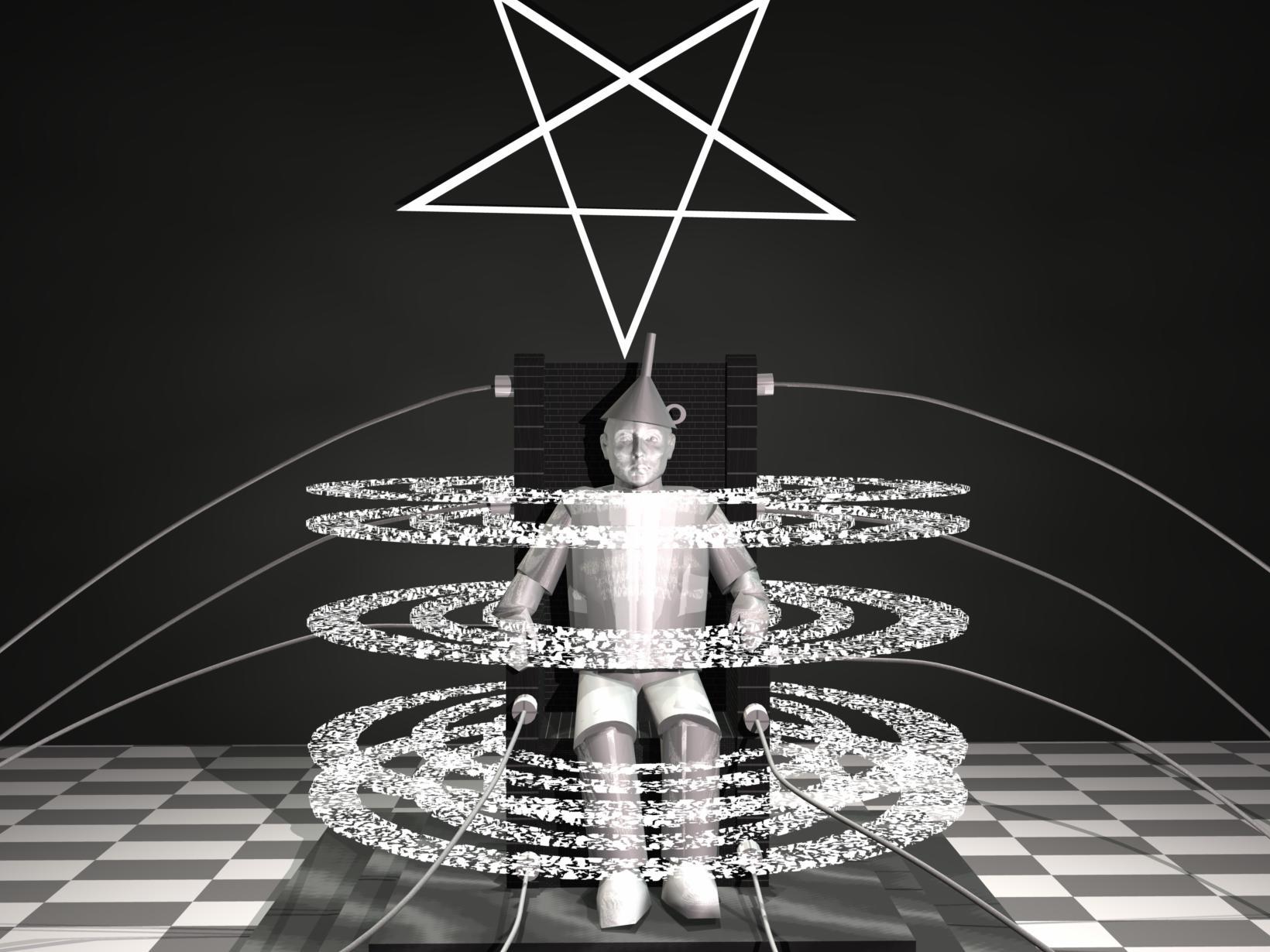

    Here is the current state of Metropol-Oz 2.
    Edit: Aaaargh - wires pierce Tin Man
    3106 x 2541 - 5M
    Post edited by Diomede on

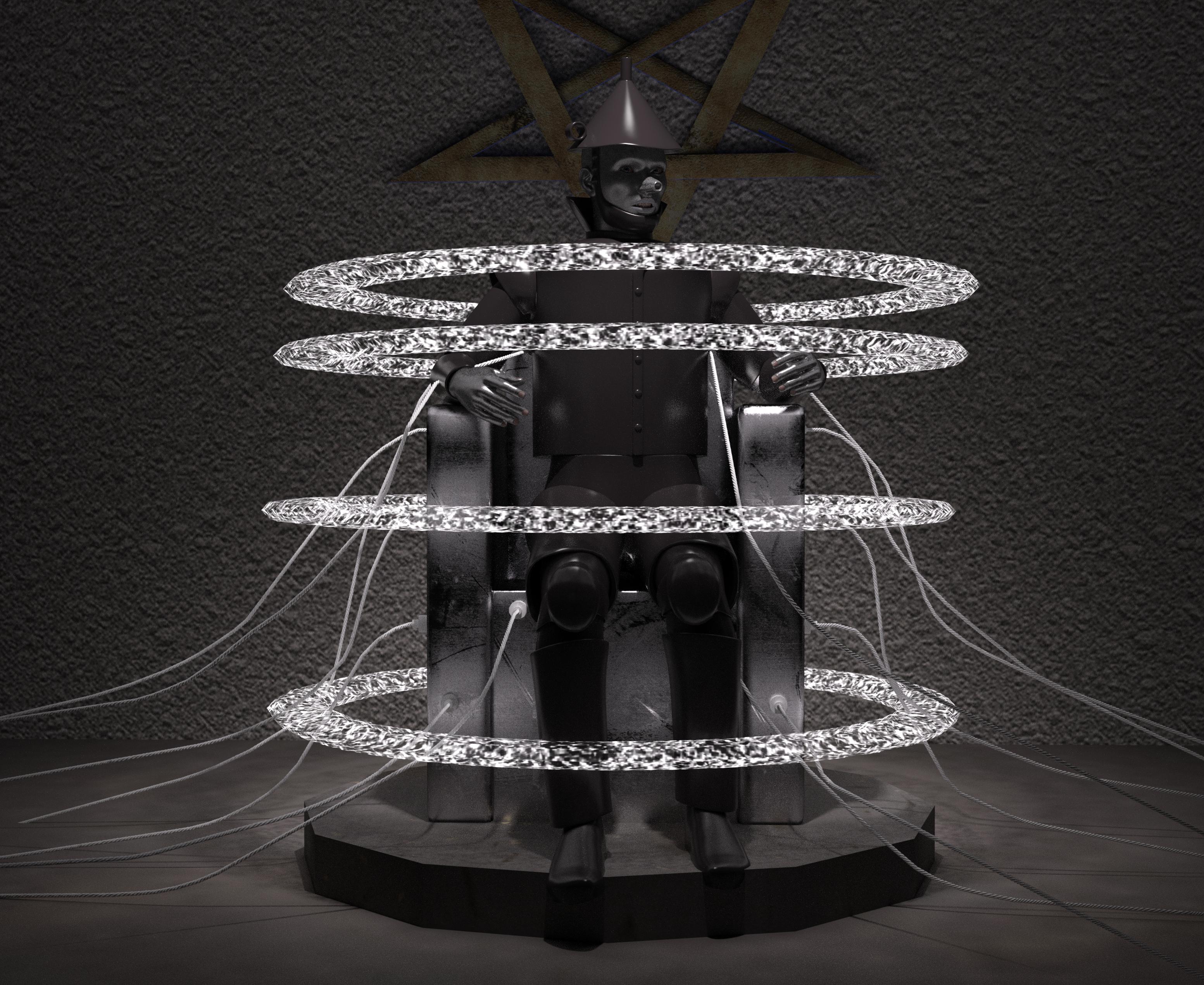

  • DiomedeDiomede Posts: 15,448
    Here is the same render after some postwork.

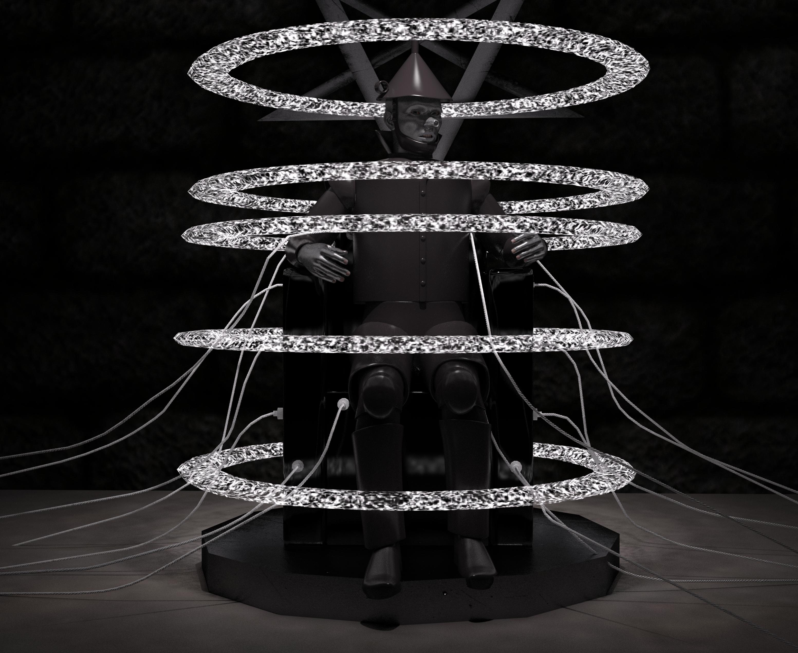

    Here is the straight render for the next iteration.  No postwork yet.
    - adjusted wires so no longer pierce Tin Man.
    - changed all the shaders so that chair is darker than Tin Man's skin.  Pentagram also has metaliz shader.
    - added one more light torus above head, and moved another torus below his head.

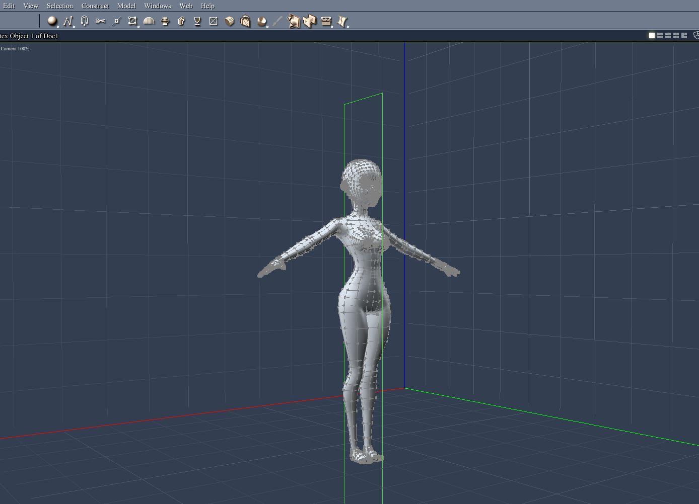

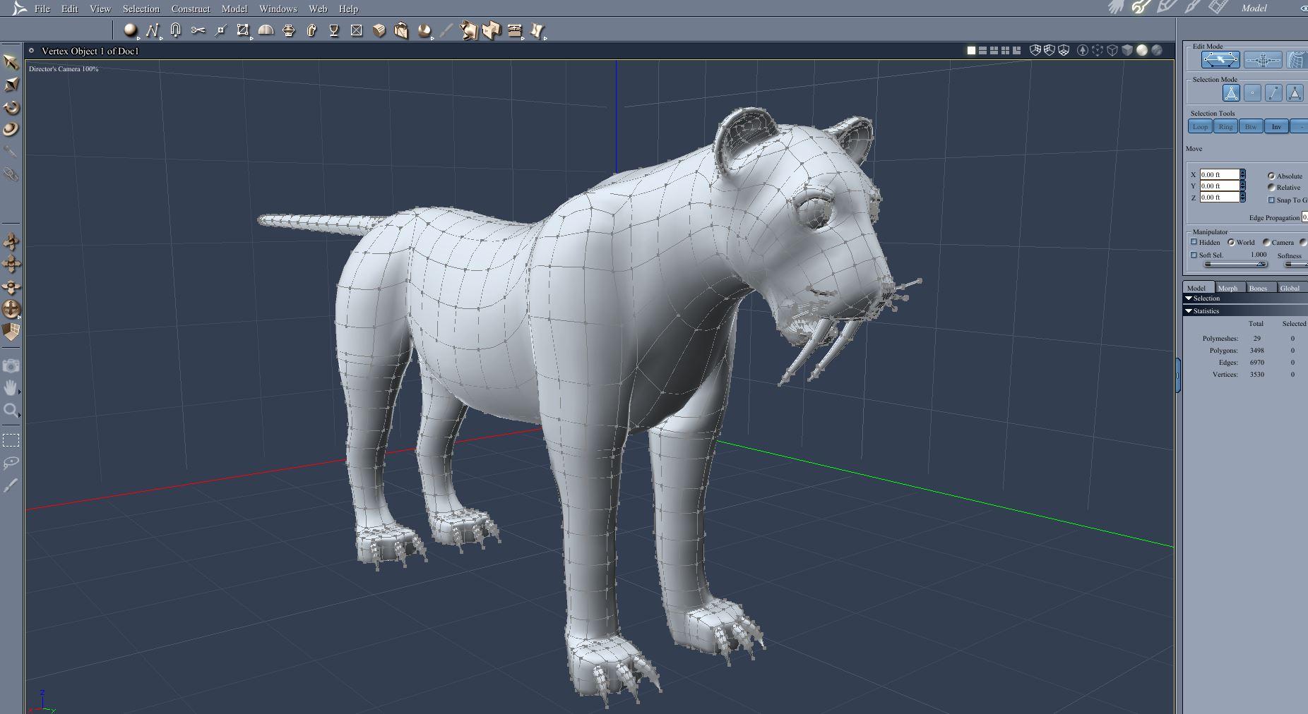

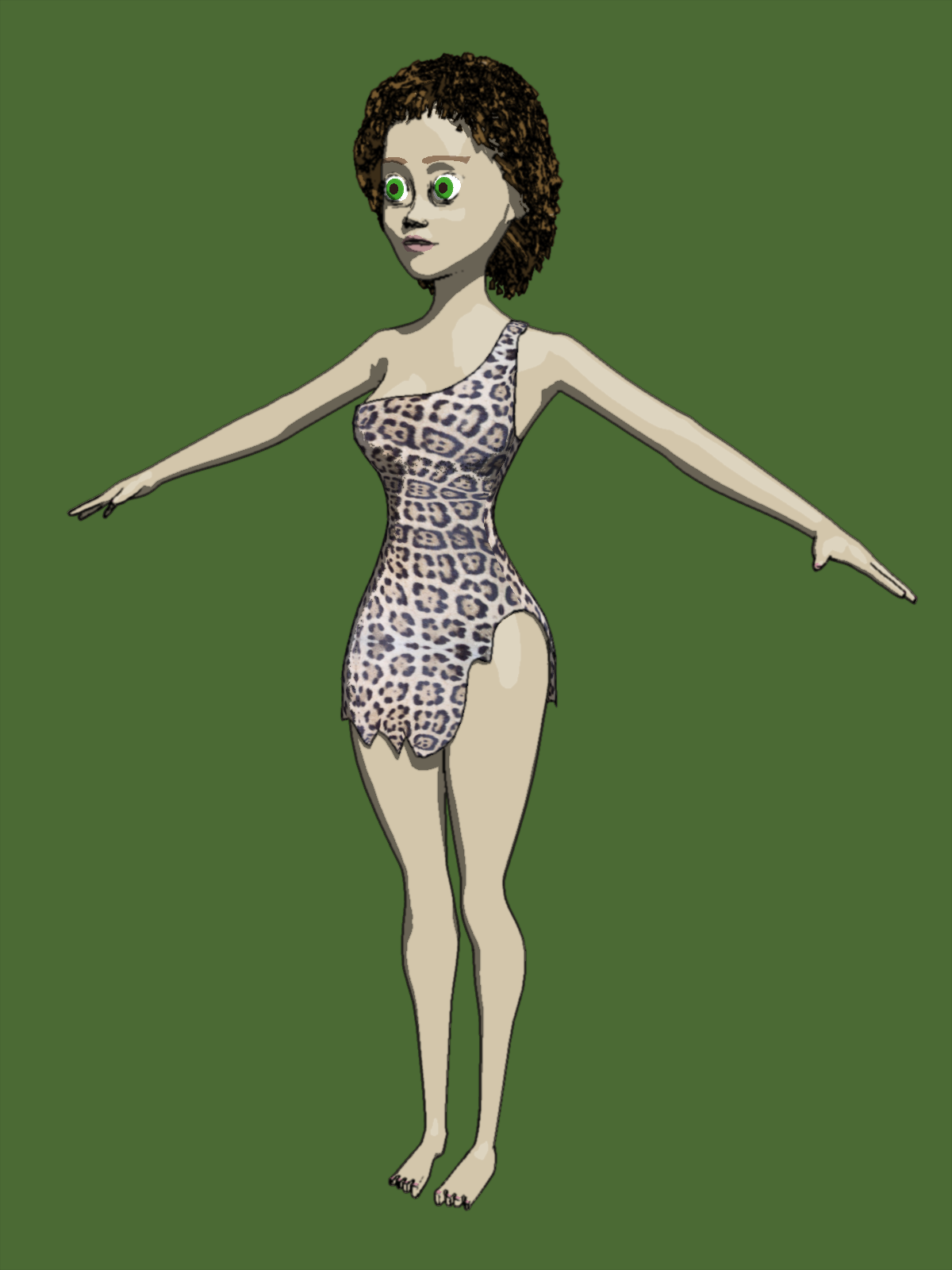

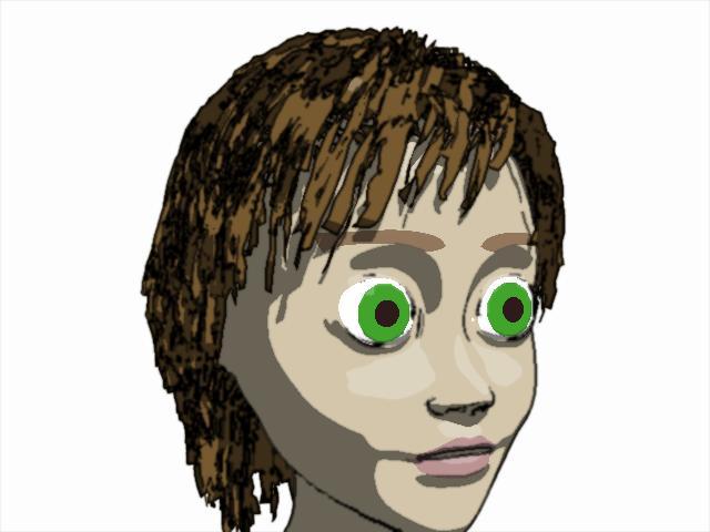

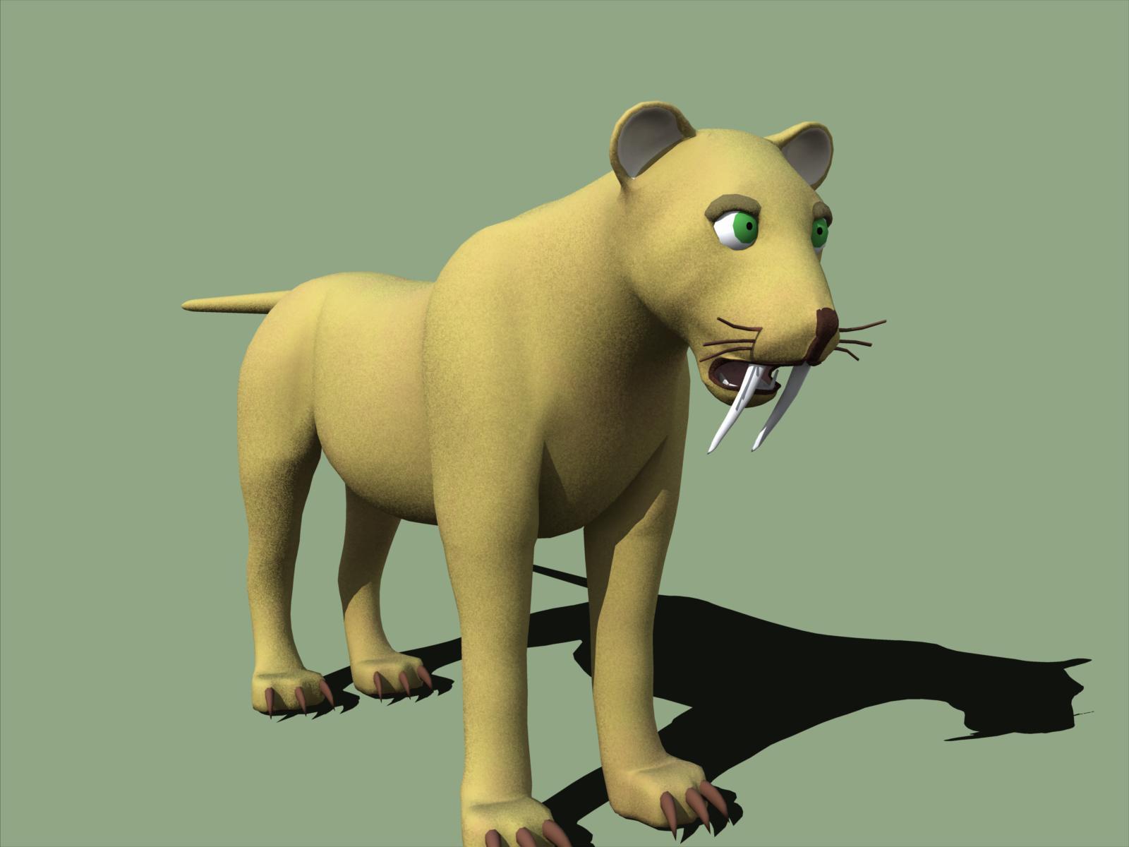

    Haven't updated for the last ten days or so because I've been having fun modeling some toon stuff, which I often enjoy more than rendering stuff.
    Here are some toon figures (3 fingers and toes instead of 4, big eyes, that sort of thing) I've been working on for an ambitious animation project in which a cave girl escapes a saber tooth tiger by jumping in a pond and then through time travel emerges in a modern pool.
    Cavegirl, modeled in Carrara
    Making a morph so the hair can become wet
    https://www.daz3d.com/forums/discussion/comment/3560896/#Comment_3560896
    Saber Tooth Tiger
    https://www.daz3d.com/forums/discussion/comment/3567136/#Comment_3567136
