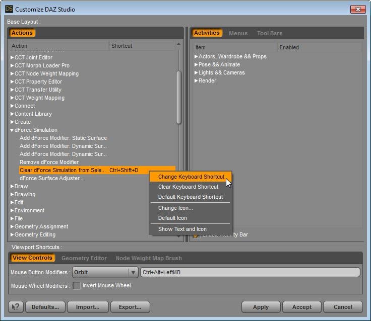

    20. Short-cut Key to Clear Simulation on Selected Item(s).
    Oftentimes I want to remove the dForce simulation from one item. You can't use the Clear key on the Simulation Settings pane as it clears all simulations, even those that are frozen. So to clear a simulation, you have to select the item and then do a multiple-step menu selection from either the main menu or the Simulation Settings pane menu. Not all that hard but it gets old to keep scrolling, clicking, and scanning down menu lists to get to this one command.
    You can add a keyboard shortcut to make this a quick process. Click on the F3 key to bring up the Customize menu. Scroll down the Action column and left-click on dForce Simulation. Then right-click on the item Clear dForce Simulation from Selected Item(s) and choose Change Keyboard Shortcut. Type in a key combination (I used Ctrl+Shift+D). Now when you want to clear the simulation on an item, choose it in the viewport and type your shortcut key and you're done. Much faster!
    Hint: after setting the shortcut key, close down Daz Studio and reopen it so the new shortcut key is remembered. Otherwise a crash (which dForce is prone to do) will lose the new setting.

  • wsgentrywsgentry Posts: 573
    edited December 2017
    Thanks for the tip, Rich.  I have a scene with twelve d-Force'd items in it based on your tutorials. Eliminating menu trips will make this task much easier!  Funny thing about having so many d-Force'd things in a scene, the simulation progress dialog often takes a long time to appear with the dreaded "Not Responding" Alert popping up before. After a bit the simulation progress dialog always appears, though.  I wonder if others have noticed this?   For the record, I've got an Alienware G4 17 laptop, 4k display, 32gig RAM, boot and swap is on an SSD, and I have a GTX 1080ti on the Allienware Graphics Amplifier (with the Graphics Amplifier the built in 1080 is disabled, display is handled by the onboard Intel chip).
    Scott

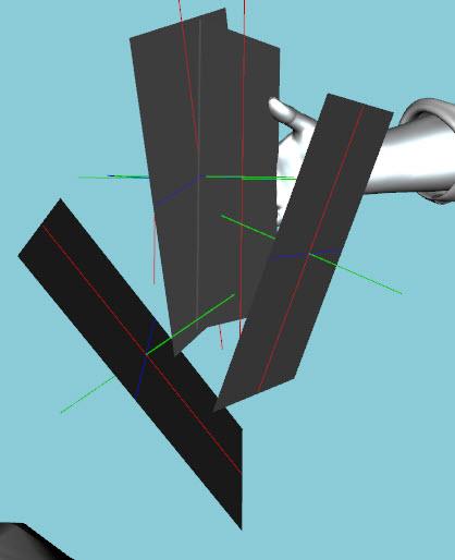

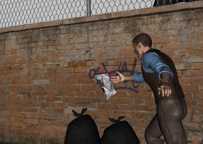

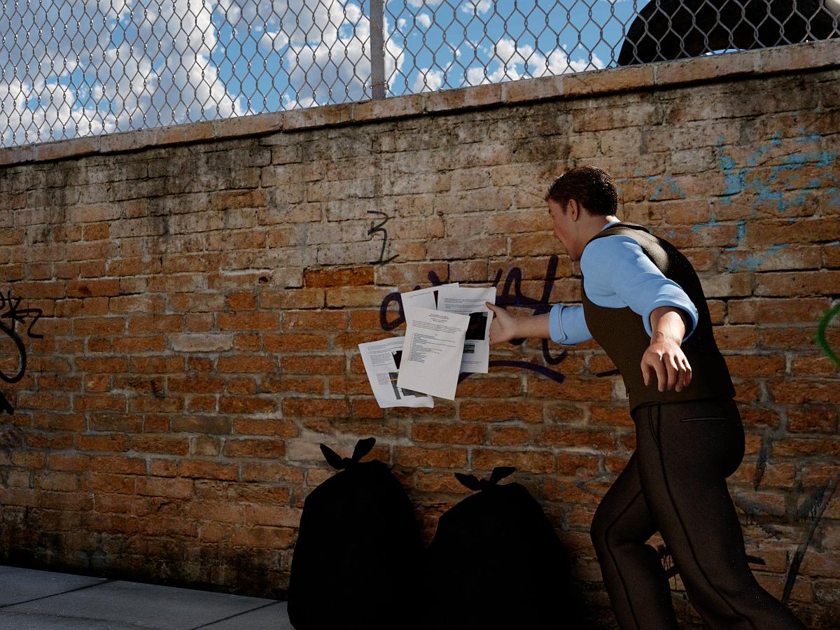

    21. Dropped Papers. As I think of ways I might use dForce, I get caught thinking dForce is a physics engine which it’s not (at least in its current implementation). So something I think would be easy to setup takes more time and relies more on me than the simulator.
    A case in point is a set of dropped papers. The scenario is that of a man carrying a stack of papers in his hands. The wind catches them and blows them away with the man giving chase. Ideally, I could create a stack of say five planes, pose them in space in front of a wind node, and run the simulation. The papers would start to fall, the wind would grab them, and they would simultaneously separate from each other, warp and rotate in the wind, and fall downward as well as move forward. Sounds simple but it doesn’t work. Rather, the papers either collapse into a heap of limp cloth or they stick to each other. I can get something that looks like I want but it’s by me “faking” the wind and gravity motion, meaning I’m using imagination not physics.
    Here’s the result I achieved:
    I made 5 primitive planes for the papers. I scaled them in one direction so they were rectangular. I took screen-shots of this write-up and used them for the diffuse texture map. The papers dissolve into limp cloth if you run at full dynamic strength so I I turned it down to 0.85:

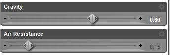

    I found the papers fell too fast at full gravity, so I set it to 0.6:
    Here’s the wind node position:
    And the wind node parameters:
    Here’s the starting position of the papers. As you can see, I had to move and rotate them myself as dForce will not:
    A close-up of the papers after simulation:

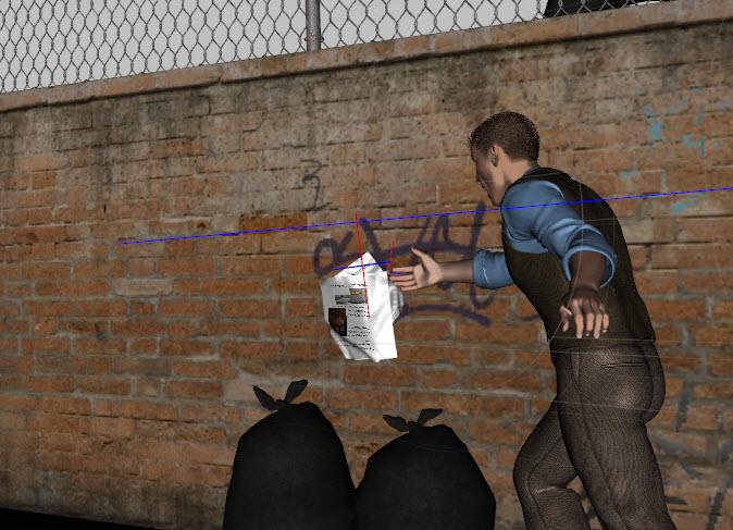

    My curiousity with the wind snatched paper simulation above is the wind speed is so slow at 0.040 or did I miss where it was changed? I think its need to do a 10 second animation simulation that has a wind gust come in at 10 MPH or faster to snatch the papers.
    You raise some good points. The wind speed was that low because the wind speed in dForce is not representative of real life. In my previous post using wind on hanging towels, I mentioned setting wind speed to 0.2 instead of the default 5 mph, as 5 behaves more like a hurricane. In this case, I found high wind caused the paper to have too much folding, so the 0.04 value came from testing various speeds to get something looking like paper with only some curling at the edges. [Note: this may be affected by Daz Studio version - I'm not seeing this ecessive wind behavior as much with the most recent one].
    I did go back and try a 10 mph wind with two different versions of this scene. One as shown above and one were the papers are stacked but do not touch each other or the figure. In both versions of the scene, at 10 mph 2 papers flew off (3 stayed put), then as the simulation proceeded the two that flew off came back and it looked similar to before. Those were done with a single frame simulation. I repeated with a 30 frame simulation and in this case, the papers stayed in place only moving slightly. Frame 6 of 30 showed the most movement.
    Stacked papers at 10 mph, single frame simulation:
    Stacked papers at 10 mph, animated simulation, frame 6 of 30:
    This last one is not too bad.
