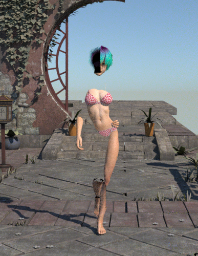

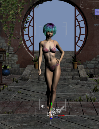

  • TofusanTofusan Posts: 28
    Hello, Spheric. Thank you for making a great plugin.
    I tried to create and render a few scenes. But I found a problem. This scene of the mesh so that looks incorrect. So far, this phenomenon seems to occur only in "Streets of Asia" by Stonemason.
    I'm using Luxus version 1.0.0.4 and LuxRender version 1.2.
    682 x 885 - 1M
    600 x 776 - 846K
  • willowfanwillowfan Posts: 238
    edited March 2013
    I had this happen on one scene I was trying to render. As above there were bits missing from nearly every element in the scene. Nothing I tried would fix it, including deleting and reloading elements of the scene, deleting and reloading lights, changing the background, using a different skin texture etc, I tried rendering the scene a few times and each time the same thing happened but not necessarily in the same way (ie different things were invisible each time)
    In the end I just assumed that the scene save had become corrupted in some way and abandoned it. Not had it occur since.

  • stump3point1stump3point1 Posts: 139
    I had this problem when I tried to render at too high of an resolution, What resolution did you set for this?
    I found with 8 Gigs of ram the max resolution could not exceed 2000X2000 so I set mine below that and didn't loose anything.
    Hope that help's.

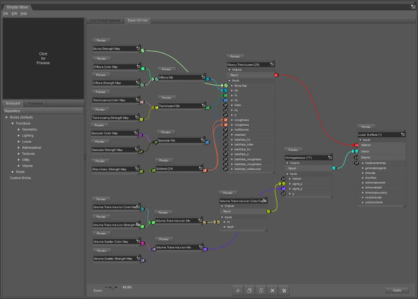

  • CzexanaCzexana Posts: 167
    czexana said:
    Ok, I see the points being made here and you're right - don't mess with the current shaders and the way they're mapped.
    Perhaps it would be possible to add an alternate version of the glossytranslucent shader that is set up with the additional greyscale mapped strength channels and glossiness rather than roughness? And maybe a volume option with transmission colour and depth rather than absorption? Then users could decide whether they want to use the native Lux channels or something that looks closer to standard DS shader settings.
    It certainly could be improved. In regards to changing the current glossytranslcuent, Eluxir should be able to do it. I need to get back rolling on that. That will be an excellent use case to make sure works.
    I was trying to do this, and mapped out a network for glossy translucent plus volume (see image), but I can't get Eluxir to work currently. Whatever network I put on a surface I just get the following material:
    Texture "diffuse_color" "color" "constant"
     "color value" [0 0 0]
    MakeNamedMaterial "material0"
     "string type" ["glossy"]
     "texture Kd" ["diffuse_color"]
     "color Ks" [0 0 0]
     "float uroughness" [0.8]
     "float vroughness" [0.8]
    I'm using Eluxir v0.0.0.4, latest 64-bit DS 4.5 (v4.5.1.56) and Luxus (v1.0.0.4).
    1379 x 987 - 175K
  • SphericLabsSphericLabs Posts: 598
    czexana said:
     "color Ks" [0 0 0]
    If you are willing, please pm me a link to that shader and I will make sure it works.
    stumpc said:
    Hope that help's.
    The resolution of attached picture is 600x776. When I use the "Streets of Asia", this phenomenon occurs every time. Oddly enough, the defect has a different shape every time. Probably there is a problem with the output processing of the mesh. It is obvious if you look at the shadow.
    I hope that this problem will be solved as soon as possible.
