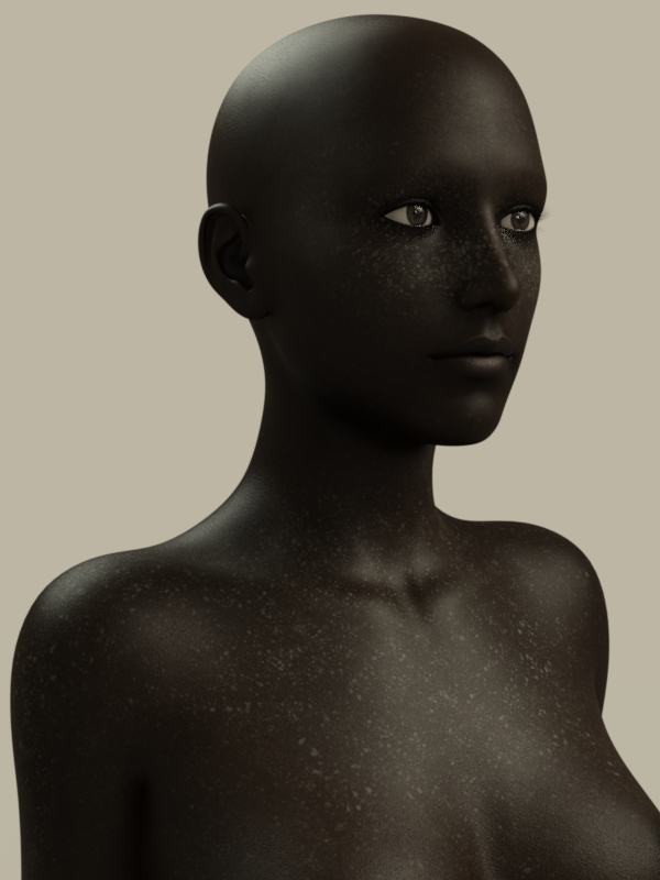

    There's a 'normal' blend option next to the 'multiplicative' option under the ColorBlend tab. I really wish there was a 'glossy' slider too, so that we could make wet mud and blood, but I do understand why Zev0 wanted to restrict the potential unintended effects and mistakes users might make, especially having seen the questions in this thread alone that have been repeated - customer support must range from monotonous to nightmarish at times. Anyway, I've tried the ColorBlend technique for lighter coloured freckles and it does work, although you might want to apply the effect twice if you're looking for something a bit more extreme. I seem to be somehow pushed for time this week while still managing to achieve absolutely nothing, so this is just a really quick render showing the newly created option applied once, in white, at 100% visibility using the 'normal' blend and lit with Painter's Lights.
    600 x 800 - 409K
