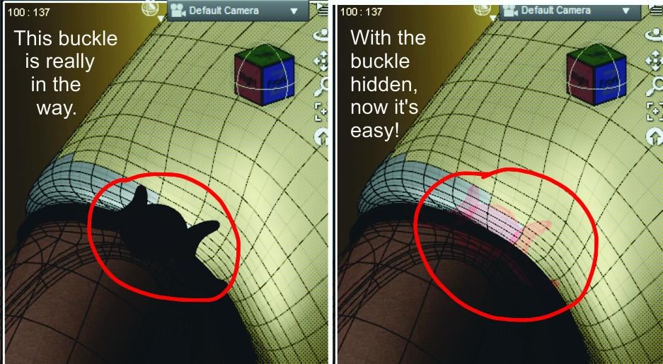

    1. Get your figure posed.
    2. In the viewport, to the left of "default camera" is a dropdown. Select Wire Texture Shaded.
    3. This would be where you should hide the trim of the sleeve or anything else that is likely to be selected, so you don't do it by mistake- but I'll really show you WHY that's a good idea. So instead, go into your Tool Settings Pane, and click on Active Tool>Geometry Editor. At the top, for Selection Radius, try 5. It's better to go smaller, than larger.
    4. Right click in your viewport. (NOT ON ANYTHING. Get in the habit of clicking out "in the air." That way you don't accidentally select polygons if your fingers slip on the mouse.) For Selection Node, note the following:

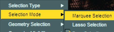

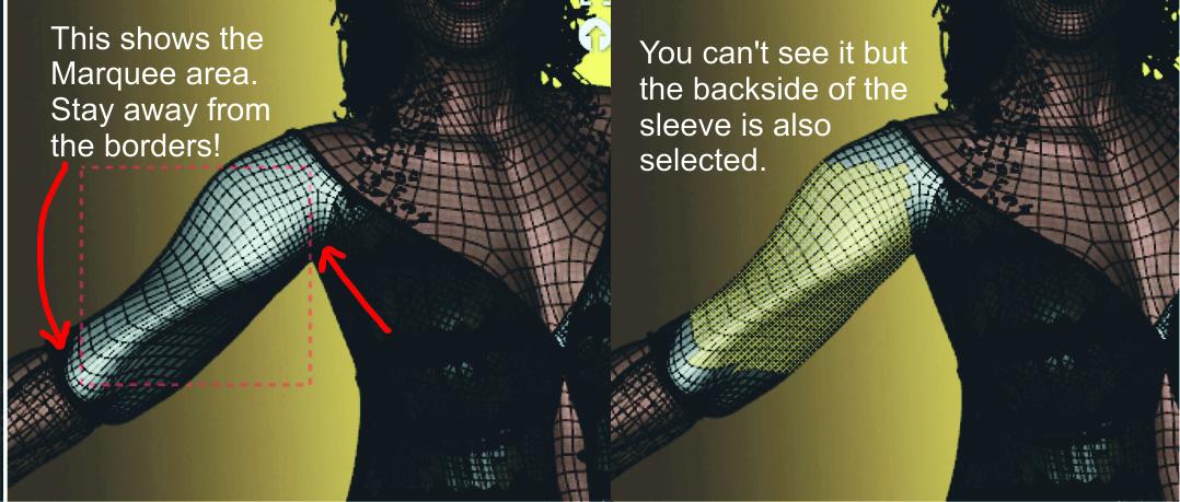

    Marquee and Lasso select polygons ALL THE WAY THROUGH. If you select those in the front, the backside is also selected.
    The only one that doesn't do that is Drag Selection. (not shown.) If you have your model posed so there's nothing behind it (like I told you!) or have hidden everything (using Geometry Editor) then you can speed things up with either the Marquee or Lasso.
    Using Marquee (which draws a square) click and hold your mouse and make a square in the middle of the sleeve- don't get near the trim/edges! This selected polygon surfaces in both the front and back of your sleeve.

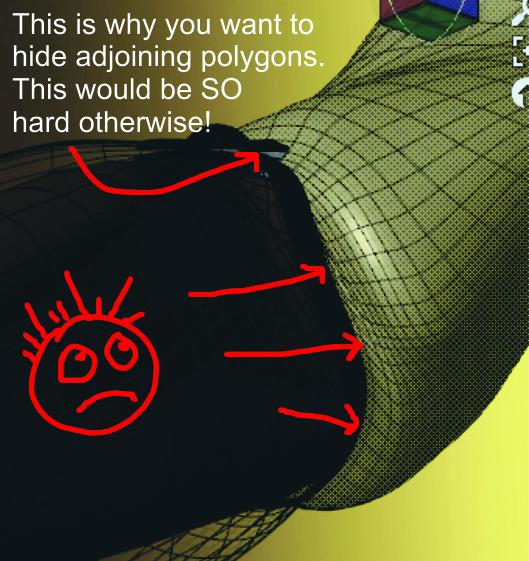

    5. And here is why you want to hide the trim/adjacent polygon surfaces, and anything else sticking up and in the way. UGH. Even zooming in, that's a nightmare to get those teeny, tiny, slanted polygons. So go up to your Surface Selection Tool (the three sheets of paper) and select it, then click on the doja-ma-floppy that is sticking up and blocking your efforts to get to the polygons. It will be highlighted in gold. (second image below)
    In the next post, I will tell you why you do that.

    The reason you want the doja-ma-floppy highlighted with the Surface Selection Tool is so you can see what the name of it is in the Surfaces pane. Then you'll know exactly what to hide. That doja-ma-floppy is a Sleeve Buckle.
    Shown: the Surfaces pane.

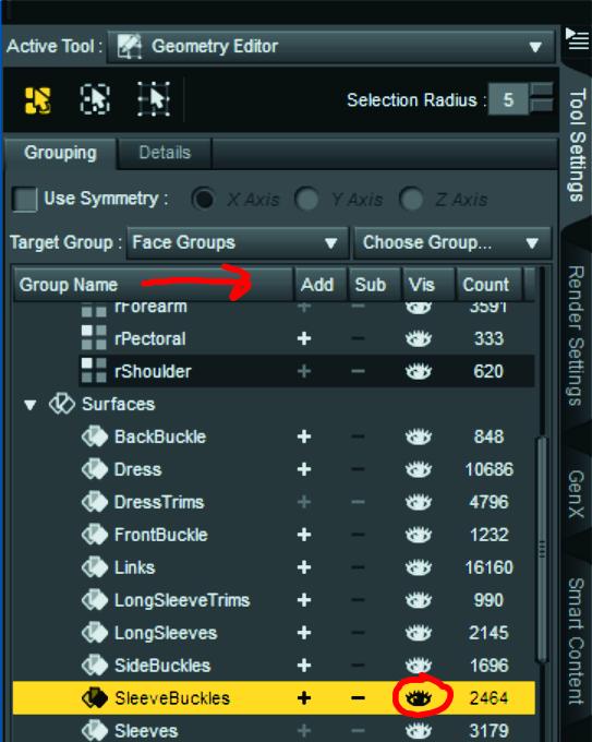

    6. Now we'll take that information and hide those polygons using the Geometry Editor. Go to Tool Settings and in the Geometry Editor, where it says Group Name, click on it and pull that column to the right so you can read any letters which are hidden. You'll probably see Face Group with items listed, then Surfaces and items listed. Shut the eye on your object (in this case, Sleeve Buckles.)
     Now, when you select polygon surfaces, these CAN NOT BE SELECTED. Remember my tip- closing the eye in Scene pane will NOT keep the polygon surfaces from being selected, you must do it in Geometry Editor.
    And this is what it looks like now. It's easy to select the polygons.
    Next, rinse and repeat for anything else you want to hide. (Click on it with the Surface Selection Tool, go to Surfaces pane and see what's it's called. Then go to Geometry Editor and close the eye there.) Show below is the trim hidden.

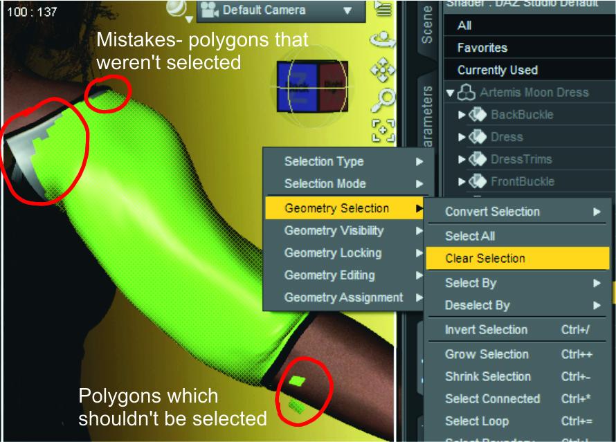

    I've deliberately messed up a few things and we are going to save the errors so you can see how easy it is to fix things. One thing you need to remember- polygon surfaces can only belong to one group, so if you accidentally select some, it's easy to reassign them. Another common error is to miss a few polygons- and again, it's easy to add them. So I've done both those things. Let's save our selected polygons and the errors. (I hate tutorials where everything goes smoothly- that's the best case scenario. You need to know how to fix errors.)

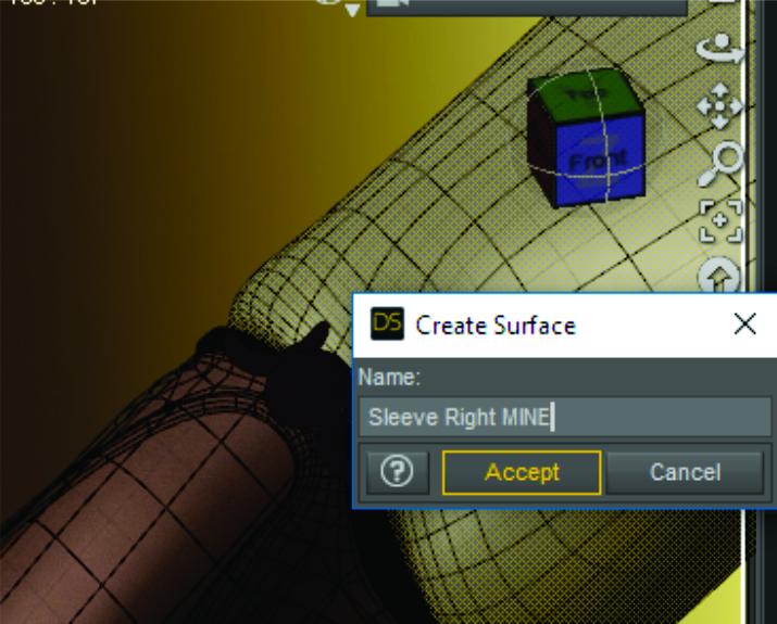

    8. Make sure your main object is still selected in Scene pane (in this case, the dress.) That way, when you create this surface, it will appear in Surfaces pane UNDER THAT OBJECT. (I want my sleeve material group to be under the dress, obviously.)
     While still in Geometry Editor, right click in the viewport. Geometry Assignment>Create Surfaces From Selected>a popup appears. Name your material group something unique. I chose "Sleeve Right Mine." Click Accept.

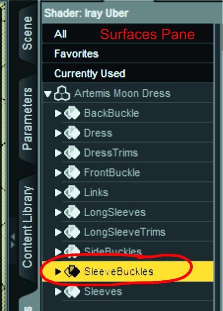

    So let's check the Surfaces pane and see if my material group is there under Dress (which I had selected in Scene pane when I made my material group.)  Yes, it is. (See below.)

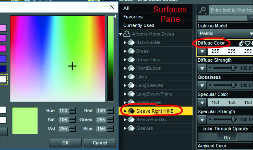

    9. Still in the Surfaces pane: With your new material group still selected:  In Diffuse, click on the color and when the color picking section comes up, choose a bright one. I did green. Now inspect your material group (for me, the sleeve) and see if you have missed any polygons, and look around to see if you accidentally selected polygons from elsewhere. (Remember, I did both.)
     10. To see it better,  you can get rid of those selected polygons.
    Out in viewport, right click Polygon Selection>Clear Selection. The yellow hatching covering your selected polygons will disappear. Now you can easily see there are polygon surfaces that were missed, and two which were selected from a hidden sleeve. Ask yourself- how could those be selected if they were hidden? (You should know the answer!  (Because they were hidden using SCENE and not Geometry Editor- and that's a no-no!)

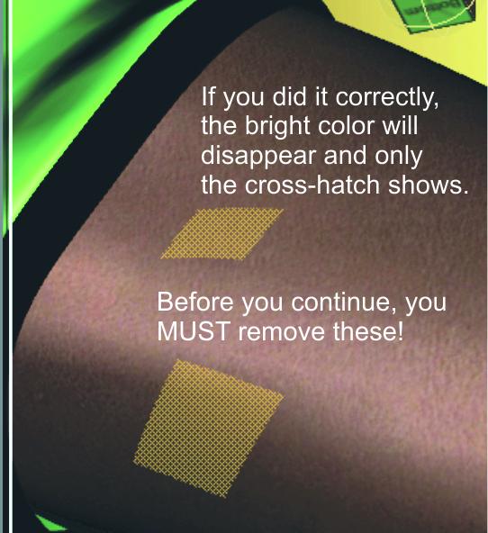

    Let's tackle those two "floating" polygons that were selected.  These are the steps you need to take to remove unwanted polygon surfaces:

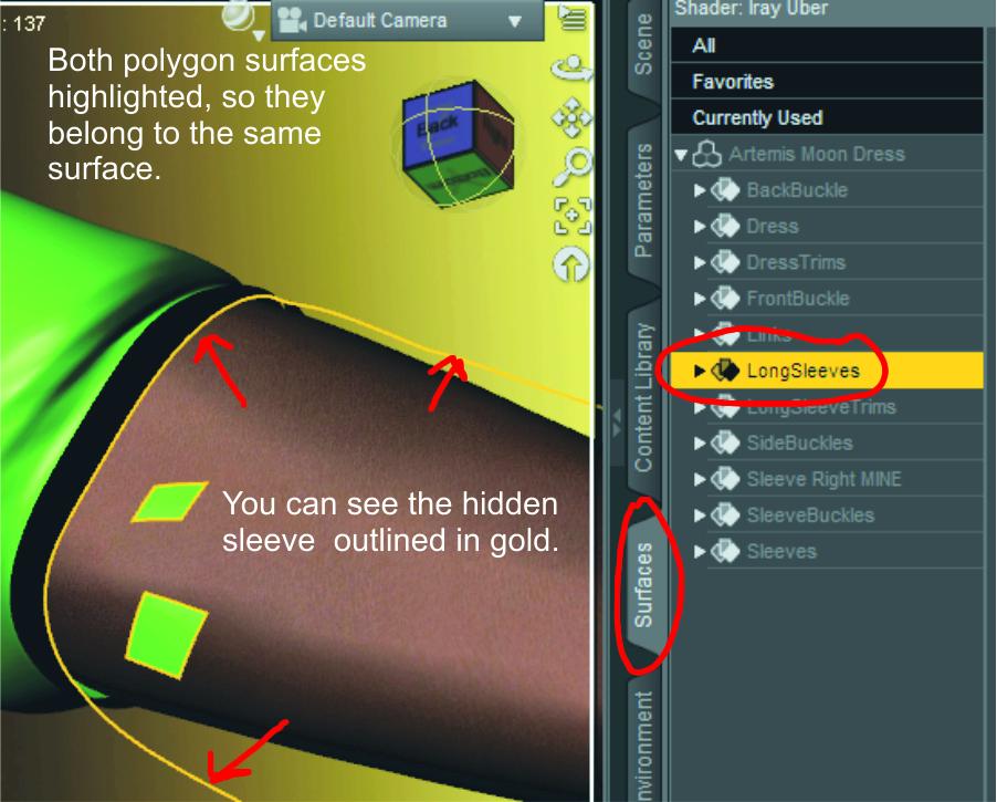

    11. First, we need to find out what material zone those polygons should be assigned to. Use your Surface Selection Tool (those three sheets of paper above the viewport) and click on one of the two polygons.
    Tip: You'll see they both get outlined in gold IF they are in the same material group. If one highlights and the other doesn't, you're dealing with two separate groups and you'll have to do this for each one. In my case, both squares highlight so they will be sent back to where they belong together. (Example- maybe one is part of the hidden trim, and the other one is part of the hidden sleeve. Again, this would be if you mistakenly used Scene pane to hide them, instead of the Geometry Editor.)
    12. You know the drill- next you go to Surfaces pane and see what surface group has these polygon surfaces. We've got two polygons from LongSleeves so now we're going to reassign them back. It's easy!
    13. Right click out in your viewport and select Geometry Assignment>Assign To Surface>LongSleeves. You don't want to create a surface, or create a surface from selected, because the surface already exists. These menus really make sense!
    14.  You will see your color disappear (mine was green) as the polygon surfaces go back to where they belong. They are, however, still selected, which will be a problem if you do not clear them.
    TIP: Remember polygon surfaces can only be assigned to one group. If we forget to clear these, they'll get added to the next group we do!
    15. Right click out in the viewport. Geometry Selection>Clear Selection. Your cross hatched polygons should disappear, and now they will stay put. See how easy that was?

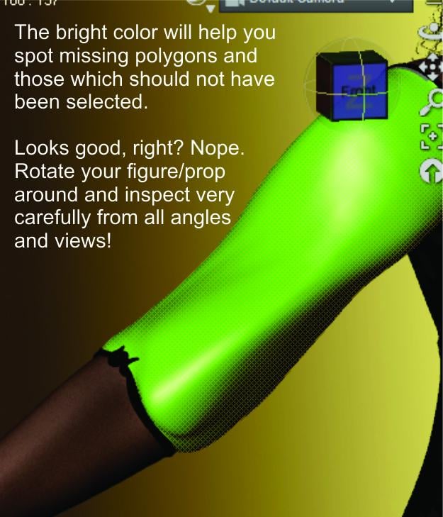

    18. We last had our Selection Mode as Drag Selection, leave it alone. (To check, right click out in viewport and look at Selection Mode.) You don't want polygons selected all the way through, we're fine tuning so we only want the surfaces we're dragging across.
    Carefully select the polygon surfaces, holding down your mouse. If you need to skip around, remember to hold CTRL+mouse. To deselect polygons, it's ALT+mouse. Rotate your viewport!
    Tip: You don't need to deselect polygon surfaces that you accidentally mouse over which belong to the sleeve we're adding these to. They already belong to the sleeve and won't go anywhere. I deliberately moused over some of them in the image below, and will just leave them where they are. (The forum is REALLY butchering these photos today. The yellow crosshatch is barely showing up. Can't do anything about it, the images are crystal clear.)

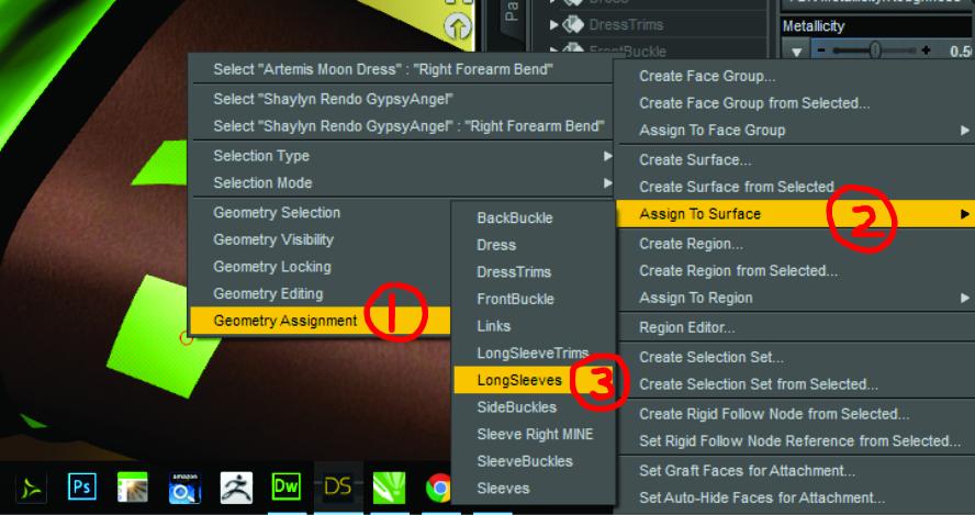

    19. Next, right click in the viewport. Geometry Assignment>Assign To Surface>Sleeve Right Mine (whatever you have named YOUR new surface material zone.)
    And poof! All those polygon surfaces turn whatever color you're using for your zone. (mine is green.)

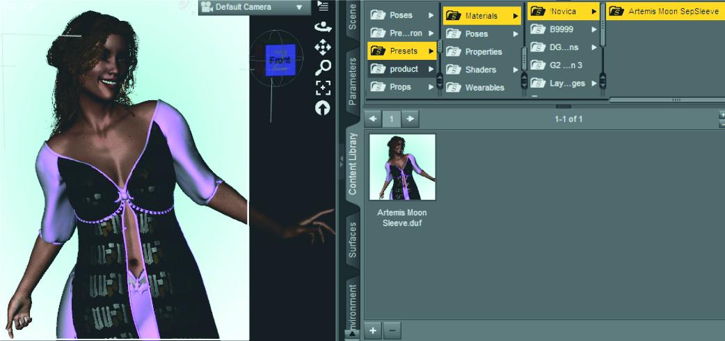

    First, when you save it, make sure the figure is posed and clothed appropriately in your viewport, because that is the screenshot the program will make.
    Second, make a file beforehand with so it's easy to put your preset into. I used the file path of Content>(all mine start with content)>Presets>Materials>!Novica>Artemis Moon Sleeve    In case you don't know it, the !  moves your file to the top of the list.
    Last, go up to File>Save As>Material Preset and make sure all the items are checkmarked which you want included, and browse to the folder you already created and put it there. You're done!

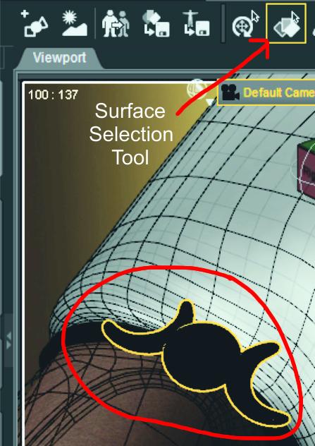

    However, get in the habit of using the Surface Selection Tool (the three sheets of paper above the viewport) by clicking on the tool, then clicking on the object in the scene. It will highlight it in gold, and also over in Scene IF IT IS LISTED. If the object isn't listed, the object it is associated with will be highlighted. Make it a habit to ensure the item is selected by the Surface Selection Tool AND in Scene.
    For example, if I click on the buttons out in the viewport with my Surface Selection Tool, there's none listed in the Scene pane, but the Dress will be highlighted in the Scene pane. When I go into Surfaces Pane, under the Dress, the Buttons ARE highlighted. Think of the Surfaces pane as being more nitpicky.
    TIP:  You'll need this later, in the tutorial. Clicking on an item with the Surface Selection Tool is a nifty way to find out what it's called in the Surface pane / what material group the polygon surfaces are assigned to.

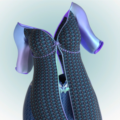

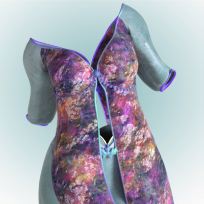

    Costume Jewelry Shaders for Iray
    Sleeves And Pants: Gemstones>#26
    Body:  Gemstones> #18
    Tiling on both: 1.0 default.
    Sleeves: Pearlescent>#14
    Pants: Gemstones>#11.
    Pants Tiling  60 / 60   (Horizontal/Vertical)
    Body: Gemstones>#6
    Tiling: 80 / 120
    While the original pattern is very swirly for both #11 and #6, when the tiling is increased significantly, it makes a very different pattern.
    400 x 400 - 261K

    Here's before and after using Book Of Spells. (the book on our right.)
    I used Ceramics for Iray for the hinges and the center, the Raku settings are so much fun!  The cover was Costume Jewelry Shaders for Iray number 18.  I first Uber Based both of these.
    TIP: remember to hold down CTRL when you are applying shaders if you want to keep the other details in the surface. A popup will ask if you want to Replace or Ignore, and choose Ignore.
    838 x 600 - 747K
    400 x 600 - 266K
