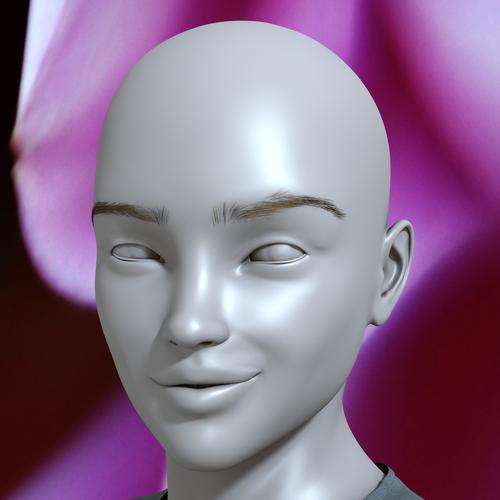

    Ok, So I rattled my head to improve things... I reduced the root width. I didn't use texture eyebrows, but I added a subtle false shadow in the eyebrows place on the face diffuse texture*, the idea is to help blend the skin of the face to the GH eyebrows, and I saw improvement.
    Here is comparison image of the first render (No eyebrows on texture) with The thinner hair roots, higher hair count and False texture shadow.
    *The false shadow on the face texture not only improved the render results, but it also gives reference to the exact location of the brows which aids you when shaping/posing the face of the character in the daz viewport.
    1850 x 925 - 752K
  • GoneGone Posts: 833
    Since eyebrows seem to be the topic of the day, I thought I would add some of my findings to the discussion.
    The eyebrow was done with a single hair node and is the same one used in all the images here. The distribution map was painted white for the thick part of the brow and 50% grey for the thinner sections. The hair uses the default root/tip settings.
    Eyebrow1 is the one I used on the simple hair style image. Since I knew it was going to be applied on top of an existing texture, I used a hair count of 100 and had the guide hairs raised slightly to give some more depth to the texture.
    With Eyebrow2, I used the surface attract tool to pull the guide hairs flush with the surface and upped the count to 200.
    Both brows have the resample and interpolation settings at 0.2. The rendered hair count for Eyebrow2 is just over 1100 with a vert count of around 5500.
    Eyebrow3 is the same as 2 with the resample and interpolation set back to the default 1. The vert count dropped to around 2200. The difference is subtle but quite noticeable if you flip back and forth between the 2. Aside from a slightly smoother look, the extra vert count appears to add to the shadow depth.
    I created the brow just before beta 12 came out and I didn't use the root angle tool so I'm sure there is plenty of room for improvement here.
    Anyway, I hope someone finds these ramblings helpful.

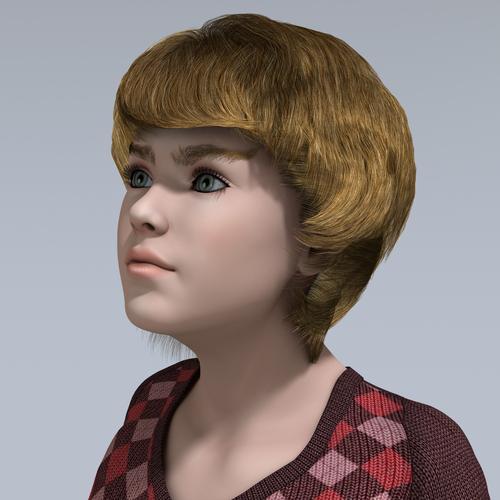

  • SpyroRueSpyroRue Posts: 5,020
    mjc1016 said:
    I'm wondering if it wouldn't be better to, for things like eyebrows, to actually take and paint the density maps in a paint program and then import them? You get much finer control of the gradient and blend.
    I do exactly that. In Photoshop. It's very accurate :)
    Interesting findings here! The extra vert count and resampling really makes a difference, the brows actually have depth about them.
    My latest attempts have lowered root widths a high hair count like 480/500 with interpolation widths at 56. I didn't try resampleing.
    Heres My recent improved Spyro's brows :)
    925 x 925 - 915K

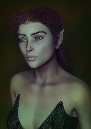

  • MangeyDesignerMangeyDesigner Posts: 129
    Eyebrows are so difficult to get looking right... lots more work playing with them for me I think.
    here is my first effort
    1393 x 1970 - 211K
  • KeryaKerya Posts: 10,943
    She looks lovely. I think a bit less density ... The form looks right to me.

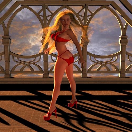

  • foleyprofoleypro Posts: 457
    Pinup 2...
    Playing with the shader and Light and shadow...tried to save new scene and DS4.5 crashed to desktop...Still have original scene...
    1024 x 1024 - 628K
    Nice work foley! I like the light passing through the hair. Very interesting :) The translucency/SSS is very effective in that shot.
    No new hair here - just a boring story.
    Both the hair and eyebrows (yes, I know they are not normal but that was the point :-)) are saved as wearable presets. I fired up DS and spent a lazy 10 minutes setting up the scene. Loaded a default Genesis, spun up a character, loaded textures, pose, clothes, lighting..... and the hair and eyebrows - just like any other prop.
    Since I intended to use them with their default settings I didn't even bother to open Garibaldi - just hit render.
    And that's how easy it can be.
    1200 x 1200 - 337K
    Well done man! I need to give wearable assets a go soon. Ive never saved anything as such before.
  • DaremoK3DaremoK3 Posts: 798

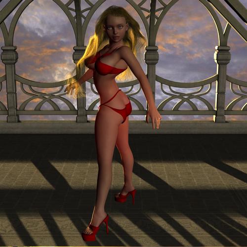

    Same scene Longer Hair tweaks on Hair shader and lighting...Saved as scene fine now
    1024 x 1024 - 723K
