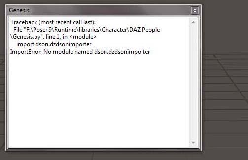

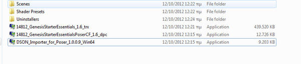

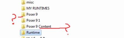

    OK. I'm still error message. What am I doing wrong.
    Did you install both the GSE Core and the GSE Poser Companion Files? What is the full install path?
    Yes I put both in Poser. F:Poser 9
    Ok. Which one do I put items in? Poser 9 or Poser 9 Content? Also, do I use 32 bit or 64 bit?
    The importer plugin should go wherever your other Python scripts are. The other two can go in any mapped content directory (install to the folder containing the Runtime folder).
    Ok. Which one do I put items in? Poser 9 or Poser 9 Content? Also, do I use 32 bit or 64 bit?Poser 9 means you need 32 bit.

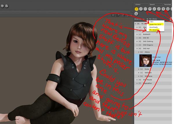

    As for where to put the content, that depends, where is your content for Poser normally kept?

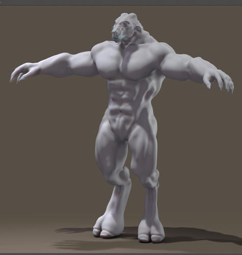

  • Midnight_storiesMidnight_stories Posts: 4,112
    Good thing I'm seeing is the JCMs for the Sabbatic Goat get pulled over to.
    The easiest way I found to get it working is setup a new runtime folded in Poser 2012 and direct it to the DAZ3D My Lids Content runtime folder and load genesis from there it finds all the paths. But I guess someone has all ready said that.

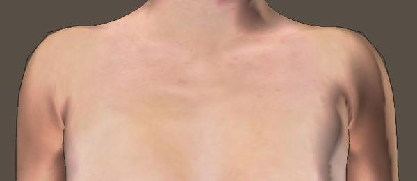

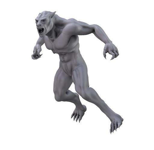

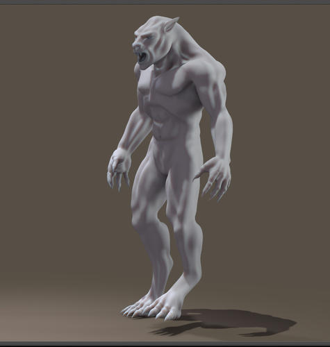

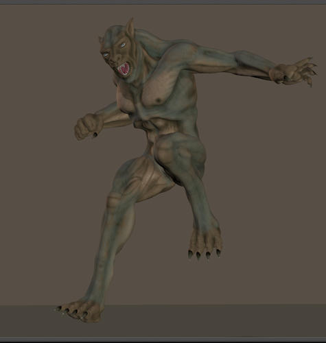

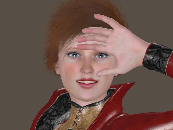

    Sunfire said:
    I need my werewolf... that would be Lycan...
    Yes the Lycan is working and the JCMs working on that to. Next I need to start working on the Mat presets export and get that working in Poser to.
    805 x 847 - 100K

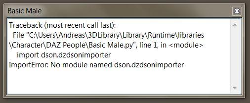

    ok--I've done a fresh install of Poser 9, ran the SR3 update, installed both genesis essential files, and the 32bit DSON importer.
    I an running windows 7, 64 bit...
    I get the dll failed to load (similar to what others are seeing) on the start up of Poser:
    An errror occurred importing addon dson :
    ERROR: DLL load failed: The specified module could not be found.
    and these types of messages when I try to run the Scripts:
    Traceback (most recent call last):
    File "H:\Poser 9\Runtime\Python\poserScripts\ScriptsMenu\DSON Support\Importer Preferences....py", line 2, in
    import dson;
    File "H:\Poser 9\Runtime\Python\addons\dson\__init__.py", line 3, in
    import dson.dzdsonimporter
    ImportError: DLL load failed: The specified module could not be found.
    I had the same problem with the Aniblock Importer for Poser, but was not able to resolve it.
    My Poser 9 is not installed in my Program Files...I installed to a seperate location, but installed everything in the same folder (ie H:/Poser 9)
    Is everyone having this problem running Windows 7, 64bit?

  • griffon_e3f1dc9370griffon_e3f1dc9370 Posts: 224
    Oh *BIG HUG* I really like Lycan, but I like my ability to light scenes better in Poser. Which means I'll be able to light him even better once I get him in Poser.
    import dson;
    Even though you have a 64 bit machine. Poser 9 is 32 Bit. You need to install the 32 bit version;
    import dson;
    Can you do the following.
    Launch the python shell (Scripts > Python Shell)
    Then type: "sys.path" and hit enter
    It will print out a list of paths. Is the "dzdsonimporter.pyd" file located in one of the printed paths?
    Post edited by ketthrove on

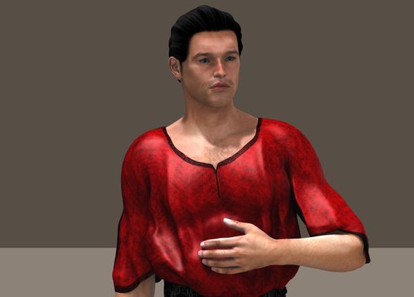

    Sunfire said:
    OK we have lift off with the scripts but they only pull over the diffuse color nothing else so that means the rest of the poser stuff like Disp Bump and Spec are going to have be done manually.
    805 x 847 - 91K

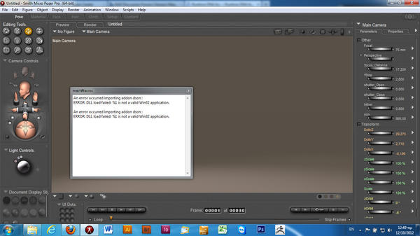

    Go Figure said:
    Very cool stuff DAZ
    Gregorius said:
    I keep getting this "mainWacros" window when I open PP12 SR3:
    ERROR: DLL load failed: %1 is not a valid Win32 application.
    Plus, I've installed the Starter content, but there's nothing new in my library yet.
    Any ideas? I'm looking forward to toying around with Genesis in Poser!
    For those that are getting these dll load failed errors, but are sure they installed right, I think you may want to install one or both of the following and report if it fixes it for you for the benefit of all:
    - http://www.microsoft.com/en-us/download/details.aspx?id=8328
    - http://www.microsoft.com/en-us/download/details.aspx?id=13523
    Am testing this... seems to load without error after updating. Thank you for the tip. Haven't yet tried the dson script, bu no error at load on a Win 7 64 bit machine after doing this... Thanks again :) Crosses fingers that the script works.
  • Salem2007Salem2007 Posts: 513
    ketthrove said:
    import dson;
    "dzdsonimporter.pyd" is not listed in the list, but I can confirm I have at this location:
    H:\Poser 9\Runtime\Python\addons\dson\dzdsonimporter.pyd
    There is one path that reads "H:\Poser 9\Runtime\Python\addons\" but no path that ends directly at "H:\Poser 9\Runtime\Python\addons\dson\"

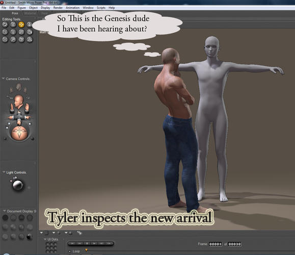

  • NetherworksNetherworks Posts: 34
    *sigh*
    I'm in the group that has an invisible Genesis.
    I'm on Windows 7 64 bit. Everything is outside of Program Files and any protected system folders. In fact, Poser Pro 2012 and all my Runtimes are on a completely different partition.
    I downloaded and installed the 64-bit DSON Importer for Poser Win 64.
    I installed the Genesis Starter Essentials Poser in a new Runtime, which I added to Poser Pro 2012 (D:\Content\Genesis)
    I installed the Genesis Starter Essentials to D\Content\Genesis and de-selected install DAZ Studio files.
    But I am noticing that now I have folders all over the place under D:\Content\Genesis.
    Am I just not doing something right?
    Lucky you. Out of desperation I tried both of them. Neither solved the problem for me, and I have the same system you have (Windows 7, 64-bit).
    Should I try deleting older versions of the Visual C++ Redistributable perhaps?
    import dson;
    Ok. I was having the same problem. I have Windows 7, 64 bit. I used the 32 bit for Poser 9. I have it on an external hard drive. I have the Poser 9 folder. Then there is the Poser 9 Content folder. I put the DSON Importer for Poser in the Poser 9 folder. The others I put in the Poser 9 Content folder. Now it works.

    *sigh*
    No just make a new runtime in Poser Pro 2012 and direct it the the runtime in the Daz content folder make sure you installed the 14812_GenesisStarterEssentialsPoserCF_1.6_dpc there to
