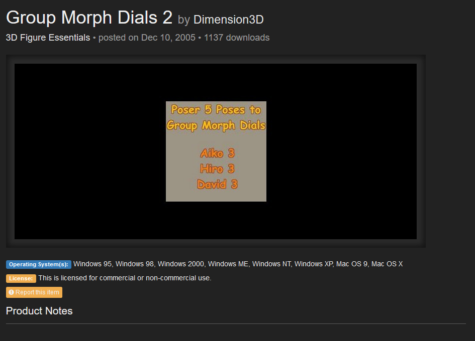

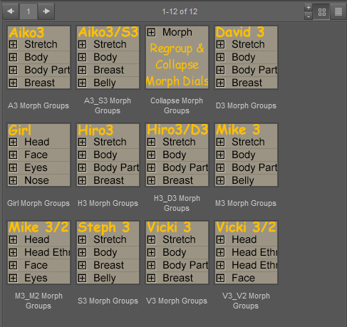

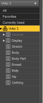

    Something that will help tremendously with the Aiko morphs before converting to Triax: https://www.renderosity.com/freestuff/items/31148/group-morph-dials-2
    It's nearly 20 years old, but it's still there and more importantly, it works in DS 4.22!, grouping the morphs. They work aftrwards, even after changing the rigging to Triax (just tested, as I wasn't sure).

    It's a series of poses that groups the poses of Aiko 3, Hiro 3, Stephanie Petite and David 3 in a similar way how to V4 and M4 morphs ar grouped. There is another one that does the same with Vicky 3, Mike 3, Freak 3 and The Girl.
  • A_C_CA_C_C Posts: 21
    edited November 2023
    If needs to, I can make a mini-tutorial to show how it is done.
