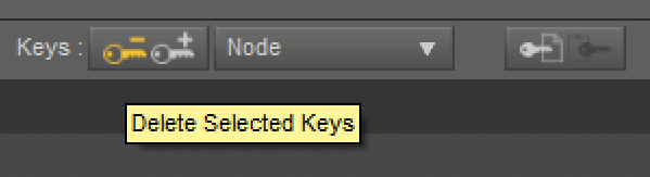

    Where is she at at beginning pose? does she collide with the chair at any point in the timeline? it looks like it happened
  • FeralFeyFeralFey Posts: 3,948
    edited April 2022
    Hi, evacyn! I just saw you had written in the other thread. And now I can address the issues you're having.
    When you applied your pose, did you first clear the animation timeline? If you did and you still see little triangles along the timeline, you'll need to remove those by selecting them and then clearing them by pressing the "remove keyframe" button on the bottom of the timeline. (I'm getting together an image for you.) It looks to me like the Squishy Human female has been previously simulated and might be retaining simulations on the armatures from a previous pose. I've found that sometimes when you clear the figure's pose from the timeline, it doesn't always clear the armatures, so those will need to be removed.
    Once those are all cleared off, try applying your pose again, both at frames 0 and 15. At frame zero, see where the figure sits in relationship to the chair seat. Check to see how much "squish" you expect to have at the end of the simulation. Adjust the hip level up or down to where you want it (but do this on the 15th frame and not the 0 frame.) Then back on the zero frame move the figure up on the Y axis on the hip bone so that it's just above the chair seat. See if that doesn't give you a better result.

  • evacynevacyn Posts: 993
    Thank you so much, FeralFey - that was the trick. I had the timeline set up so that it was base pose at 0 and the actual sitting pose at 15. But adding the sitting pose to both 0 and 15 fixed the issue :) I'll post a proper image once I get something rendered.

    @3DRT - When this happened, was it the first pose you applied to the figure? Or was this after you tried a different pose? To my eye, it looks like you have simulated it previously and all the armature's posing/simulating haven't been cleared from the timeline from the last pose. But if this was the first pose you used, let me know and we'll try to sort out what's going on for you.
