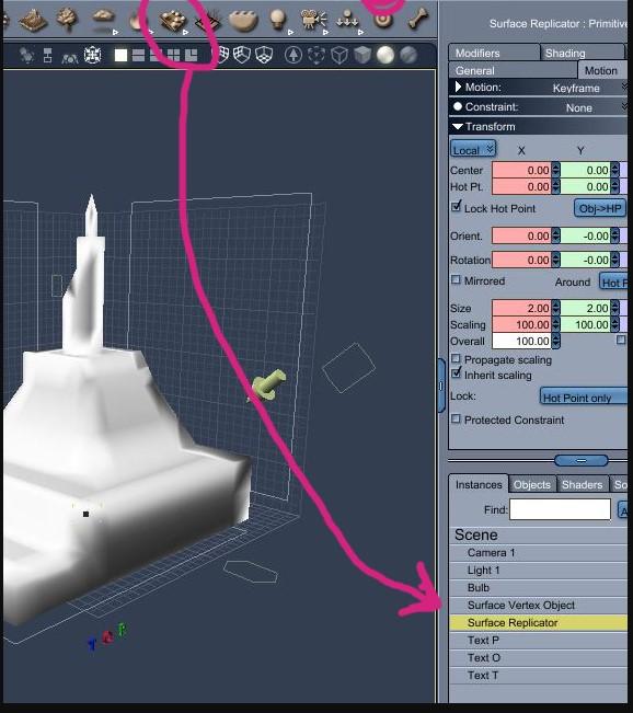

    I also am not very familiar with Carrara's replicators, although I intend to investigate any day now.  But I do see "Instances" in the interface (attached), not sure if this is the same as DS.
    900 x 506 - 87K
  • DiomedeDiomede Posts: 15,470
    edited May 2020
    Good eyes, Steve K.

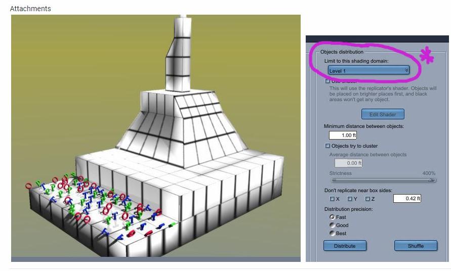

    Related.  But in this conversation, instancing or replicating refers to taking a single object instance in a scene and portraying additional (instances/replications) of it without adding it to the scene a second or third time.  Therefore, it helps reduce the resource load of the scene.  That was probably more complicated instead of less complicated.  Therefore, I point you to this short 2-page thread. It gives an example of 'copying' three letters (T, O, P) on top of another object.
    https://www.daz3d.com/forums/discussion/38177/how-to-replicators-introductory-methods-tricks-and-advanced-tips/p1
     You should be able to skim the thread quickly and see what is going on if you are not really interested in building giant cattle herds or forests at this time.  I think it will be helpful.  It explains the Carrara method of controlled replication.  The Daz Studio method of controlled instancing works very similarly, especially with Ultrascatter by Howie Farkes.
    578 x 651 - 88K
    891 x 536 - 89K
