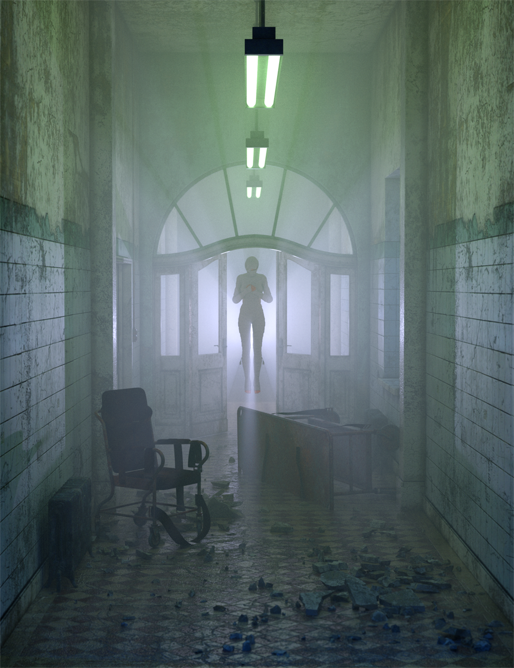

We're proud to announce today's release of Atmocam2
Achieve depth, haze, fog, divine rays of light, supernatural moods, alien atmospheres, and several weather conditions with this prop-based set. Included are 12 colors, 6 density levels, and 10 texture effects. This new version of the Atmocam has updated material settings and is much easier to use (scale, adjust density, etc.)
Please post any questions here and renders if you feel inspired. SO many promos were created for this set, too many to include on the store page. Here are a few of them. Let me know if you have questions about any of them, if you want to reproduce any of the effects, I'm happy to share details.
As far as general instructions go we have included them in the promos and the store page.
1000 x 1300 - 2M
Post edited by Marshian on

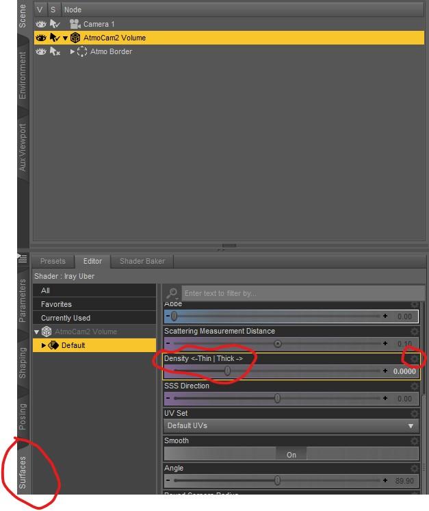

    I'd be interested in knowing a bit about how you set up the second to last promo in the store, the one with the top-down view of the city. This is an effect I've tried to get with AtmoCam and Fog Camera with mixed results, though I think that has come down to lighting having too much ambient light in many cases. Is this a distant light, or can you get this effect with the sun/sky light?
  • MarshianMarshian Posts: 1,465
    edited April 2019
     Hi AlmightyQUEST. The environment mode is dome/scene with no other lighting. Attached below are the specifics. The rest of the set up is scaling the prop. Let me know how this goes for you or if you have more questions. Edit/Add: I've also attached a wide angle render of the Atmocam2 prop with City. Note the ground is black, this helps cut down on ambient light, keeps the rays sharper.
    295 x 568 - 38K
    1300 x 731 - 529K

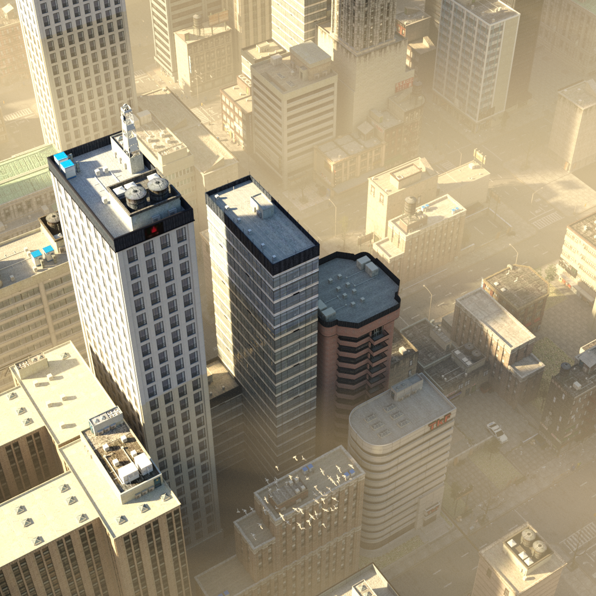

  • AlmightyQUESTAlmightyQUEST Posts: 2,006
    Thanks for that, based on what you said I picked this up, and my first test was similar to what you showed here, and a lot more like what I was hoping to get than some of my attempts with some of the earlier products. And the tip about setting the ground to black helped, it seems obvious now that you explained it smiley . I only had time for a few quick tests, but hope to have a proper render in the next few days. It rendered quicker than I expected too, which is nice!
    edited April 2019
    This was still just a test, now I will need to come up with some proper scenes that have a high, top down city view as an excuse to use this more smiley . I just want to stress how easy and quick this was to set up and tweak to get the look I wanted.
    Atmocam 2 Smog
    Click for full size.
    1200 x 1200 - 2M
    Post edited by AlmightyQUEST on

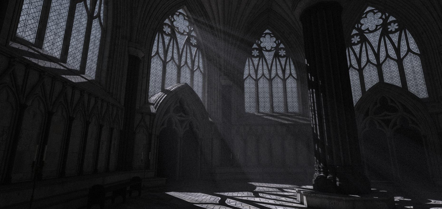

    Marshian said:
    Just picked up Atmocam2, and would like to know how you created the God Rays here, and the multiple ones  in your promo with Sacrament. Do you recommend that the spotlight be positioned inside the Volume, or behind it? Also, when you refer to scaling, is it meant for the Volume, or the Border group? Thanks!
    edited April 2019
    Hi dawnblade. For both of those promos the Atmocam2 prop was scaled just a bit larger than the main scene area and the spotlight (geometry set to point) was just outside the Atmocam sphere. The actual rays are solely from the sharp light passing through leaves or the window (for Sacrament). I'm rendering right now so I cant open up these scenes and confirm this but my memory is that to get sharp clear rays that fan out the light needs to be fairly close with a wide spread angle. Keeping the atmocam prop fairly small and the light outside it means that the light isnt diffused before it hits objects making the rays. Make sense?
    The volume and the red rig/border group are parented so they scale together, yes it is meant for the volume when I mentioned scaling.
    The color in the rays for the Sacrament promo is kind of complicated to get but the sharpness can be achieved pretty easily.
    Let me know if you have more questions.

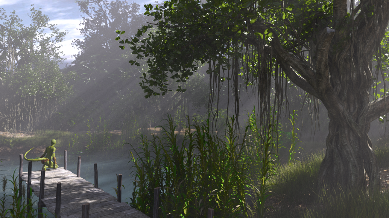

    Really enjoying the effects!
    1920 x 1080 - 282K
    Awesome! You've shown how the sun can shine through and still light the scene.Thanks for posting Oso3D

    Thanks for the info, Marshian. Here is a quick test with Chapter House. I used your render settings, scaled the prop, and used one spotlight outside the window, and I got rays coming through the window! I only got light with just the spotlight and no prop, but after I added Atmocam2 the rays were visible. smiley
    1860 x 881 - 1M
