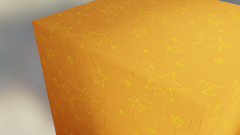

    Okay, some more comparisons. This is a cropped version of a scene I'm working on at the moment, and part of the reason I'm using it as a test is because it's seriously slow to render on my machine (about 200 samples an hour).
    No Denoising
    Intel Denoising, No Albedo
    Intel Denoising, OpenGL Albedo
    Intel Denosing, 3Delight Albedo
    As you can see, at 256 Iray samples (I like to work in binary for my test renders), it's really very noisy and could take days to render on its own.
    We've then got a sample fed through the IntelOI Denoiser (which I personally preferred), which is really struggling to tell the difference between detail and noise.
    I've then given the denoiser an OpenGL render with flat shaders to emulate an albedo pass. Detail retention is considerably improved, but because OpenGL won't do depth of field and doesn't handle transparency brilliantly, we're getting some really weird ghosts in the background where the albedo is telling the denoiser that things should be sharper than they actually are.
    Final attempt is with a script I've bodged together to convert Iray shaders to flat 3Delight shaders. This is the most time consuming method, as rendering the 3Delight scene to a high enough quality (2400x2400 pixels @ 16x16 samples on my middling GTX 1050 Ti) took about 16 minutes, but due to advantages like 3Delight being able to match Iray's DoF settings, it does avoid inserting the weird artefacts of the OpenGL albedo.
    There's still some noise the denoiser hasn't dealt with, particularly in the water droplets, but it's pulled back a lot of detail even a human might struggle to see in the original image.
    So far, this is all without a Normal AOV, because I never rendered one in the first place, but it does still demonstrate it is possible to get the avantages of the Albedo AOV, even if Iray refuses to provide one itself.
    I can't supply the script yet, as it's still a bit rough around the edges (and I should really seek permission from the person whose freebie Iray -> 3DL shader I cannibalised), but hopefully I'll be able to provide it sometime soon.

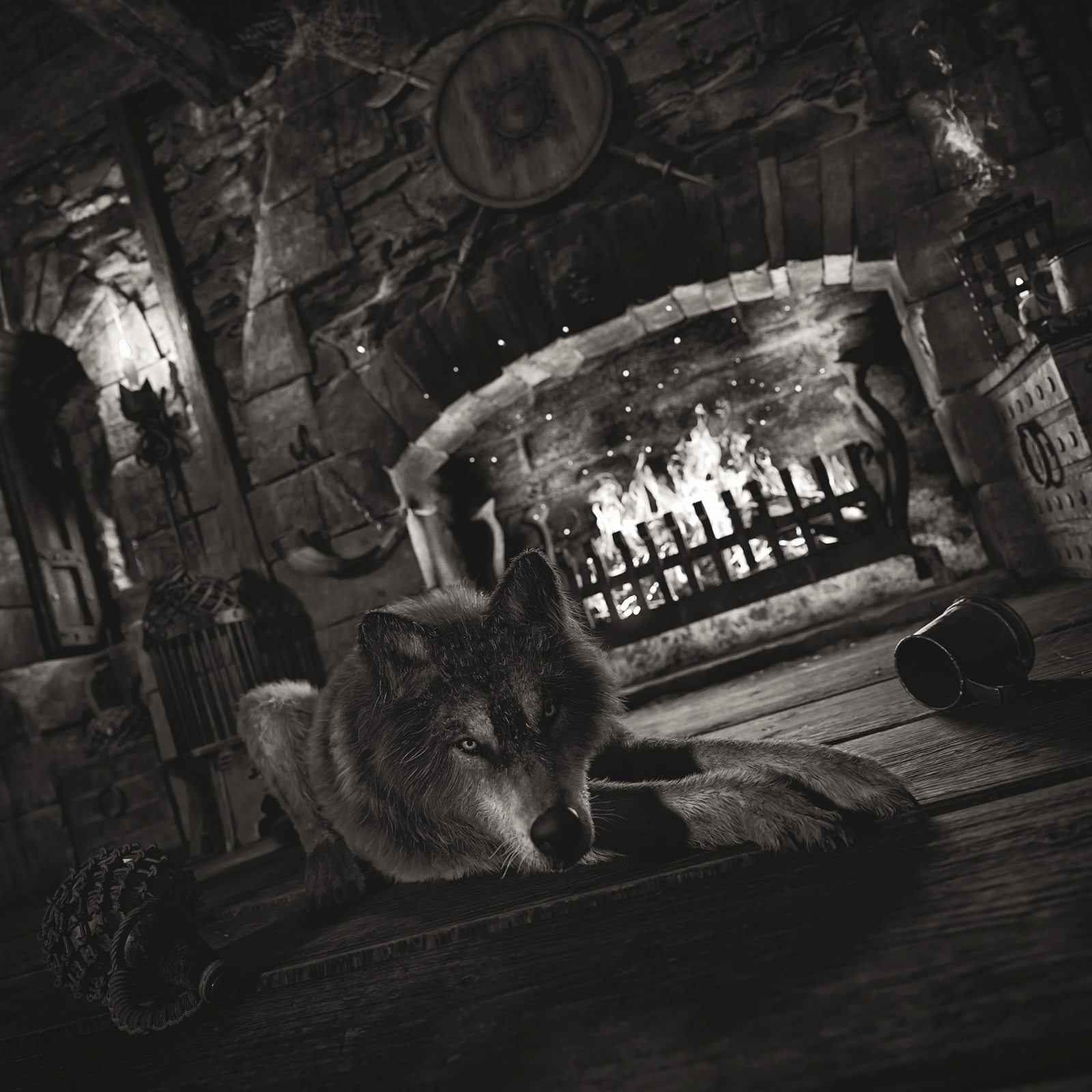

  • algovincianalgovincian Posts: 2,696
    Been lucky enough to play with @Strangefate and @Roguey's new Medieval Bedroom set the past few days, and in the process started to understand the denoiser a bit better. The fur on the wolf, along with the depth of field and an extremely detailed environment were challenging. It's great that it works on 32-bit canvases, and in the end, I was pleased with the results:
    - Greg
    Here's a before/after denoiser comparison:
    Definitely saved a bunch of time.
    - Greg

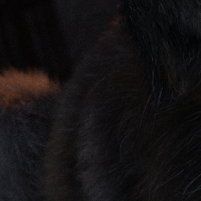

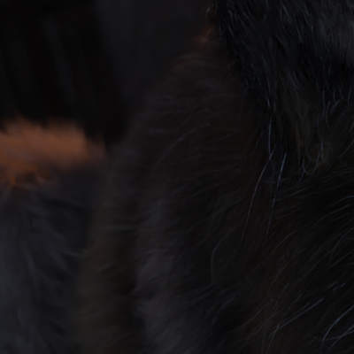

    On the note of the built-in denoiser, I'm personally entirely ignoring it in favour of these standalone options; Processing the render afterwards is a non-destructive process that makes it possible to layer and mask the results in Photoshop. This is particularly powerful if you feed the denoiser different combinations of input canvases to have multiple layers to play with.
    This was a test of that theory - and while I'll admit the subject matter is rather strange, I deliberately wanted to use 1) a demanding interior set lit via a single window and 2) a subject which had challenging contours. Given my normal style is "paranormality", you get a zombie getting dressed.
    This was rendered for only 2000 samples, which would normally be woefully inadequate for an internal scene lit through one partially-shuttered window, even without the main subject having challenging detail; it was about at the point where you could mostly make out fine detail under the noise, but still only a small fraction of the samples that would be needed to get a clean result.
    However, after applying the Denoiser (in three combinations - Beauty only, Beauty & Albedo, and all three of Beauty, Albedo and Normal) and masking the results to get the best possible compromises between noise and detail, the final results are actually surprisingly acceptable.
    Would it have still benefitted from more render time in the first place? Of course, and that probably would have sharpened a few of the details up more, but for something I did on middling hardware in only a couple of hours, it's still pretty good.
