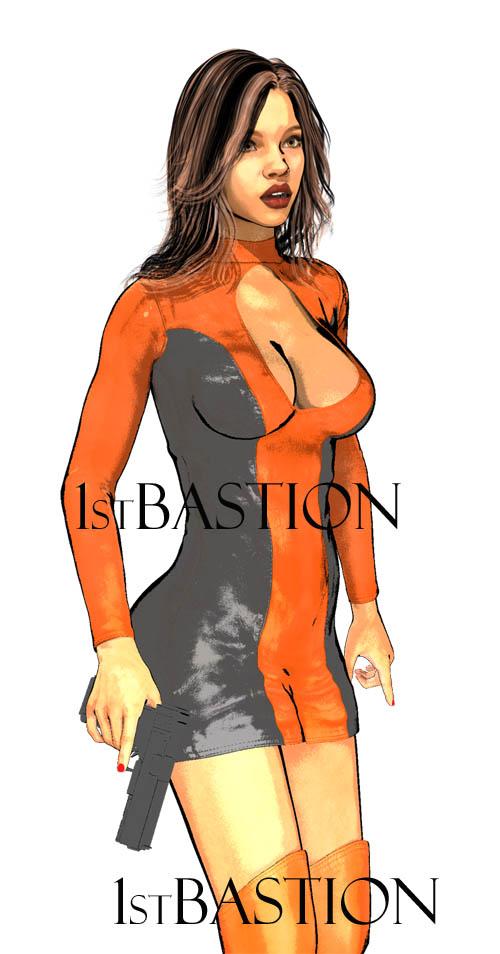

    Keep in mind that "comic book" can fall into a lot of different styles, but you can achieve some decent results without buying anything.
    This is a real quick image that I threw together as an example. No special renderers used.
    Rendered one time using the Beauty Canvas. Took that Canvas into Photoshop (but I believe Gimp can do all of this). Worked on the exposure settings to get the "night" levels right.
    Made four layers with it.
    Bottom layer, black and white.
    Next layer, over saturated color. Set this to a Luminsity overlay.
    Next layer, black and white, find edges, inverted. Set this to a Divide overlay.
    Top layer, Guassian blur.
    Then worked with the layers opacities until it approximated what it should look like.
    The main thing is to visualize the style you want to get to, then think about how to get there. The colors for most comics are going to be uniform shades, so you need to blur your color levels to get there. The edges will be pronounced, which is what a good black and white / find edges accomplishes.
    After all is said and done, it doesn't hurt to add some last flourishes manually. To accent the image and make the drawing look more authentic.

  • Jason GalterioJason Galterio Posts: 2,562
    edited December 2021
    Very nice. I have found skin to be the hardest part to get right in a comic render.
    I don't think I explained my layer reasoning properly, my apologies. It was after work and I was mentally exhausted.
    First, I use Iray because I am used to it 3DL renders will work almost exactly the same. I like to use the Canvas-Beauty canvas because I can fiddle with the overall lighting after the fact. I just have to be sure of the balance of the different lights in the scene.
    Layer One - Bottom
    This is a black and white layer. Think of this as the inked pages. No color yet. Its the base that all the other layers work off. Almost like what would be done in a real setting. This is where fancy things like shading and styling, removing details, can be fun.
    Layer Two - One up from Bottom
    This is an over saturated color layer. Make this layer by working with the color levels and upping the saturation. Essentially its a color "beyond" what reality would look like. Used for the color highlights.
    Layer Three - Two up from Bottom
    This is a black and white layer, that gets inverted, and use the Find Edges filter on. This is meant to make the edges of the objects more pronounced, like they would be in an actual drawing. That's why it goes "over" the saturated colors.
    Layer Four - "Top"
    This is another, almost standard, color layer. Applying a Gaussian (or other blur) will smooth out color details that the render creates.This makes a more uniform color with only minor gradients.
    Blending
    This is where most of the experimentation will come in and why this is all done in layers. Try different blending styles; sometimes Darken will work best, other times Overlay will. The only hard rule is with the "Find Edges" layer. This needs to use something that will make the Edges stay pronounced.
    Lastly the Opacity level will control how much of each layer appears.
    Playing with each of these can create some very effective interactions.
    Extra Credit
    Beyond the basics there are things like selectively erasing parts of the image on only certain layers. Like having just the character in color and the background black and white outline. Blurring the Find Edges layer to give the border lines a more rushed look or to create motion.
    If working with skin, it doesn't hurt to apply a base color without any texture details, particularly for distant figures. A comic book is generally not going to include pores and freckles if the character is not in a close up pose.
    Last Thoughts
    The only reason I frown on fancy tools, plug ins, and renders is because every picture is different. No one method is going to work like magic for every image rendered.
    However, if you take the process in steps, understanding why you are doing each, then you will know how to compensate for the differences. In the process you will create your own "drawing style" which is essential if you are creating a sequence of comic images. You want them all to look like they were drawn by the same person, giving a consistency to the overall project.
    Not to disparage the extra tools, but using them will make it harder to create your own "look."
