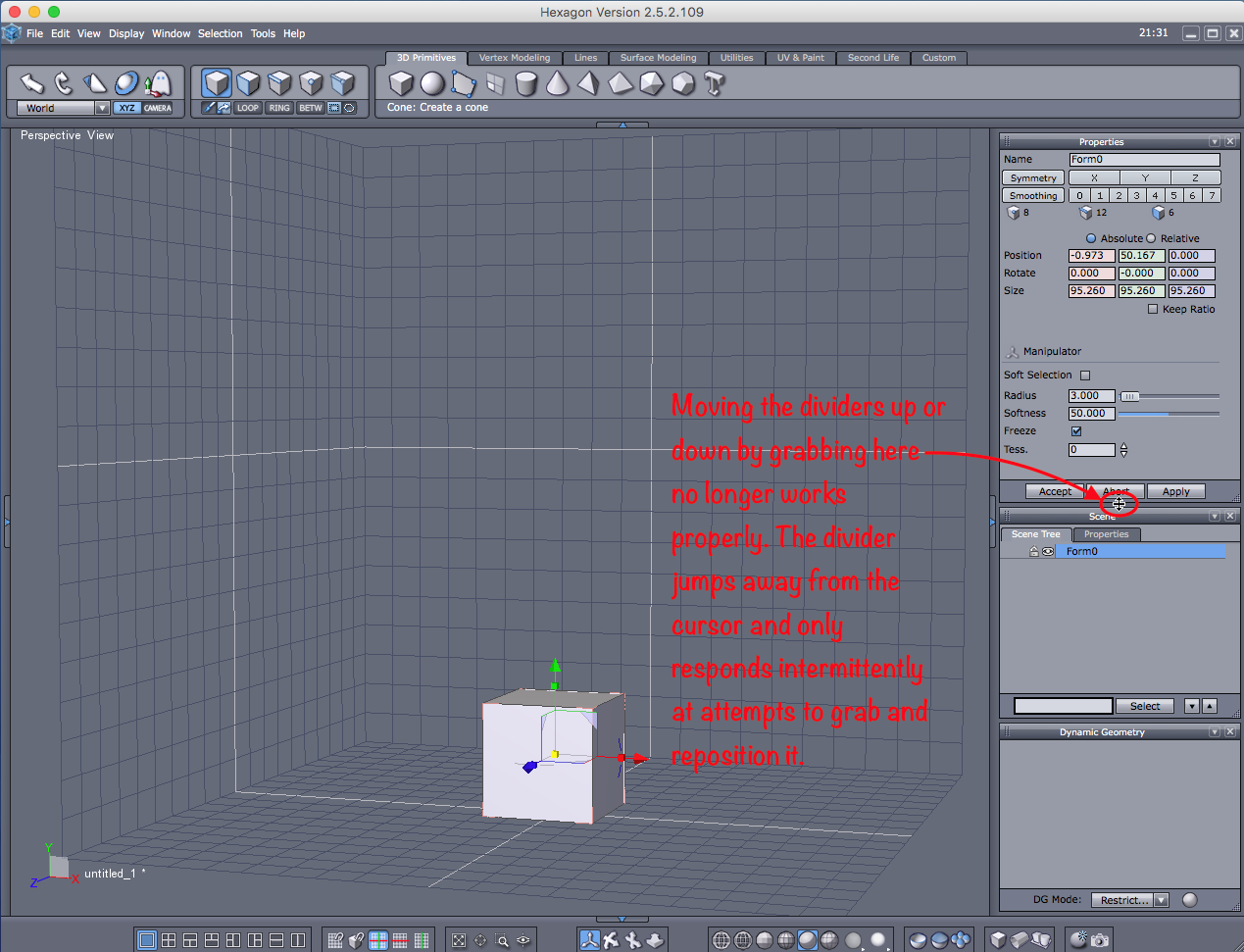

    Anyone else having trouble moving the dividers that separate the preference panes? (See the image)
    They worked properly in the old 2.5.1.79 version.
    1269 x 971 - 285K

  • Yes, I can confirm (on Mac version) that it snaps to the bottom.  However, it's not too hard to reposition it back to the top. It's just little buggy.

  • Just tried this and its doing the same thing for me - Windows 10.
  • de3ande3an Posts: 915
    Thanks for the feedback. Apparently this happens in both Windows and Mac versions.
    I'm using the Mac Version, and for me it's extremely hard to reposition the divider. Sometimes it works within two or three attempts, and sometimes I can try countless times without success. If I launch the 2.5.1.79 version I can set the divider to where I want, then quit and reopen the new version. Not exactly a good workaround though.
