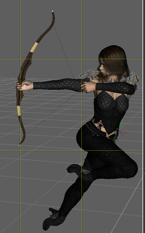

    @vwrangler "Has anyone managed to successfully convert the i13 Epic Archery set (https://www.daz3d.com/i13-epic-archery-collection)?
    I have. No issues writing.  Seemed to transfer as fast any other set. Here's a screenshot. FWIW, I haven't had any of the slow transfer issues that trouble some folks. Win7, I7, 32GB Ram
    472 x 758 - 153K

  • vwranglervwrangler Posts: 5,045
    Apparently, it needed to rest overnight or something. I was able to convert Epic Swords today without major issues. And it's working on Epic Archery. Sloooooooooooowly. Very very very sloooooooooooowly. According to the progress window, it's been running for 5 minutes 8 seconds, and it's done seven foot poses. There are 481 total full body, partial and body-part poses in the set, so ... it may take a while.
    Still, that's an improvement over not working on those poses at all, and last night, it absolutely was not.

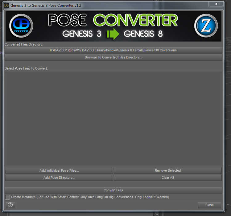

    @wizard1200 "I am sorry if this has been asked before, but how can i select the folder where the converted poses will be saved?"
    It's at the top of the window after you double click the script. "Converted Files Directory". See the screenshot.
    749 x 702 - 132K
    Post edited by fastbike1 on
  • fastbike1fastbike1 Posts: 4,082
