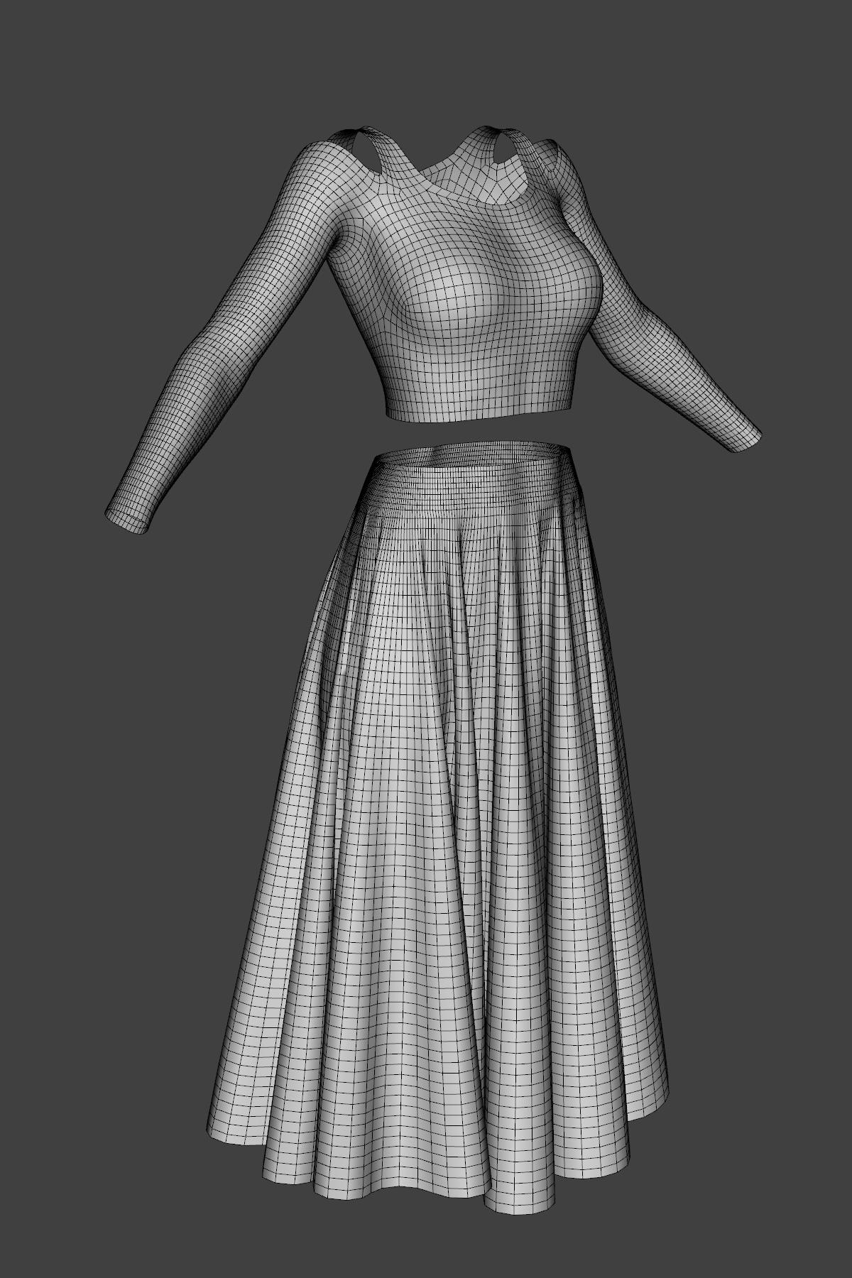

  • Matt_CastleMatt_Castle Posts: 3,199
    I wouldn't touch AI-created mesh with a bargepole when it comes to dForce. A good dForce mesh needs smooth topology; anything that is going to be inefficent at best and probably completely collapse, and more likely just detonate.
    This is the kind of thing where trying to fix the AI mesh will be more effort than just starting from scratch.
    When I was making a full-circle skirt, my mesh was just completely square topology:
    1200 x 1800 - 484K

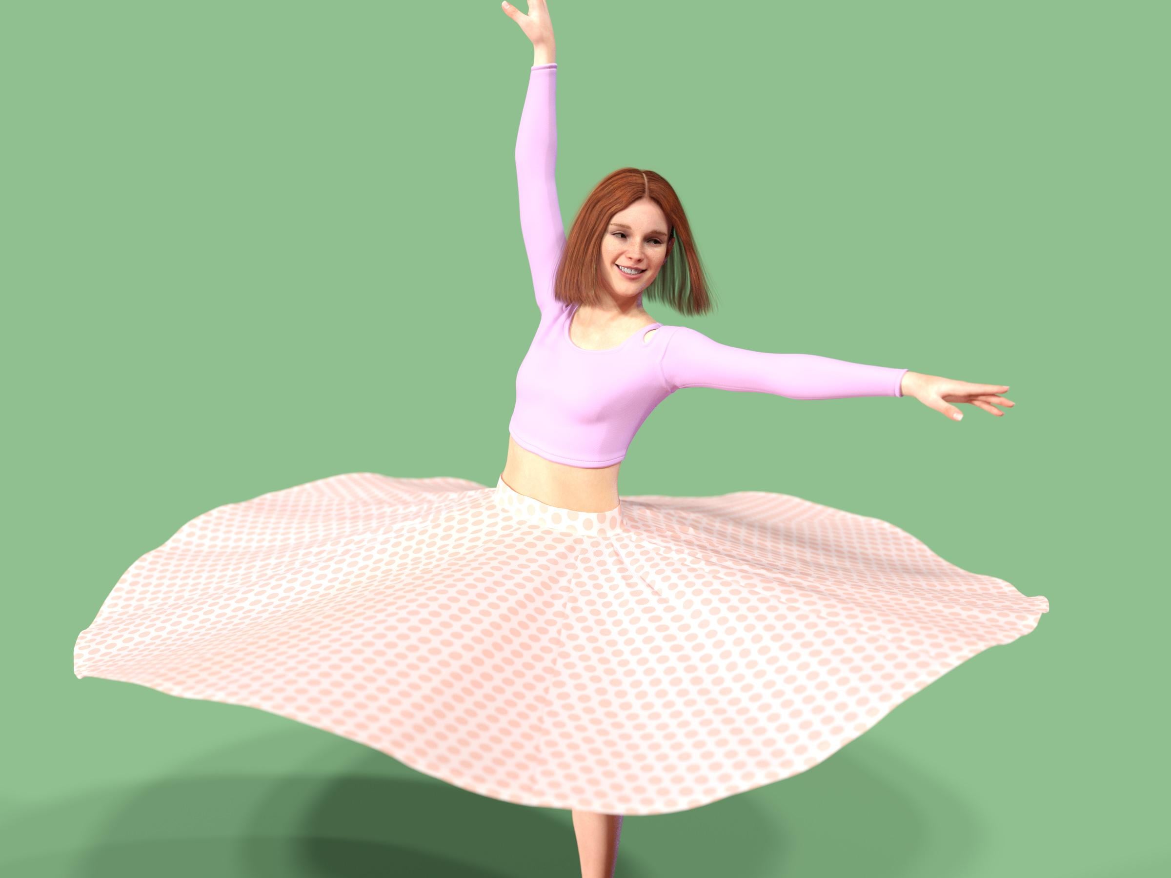

    Something I did some time back, originally because someone was having trouble getting their own effort to work, and I threw something together for testing purposes.
    It's hypothetically in the pipeline as something I might release, but needs a load of boring stuff done like figure fits, presets and thumbnails.
    There could be a morph which lifted the skirt up into a circle.
    That it can do. There was half a mind to include several pre-done simulations for various spins and the like, because it's difficult to do without dForce deciding to snag on something.
    2400 x 1800 - 486K

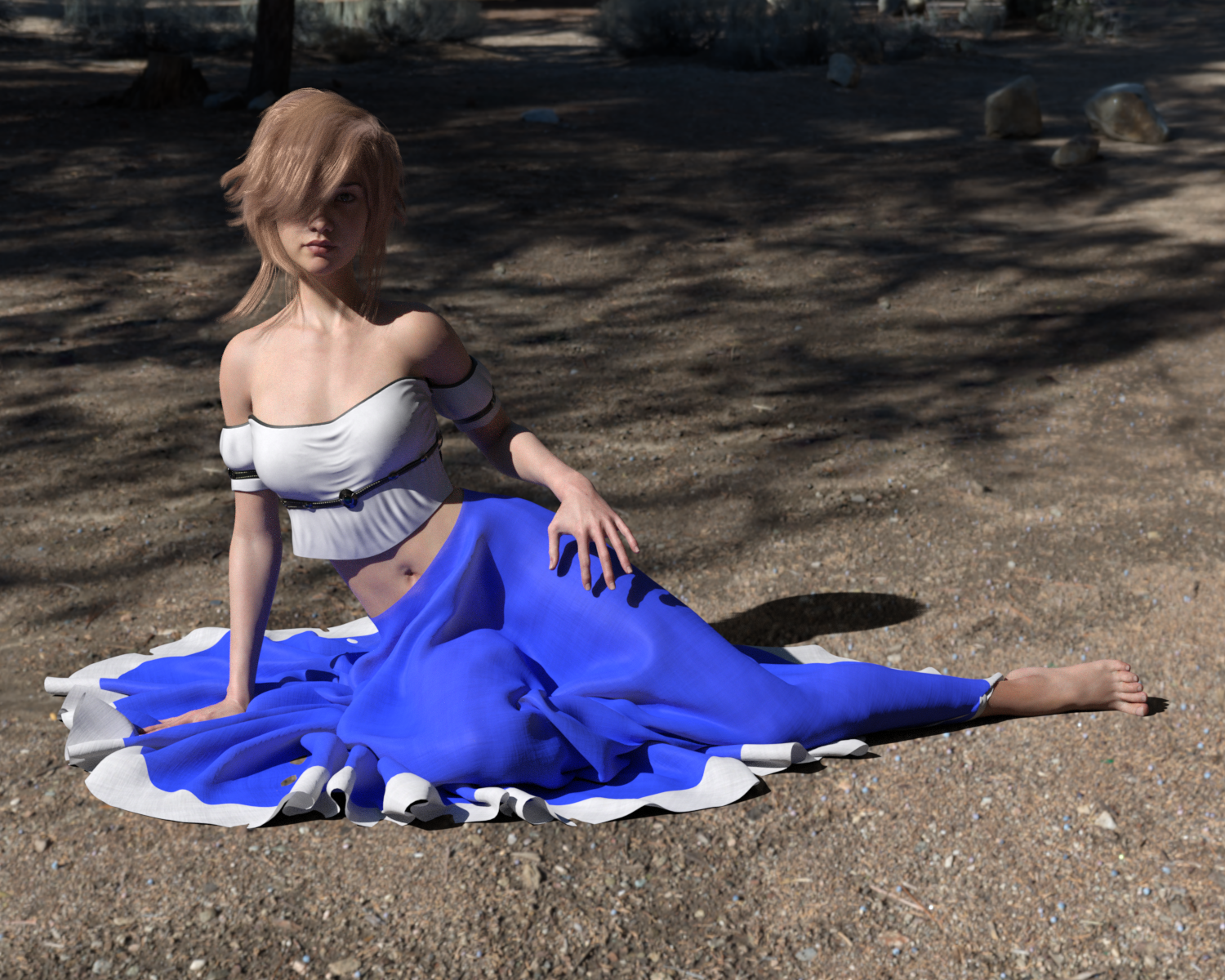

    There is a free one here:  dforce big skirt circle for G8F  This one is amazing.  However, it is too long without ruffles.  I will certainly use it, however :)
    Here is a Poser dynamic skirt:  Snow White for kids4 3D Figure Assets Tipol  I posted a picture below of how it looks when first loaded.  I have a project going on in DS, so pease ignore the water and things in my pic :)
    I used it here:  Trick or Treat by jan_scrapper
    It was, also, used here:  Sleepy Kitties by danidh   I loved her art and she has not posted since 2021 :(

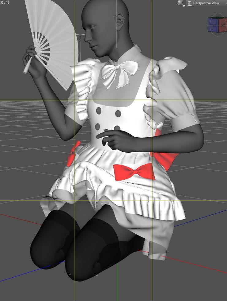

    imageThis was in Poser and the outfit is .Victoria 4 - Summer Fashion | Daz 3D.  This dress did really well and did NOT start around the waist.
    All I know is, several dresses I have with ruffles blew up when I used them a few months ago.
    dForce SU Maid Uniform for Genesis 9, 8.1, and 8 Female | Daz 3D
    dForce Princess Petra's Maid Outfit for Genesis 9 | Daz 3D
    dForce KuJ Cute Maid Cafe Outfit for Genesis 9 | Daz 3D
    I tried, and while I didn't get an explosion, it doesn't seem possible to get the dress to drape over the legs of the characters if they are on their knees or sitting:
    Initially, I thought it could be related to the morph (I initially used Hanako 9, because it's among the supported shape), but going back to Genesis 9 Base didn't solve the problem. Then, maybe it was because the pose applied a Y translation on the hip bone but even after moving it to the root bone, the part that is up still went up surprise I have no idea why that part is going up.
    741 x 980 - 73K
    Post edited by Elor on

  • HavosHavos Posts: 5,680
    Elor said:
    I suspect this is down to the simulation settings on the dress. Ensure that for the skirt part the dynamic strength is 1.0, and the collision offset is not too high (knock it down to 0.05 if you can) Lower values are more likely to settle properly, but can cause layers to poke through each other, so try different values for the best result,
