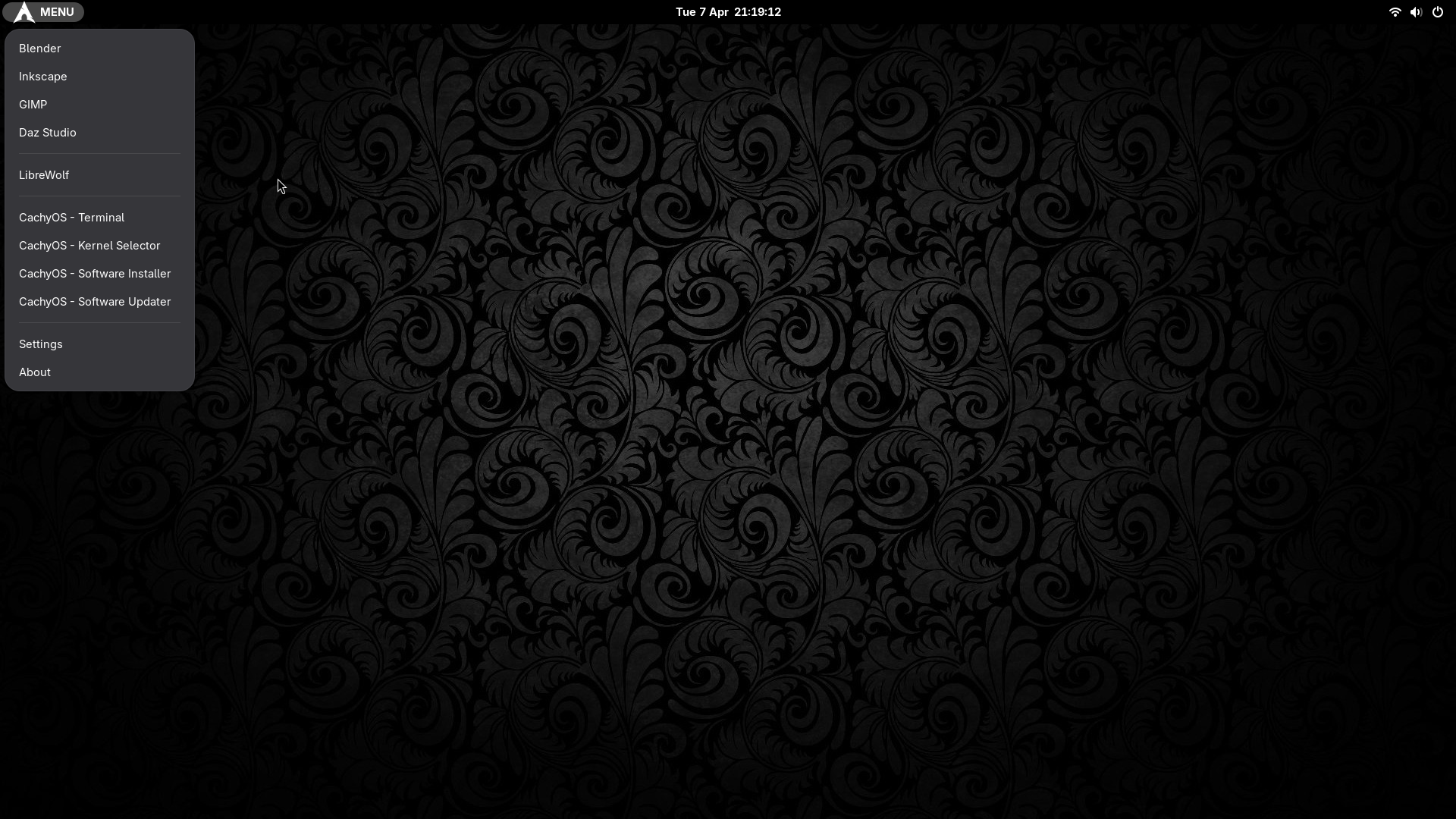

    IMAGE 1
    Shows the desktop with the menu open.  Haven't installed DaVinci Resolve Studio yet and that''s the only reason you don't see it in the menu.

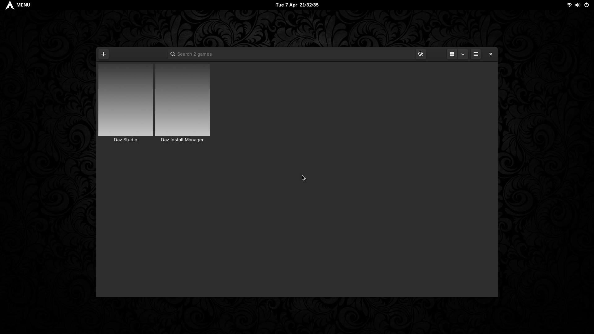

    IMAGE 2
    Shows what looks like a simple folder, but this is actually a minimalised Lutris that holds Daz Studio and Daz Install Manager.

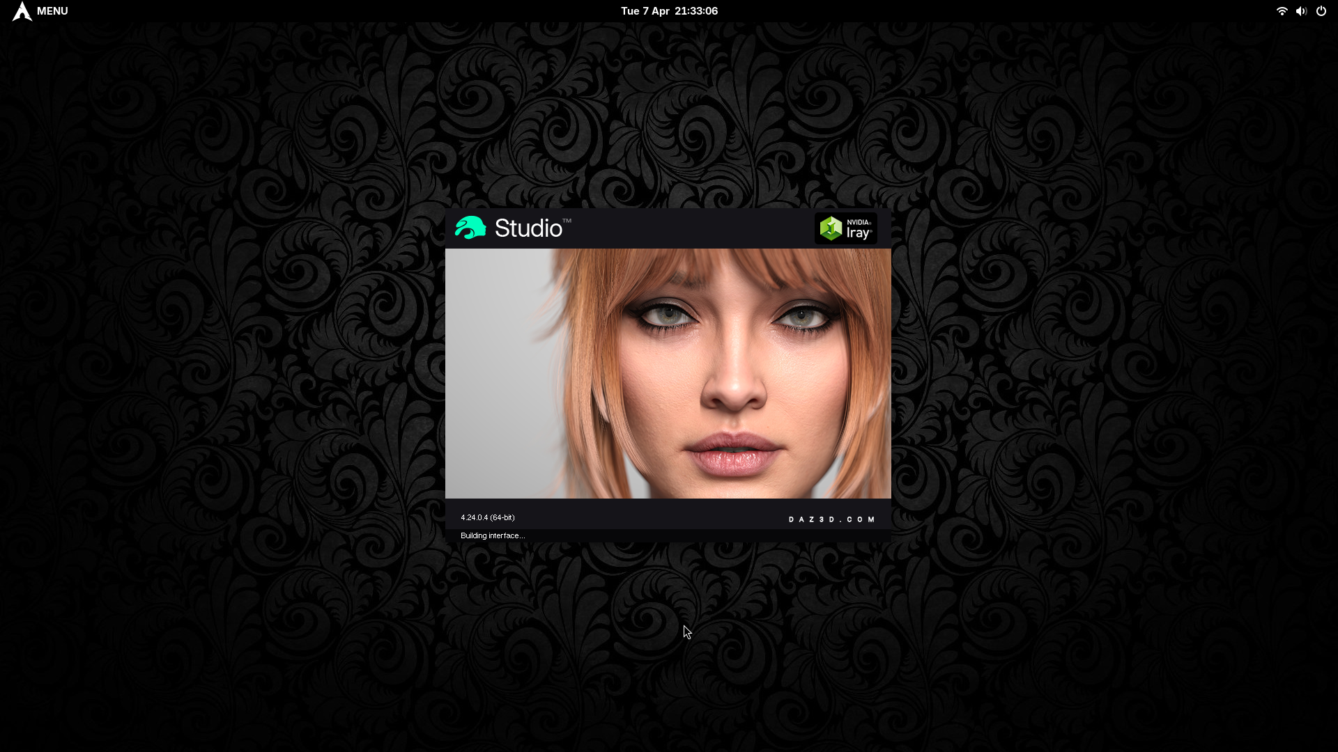

    IMAGE 3
    Click on Daz Studio from there and, look at that, it's Daz Studio running like it was natively on Linux!
