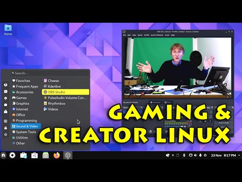

    @TimberWolf
    I was sure I'd heard the name "Nobara" before, but it's something I never followed up on.  Spent pretty much all last night looking into it after seeing your recommendation (cheers), and have decided to give it go.  As far as I can tell, it's pretty damn good in allowing you to decide what you want installed.  So I don't mind that.  Plus, I would need to install STEAM anyway, so that's a bonus for me.  To top it all off it's even set-up out of the box to accept the official Linux release of DaVinci Resolve Studio, which is the icing on the cake really!
    I'm personally not worried about denoising, and I'm more familiar with GNOME than KDE so I'll probably go for the GNOME version first, but either way I'll let you know when I have it installed.  If it works as expected then I'm sorted, because other than Daz Studio, there's absolutely nothing else I use Windows for.
    I've attached a video in case others are curious.  It's three years old this one, but it shows the post-install driver selection and auto-installation functionality:
    Post edited by 3DIO on
