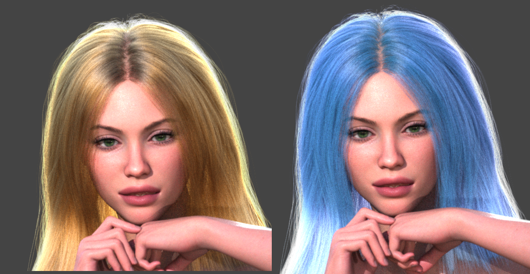

  • jmucchiellojmucchiello Posts: 1,979
    edited January 3
    Are you trying to use the shaders that come with the product or external shaders? This is from the product in Content Library.
    1057 x 547 - 893K
    edited January 4
    crosswind said:
    omvendt said:
    Hi, anyone else have this product
    https://www.daz3d.com/dforce-strand-based-fe-shawl-long-hair-for-genesis-9
    I can't change the hair color. I have checked that I am using G9 for hair and actor. The product has both materials and shaders, which I think is unusual. Mostly, it is just materials that you double click on, isn't it?
    Hope you can help    (O:
    The material presets that come with the product are just used for changing non-color settings. You have to use Shader Presets within this product. Go to Surfaces pane, select all hair Surfaces, dbl-click a Shader Preset to apply the colors.
    EDIT: the presets are also in content library. I used #48 "blue" in my post above:
    1508 x 875 - 1M
    Post edited by jmucchiello on
