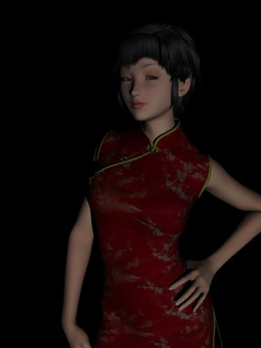

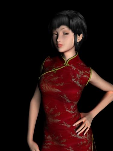

    Below are three images using a default V4 standing on a buff colored plane, to illustrate the differences between various forms of Global Illumination. All are lit with a single directional light in the "Loop" style as above.
    1 - This has no Global Illumination, just Ambient Light set to 25% as in Boojum's original examples. Note that there is no definition in the shadow areas (eg. the right nostril and ear) as ambient light illuminates all surfaces equally.
    2 - This has Ambient Light turned down to zero and Sky Light from a pure white color. Now much better definition in the shadowed areas but some of the shadows are rather harsh. Always remember to check the "Light Through Transparency" box in the Global Illumination panel when using portraits or you will get "dark eyes".
    3 - This adds Full Indirect Lighting to the above. This models the way that light bounces around the scene, resulting in softer, almost glowing shadows. The fact that she is standing on a colored plane becomes important here, whereas in the previous renders it was totally irrelevent. There is reflected light from that plane - delete it, or change its color, and the effects will be seen in the final render.
    I hope you agree that the realism increases as you go from 1 to three - unfortunately, render times also increase in line with this - the usual 3D rendering trafe-off!

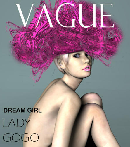

    Well, here's the first entry, but it's incredibly and embarrassingly bad, so please ignore it. The purpose of the exercise is to figure out what type of lighting the studio used, and why they did that. That's my excuse, and I'm sticking to it.
    In this case, by trying to reproduce it, you quickly realize that the main lighting was a single, fairly harsh light that was placed "low and inside" over the camera's left shoulder. And as you can see, it had overblown highlights to give that cool, hip kinda harsh look that everyone uses nowadays. However, that's pretty much all that was used, except for a tiny bit of fill. In the scene I did my version of it, I pretty much used a single spot, cranked way over 100% intensity, with soft shadows. Not much else. Pretty much the opposite of what Headwax normally uses.
    The point is, and it's one I've made over and over and over and over here, is that you don't need fancy lighting solutions, and prepackaged light setups, and GI and all the fancy rendering solutions. Often just a few strategically placed and designed lights will do it all. And you certainly don't need no "7 point" lighting setup like some self- proclaimed lighting masters recommend. Nor do you need the prepackaged "3 point lighting system" that everyone thinks is what everyone else uses. They don't.

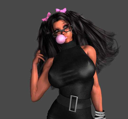

    Personally, I generally steer clear of a "standard" 3-point lighting scheme (which is anything but standard). In this case I used a softbox because I wanted the broad highlights on the eyeglasses and the dress, as well as good highlights on the rhinestone bracelets.
    However, I caution you to take anything I say with a grain of salt, because as Roy so accurately stated, in all my years here I've never shown any indication that I know what I'm talking about. Not an attack, 'cuz that's not his style. Just a fact. Thanks, Roy.

    There are ways to do it in Carrara. The easiest way is to set up a plane, add a color in the glow channel of the shader and turn on Indirect light. It's slow, but it looks nice.
    The other way is to set up a light box. I created a cube ion the vertex modeler and set up shading domains so that one side of the cube could be set up with it's own shader and the other five sides would be another shader. The single sided domain uses a shader with translucency, and the other domain uses a flat black shader. I stuck in a single bulb light at it's default settings with the exception of soft shadows. Those I set with a light radius the same size as the box.
    The first sample is the Indirect Light method. The second sample is the light box with no soft shadows. The third sample is the light box with soft shadows applied to the bulb and the fourth sample is just the bare bulb. If you want any more info. about the shader settings or light settings, just ask!
    480 x 640 - 92K
    480 x 640 - 75K
    480 x 640 - 70K
    480 x 640 - 89K
