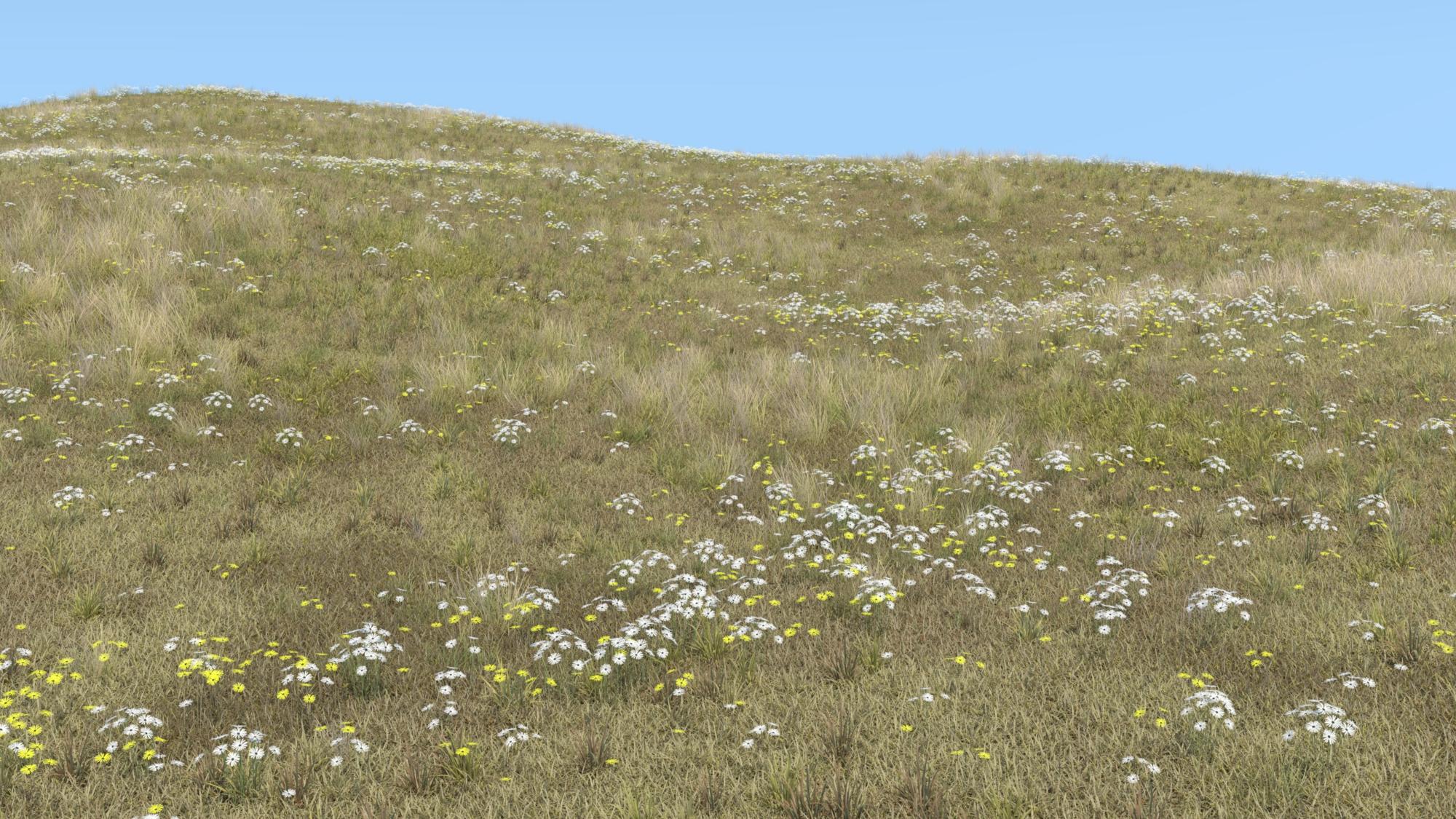

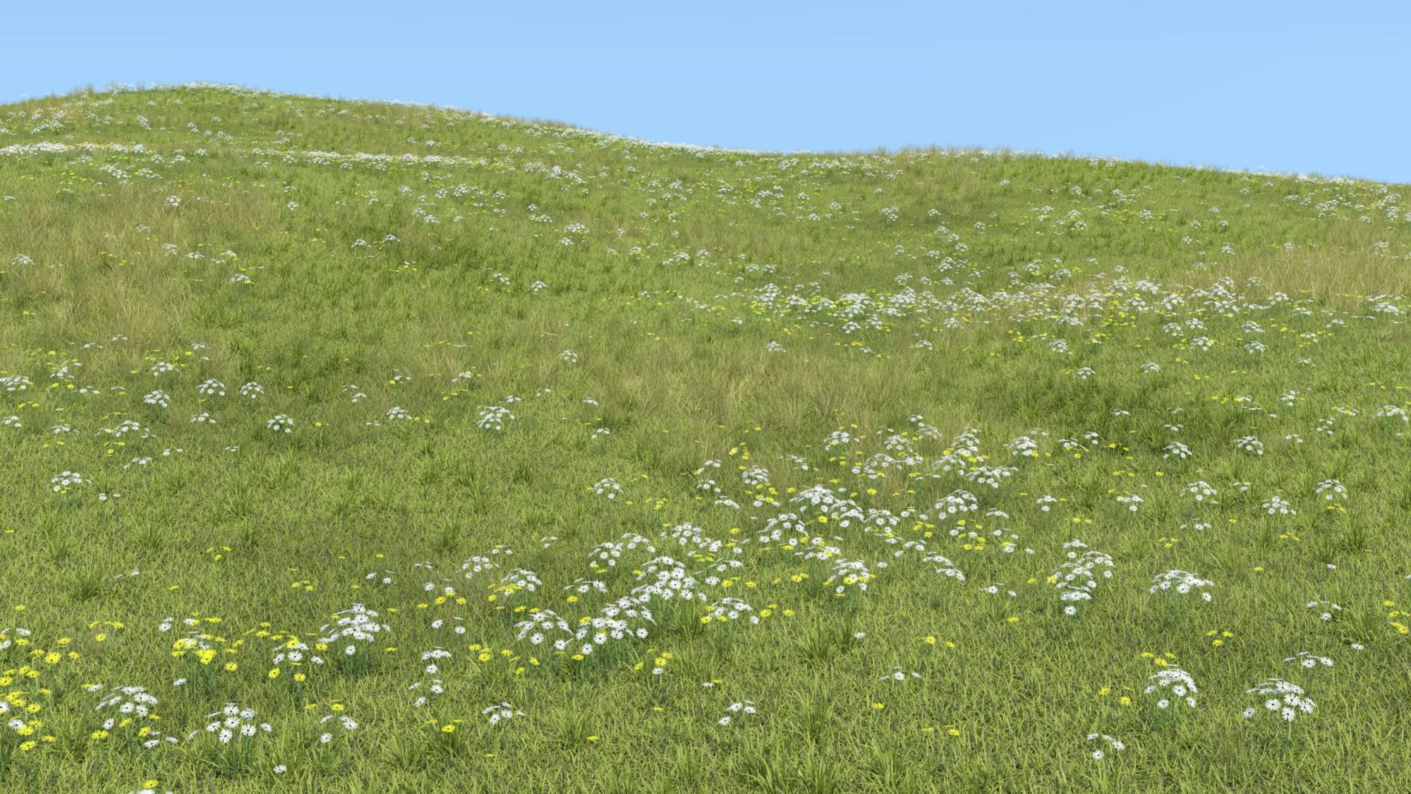

    Is it possible to change the colour of the Base Grass? I'd like the grass autumnal to match the autumnal trees.
  • barbultbarbult Posts: 26,545
    edited June 2023
    In the Surfaces pane you can modify the base grass color settings, just like you would any other Daz Studio prop. Or you could use Alienator Pro to substitute a different grass prop. I'd go with Surfaces settings.
    Modified Surface Settings
    Original Green
    2000 x 1125 - 2M
    2000 x 1125 - 2M
