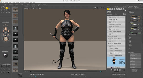

    adzan said:
    well that's just weird, so I must be doing something wrong
    start ds, empty scene, single click on fashion pose 14, click on the active options pane, create poser companion file,
    apply to g3f in Poser with Poser Unimesh ticked as I would for any other genesis figure ????
    even tried loading it with the poser tradition skinning method which is on by default..
    well i've got no idea
    not that it matters, only tried it because of a thread on another site, haven't done this 3d larking in years and probably wont for more
    I see what you mean by the poke throughs
    This is Genesis 3 Female with the Heavy morph at 50%
    Wearing my Road Predator outfit. Not released yet
    1920 x 1042 - 376K
    Post edited by Midnight_stories on
  • WandWWandW Posts: 2,907
    edited June 2015
    TRRazor said:
    well that’s just weird, so I must be doing something wrong
    Last time I checked Poser's background color wasn't purple.
    The screenshot you attached to your post looks very much like a DAZ Studio screenshot.
    Could you show the same character posed like that in a Poser viewport, please?
    Poser's background colour is whatever one wants it to to be. The shadows look like those of Poser default lights moved slightly...
    EDIT! WOAH! What's your secret, Midnight Stories? ")

  • TRRazorTRRazor Posts: 20
    EDIT! WOAH! What’s your secret, Midnight Stories? “)
    Would also be interested to know, how you got Genesis 3 into your PoserPro 2014.
    Is that the fully rigged figure in there, or simply an .obj export?
    Thanks for your tips, in advance :)

  • Midnight_storiesMidnight_stories Posts: 4,112
    edited June 2015
    TRRazor said:
    Care to elaborate, midnight_stories ?
    Got to talk to DAZ first ! Will do a Video tutorial.
    Expression don't work due to they are not morph driven.
    Have got the clothing working now. and yes all the bends work.
    Will also talk to DAZ about the expression it may only be unhiding the bones to fix.
    I've only messed around with a few Hrs so will try and iron out the bugs.
    It's totally different method to what the other person is doing I've only done it twice so bit more testing.
    Hang in there !
    P.S 1.00 in the morning here so hitting the bed zzzzzzzzzzzz
    764 x 1100 - 447K

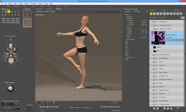

  • adzanadzan Posts: 268
    Images have a purple look as I didn't add a background in poser and the forum software adds the colour to a transparent png.
    I have no morphs except those offered with the free G3F Starter Essentials that downloads with DIM so it possibly isn't using the new skinning methods, but I don't know anything about how Genesis 3 works so I really wouldn't know.
    Poser 2014 patch 5.28925, DS 4.8.0.59, DSON Poser Importer 1.1.3.50
    780 x 469 - 66K
    Yup Updated to DSON Poser Importer 1.2.0.12 and everything exploded, so i'm happy to report G3F doesn't work in Poser now lol
    WandW said:
    If you reinstall the old one does it work?
    Just uninstalled 1.2 and reinstalled 1.1.3.50 and indeed it does work again ??
