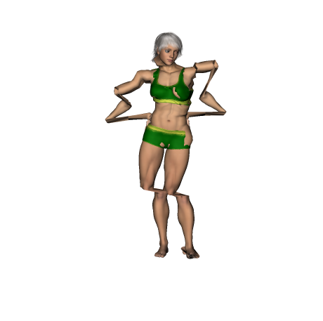

  • ByrdieByrdie Posts: 1,783

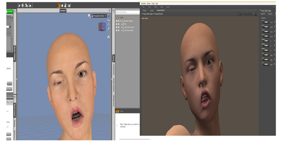

    Thanks, I'll check it out later. From what I hear it gets us at least a Genesis 2.5. :lol: Right now I'm pulling my feathers out trying to find out why G2 in Poser with V4 skins has really dull eyes. Not that the ones she comes in with before I change UVs look any better.
    And no, the lighting does not improve matters. Ugh!

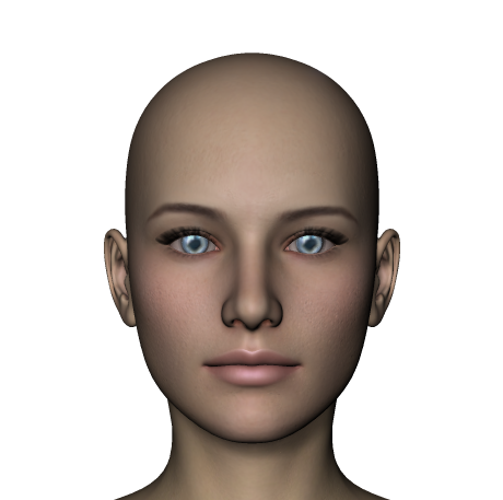

    Thought of that. But sometimes I want to use sets like Inked or Attitude on my characters and every time I try it EZSkin wipes away the tattoos or whatever else I've added. :sigh: Results are otherwise gorgeous, though.

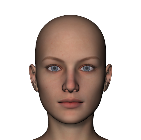

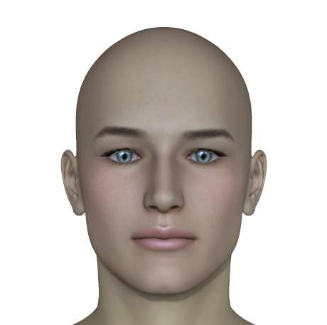

    Have discovered that for some weird reason the UV setter -- or maybe it's Poser or the DSON importer doing this, I can't be sure -- is bringing some of the old V5 Bree stuff from the G2 base when it comes to the eyes. I had to go into the material room and clear it out, replace it with the correct V4 maps. Also found some better lights and played with them a bit. It's getting closer to what I want.
    460 x 457 - 118K

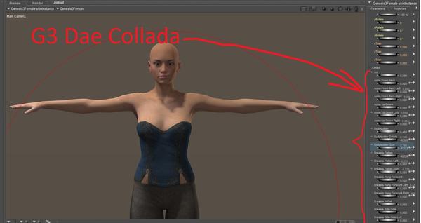

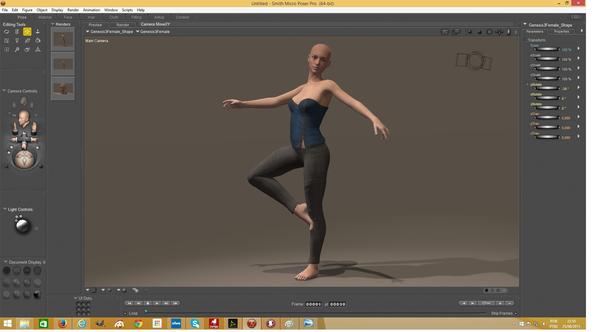

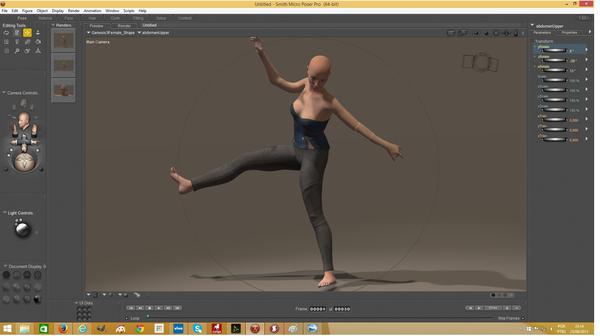

  • jorge dorlandojorge dorlando Posts: 1,159
    quietrob said:
    Jorge, nice job! G3 looks better in Poser but it might just be the lighting.
    Can you give us a step by step?
    Not worth it, step by step, this is painful, and limited to rotate, scale, and tran even in FBX format
    1523 x 852 - 159K

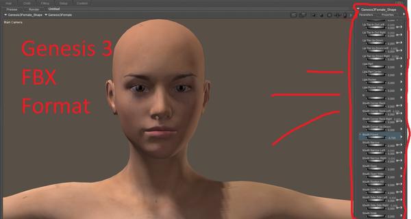

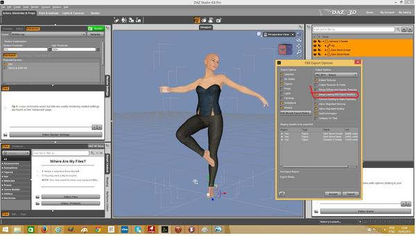

    Here I copied the morphs G3 (PoserCF) to G3 FBX
    Now, with G3 FBX tab of morphs,but they do not respond
    1671 x 892 - 210K

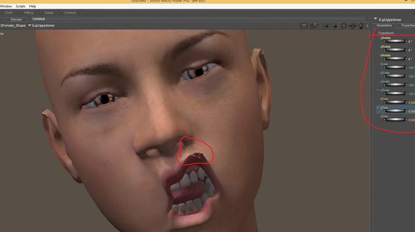

    edited June 2015
    here also a Collada dae, with the copied morphs G3 PoserCF / DSON
    Now they appear in the tab but do not respond
    1671 x 886 - 207K
    Post edited by jorge dorlando on
  • RedSpec SSSRedSpec SSS Posts: 38
    They cannot respond because the weight maps to support them aren't present / canot be translated.
