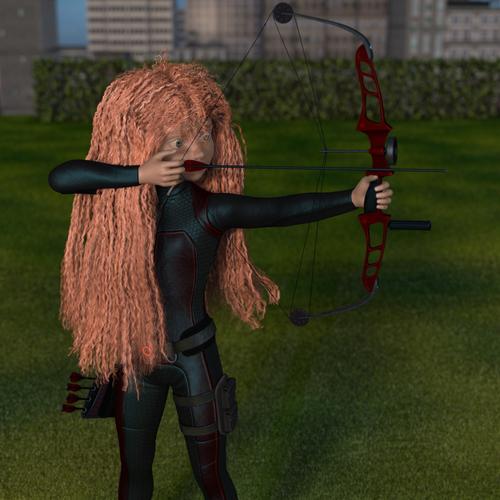

    Decided to take a break from the usual stuff and revisit the cat lady.
    I don't do a lot of furring so I had a feeling there were some tricks I was missing in the process ( there were :-) )
    Anyway, this gal has about half the generated hairs as the previous one in spite of having a tail and head hair added.
    1000 x 1000 - 322K
  • krickerdkrickerd Posts: 184
    Nice job on that fur and scene with grass and all.

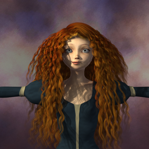

  • kyoto kidkyoto kid Posts: 40,576
    edited April 2015
    ...OK launched my Merida Hair Project.
    Saw the pics on earlier pages here and since I already built a version of her, it seems logical to try to build the hair as well.
    Able to get the fullness, but need to figure out how to get that "springy" curl for the strands and make the back (outer) strands longer.
    Is it possible to do this in "layers"?
    Attached: Merida character using premade hair content.
    900 x 900 - 1M
    Post edited by kyoto kid on
    Actually, it probably would be easier in layers. Trying to style two different lengths on the same 'layer' is a bit more than a pain in the posterior.

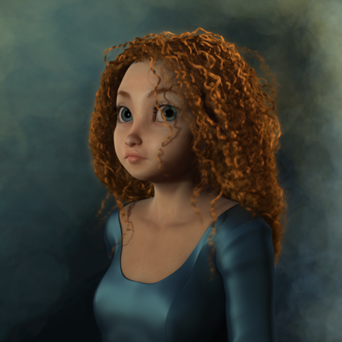

  • GoneGone Posts: 833
    This was my most recent attempt at Merida style hair a couple of months ago. I used 3 layers - short tight curls, long loose curls, and long tight curls.
    In order to get long tight curls, you need to reduce the seg length - otherwise you just get long loose curls :-).
    To get a closer approximation, you would probably need to add at least one mid length layer. It is certainly possible to get a lot of volume for the hair, but I don't think you can get the bouncy springy feel. At least I haven't been able to get a springy feel that I was satisfied with.
    edited April 2015
    ...looks much better than my first test from last night. I increased the thickness to the strands a bit on a second test and it did look better.
    Thanks for the tip on the segment length.
    Yeah Ithink Ireally have my work cut otu for me with this one. Did the same thing with my first Iray scene (a very complex one with all sorts of surfaces to deal with. One of those types who has to dive in head first instead of just dipping a toe in the water.

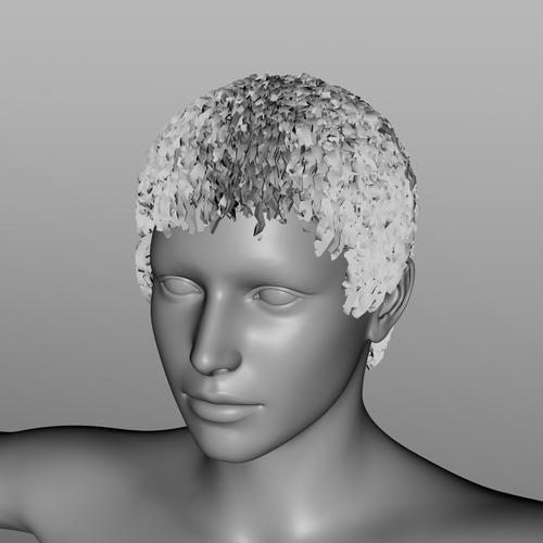

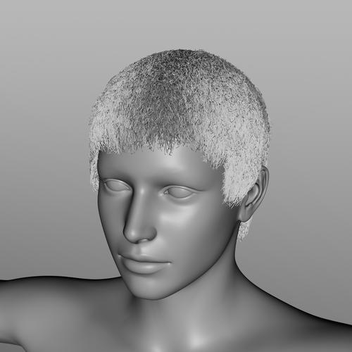

    marble said:
    You know, while I have LAMH... there are some very compelling bits of Garibaldi styling.
    I assume you can export Garibaldi hair to Obj... do things like root/tip coloring carry over, or if I use it with Iray will I have to shade it myself completely?
    I haven't read the whole of this thread but in my experience, exporting to Obj does not carry over any of the detail. I can't speak for IRay but I have tried it with Luxrender (via Reality) and I had to colour it in the surfaces tab. Also the fine detail, such as the narrowing of each hair to a fine tip, does not export to Obj. What you end up with is a wig made of wire strands - not very convincing.
    The only reason Garibaldi even does .obj export is because people were asking for it. It is an unsupported feature and does not carry any shader info with it.
    However, you can choose your own level of detail on the export. Here are some untextured renders of a simple hair I did about a year and a half ago when the question was raised then. The exports were at 5%(16.8M), 20%(73.1M), and 50% (185M). You could choose 100% but I doubt you would have enough memory to hold such a massive object.
