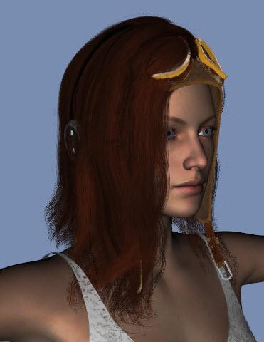

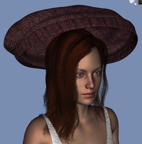

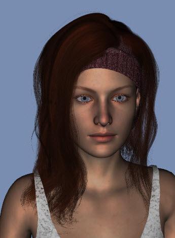

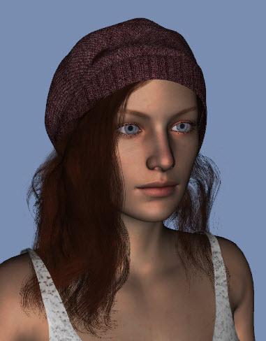

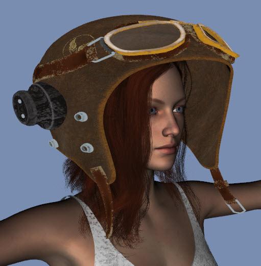

    93. Putting a Hat Over Hair
    As we did with the goggles, we can use a similar technique to put a hat over the hair. Much of this relies on what I did in tutorial 92 so read that first. I used the same Kyle hair in these examples.
    a. For the first example, I used the same helmet-goggle product as in the previous tutorial 92 but with the helmet left visible. Because the product was made for G8 and I’m using it on G2, I had to adjust Y-scale to 106% to cover the ears with the built in headphones.
    b. I updated the weight map by painting more of the upper hair, leaving the area of less influence (purple color) by the part. How much of this you can do depends on how the hair was constructed.
    c. Select the helmet and set a keyframe at frame 10 using the +key icon in the timeline.
    d. Go to frame 0 and scale the helmet as needed to clear the hair. In this case it was 110% Scale, 187% X-scale, 106% Y-scale, and 148 Z-scale.
    e. Run the simulation with the torus visible to pull the hair back as we did in tutorial 92.

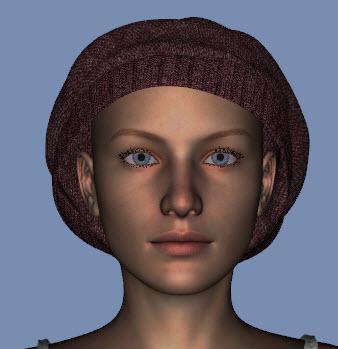

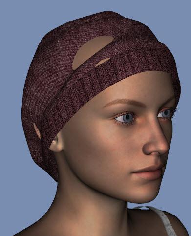

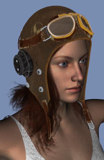

    The second example uses the hat from Smells Like Fall for Genesis 2 Female
    f. Although it was made for the figure I’m using, the hat has more of a gap around the face then I like. So I scaled it down to 85%.
    g. The scaled down hat had better fit of the head band but had parts of the ears and head showing through. I used MeshGrabber to pull those parts of the hat out so the skin was hidden.
    h. Go to frame 10, select the hat, and click on the +key icon in the timeline to set a keyframe. At frame 0, scale up the hat to clear the hair. I used 105% Scale, 196% X-scale, and 185% Z-scale.
    Frame 10:                                                               Frame 0:
    i. Run an animated simulation to get the result below.

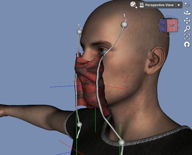

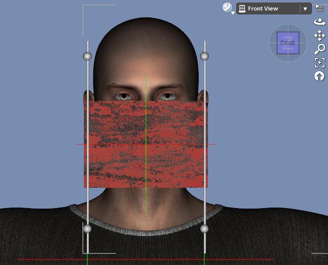

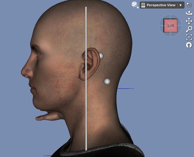

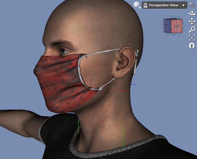

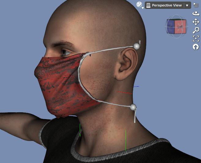

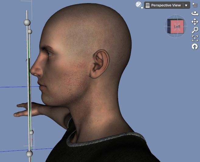

    94. Creating and Using a Face Mask
    During covid there were many homemade face masks in use. Here’s a version for Daz.
    a. Load a figure. I used G2 Male as it’s fast to load.
    b. Create a Z-positive plane of 18 cm size and 40 divisions. Adjust Y-scale to 70%. Position it over the face so the top edge is about half-way up the nose and the tip of the nose is almost touching the plane.
    c. Create a Y-positive cylinder of 31 cm length, 0.3 cm diameter, 128 segments, and 16 sides. Position it so the plane passes through the vertical axis of the cylinder and the cylinder is near the edge of the plane with one segment of the plane sticking out to the side.
    d. Use Edit/Duplicate/Duplicate Node(s) to make a copy of the cylinder and position this on the other side of the plane.
    e. Create a sphere that is 1.25 cm in diameter with 16 segments and 16 sides. Position it at the upper end of a cylinder with about 7 segments of the cylinder extending above the sphere. This sphere will serve as a helper object.
    f. Duplicate the sphere and position one a similar distance from the bottom of the same cylinder. Duplicate each of these spheres and position them over the second cylinder on the other side of the mask.
    g. Add a dForce dynamic modifier to the plane. In the Surface pane set Simulation/Density to 40.
    h. Add a dForce dynamic modifier to each cylinder. In the Surface pane set Simulation/Collision Offset to 0.05. Set Dynamic Strength to 0.9, Shear Stiffness to 0.47, and Bend Stiffness to 0.2.
    i. Setup the timeline so the body moves forward at frame 5 so the plane is running through the middle of the ear.
    j. Set the upper spheres to be above and slightly behind the ears at the frame 5. Set the lower spheres so they move horizontally to a positon below the upper spheres. (See image above)
    k. At frame 7, tuck the upper sphere behind the ears. Move the lower spheres so they about level with the ear lobes. At frame 9, tuck the lower spheres behind the ears just under the upper spheres.
    Frame 7:                                                                                      Frame 9:
    l. It helps to X-rotate the spheres at frame 5 and 7 so the cylinders are not being stretched.
    m. In the Simulation Settings pane:
    1.  Set Environment/Gravity to 0
    2. Set Simulation/Quality/Frames Per Second Multiplier to 4
    3. Set Simulation/Quality/Subframes to 16
    4. Set Simulation/Collision/Collision Mode to Best
    n. Run an animated simulation. Hide the spheres at the end to render. You can also adjust the spheres to leave less of a tail of string.
    Frame 2:                                                                                     Frame 5:
    Frame 7:                                                                                     Frame 9:
    Frame 30:

  • PraxisPraxis Posts: 276
    Brilliant!  Inspires me to use similar techniques in a lot of other situations.
    Thank you!
  • RGcincyRGcincy Posts: 2,862
    Thanks Praxis. If you do anything interesting, feel free to post an image of what you accomplished.

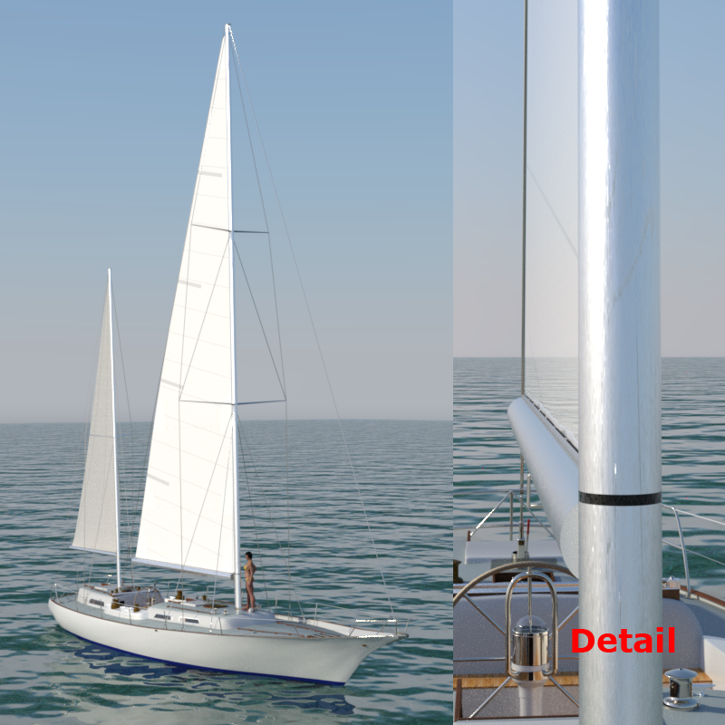

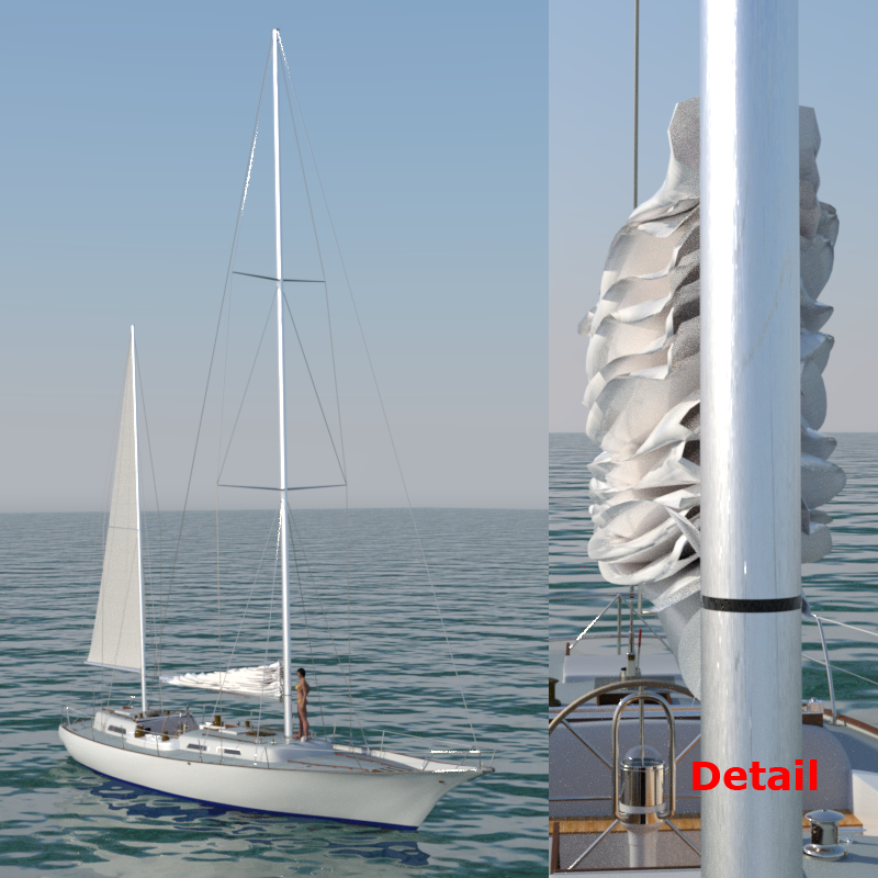

    edited December 2022
    Well here it is... Animation of lowering/raising the sail of a yacht
    I had to use lots of "helper" objects to retain the sail attachments to the mast, and to get the folds sort-of in the right places, and I had to animate those helpers via a script to get the correct behaviour.
    But I'm pleased with the result:
    0% lowered:
    50% lowered:
    100% lowered:
    800 x 800 - 655K
    800 x 800 - 668K
    800 x 800 - 706K
    Post edited by Praxis on
    Very interesting idea and looks good to my eye. You could spawn morphs at various stages and have an easy way to lower and raise sails for different renders.
  • The next possibility is to save the shape as an obj, tighten the folds a bit and model in some reefing points all tied up. Looks superb. Regards, Richard
    Thanks for the feedback and ideas!  To get better-looking folds I should have used SubD=2 on the sail instead of 1.
    Also : Upgrading this 1968 yacht to a 2022 roller-furling boom would save a lot of modelling and animating angst devil ...but would be a lot less fun.

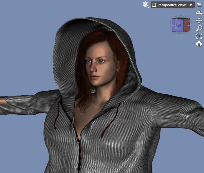

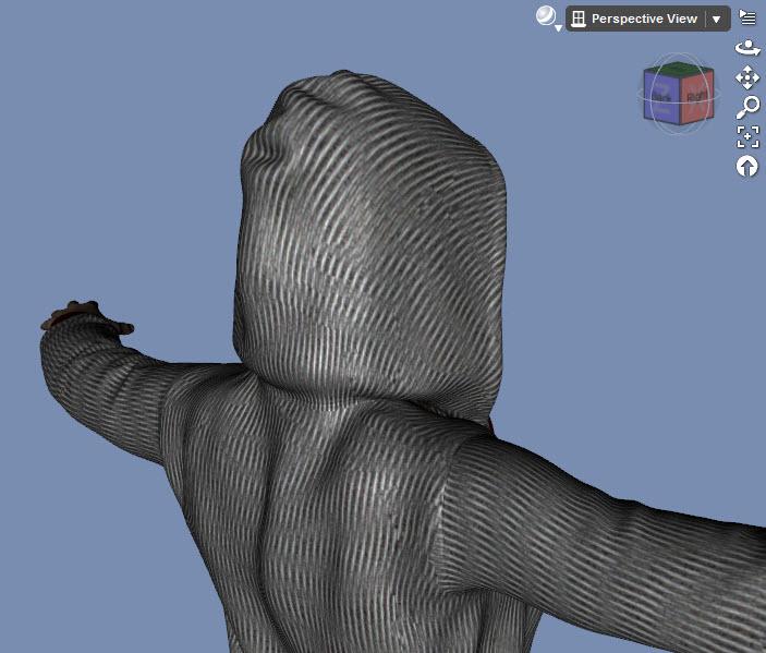

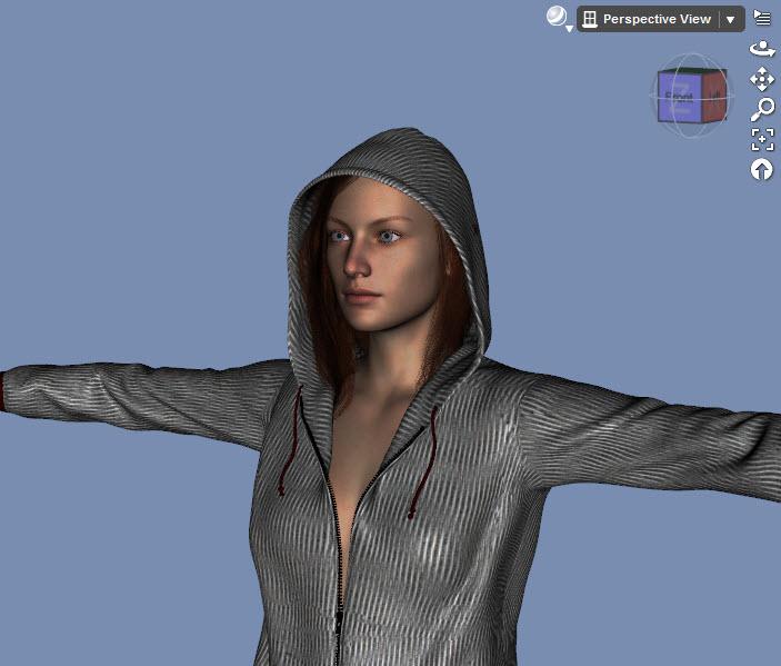

  • @RGcincy:  What about a hood like a cloak or hoodie?  How would you handle the hair, especially the back.
    I might have an example of that, let me look.
    edited February 2023
    I would do it similar to what I did for the pilot's helmet: increase the scale of the hooded item in frame 0 so all the hair is inside, then restore the scale to 100% at frame 10. This will use the hood as a helper object to press the hair down onto the figure as the hood shrinks. You will likely find some stray hair outside the hood and depending on the camera angle you are using, you may want to use meshgrabber to push the hair in (or pull the hood out). You could also use the geometry editor to select and hide the stray hair.
    I used the Urban Survivors Hoodie for this example.
    Frame 0: Hood scaled to 110%, X-Scale at 140%, Z-scale at 145%. You'll have to select Show Hidden Properties in the Parameters pane submenu to see these controllers.
    Frame 10: Hood restored to normal scale.
    Frame 10 with hair's weight map highlighted. The red shows stray hair outside the hood.
    Frame 10 after use of meshgrabber on right side of hood.
    703 x 599 - 79K
    703 x 599 - 67K
    703 x 599 - 82K
    703 x 599 - 78K
    Post edited by RGcincy on

    Xero7489 said:
    Hi there, i was wondering how it would be possible to create a wrap around type of tape covering the mouth, but also the hair? somewhat similar to the set you did with getting the goggles over the models hair, the tape covering the mouth but also going around the head over the hair as well. somewhat like you did here below, but with tighter wrapped tape and if the model had long hair.
    Xero7489 said:
    I would think the way I put a hat and a pilots helmet over the head would work for you: Putting a Hat Over Hair Just make sure the cylinder clears the hair as well as the face.
    To keep the tape more tightly wrapped, make the cylinder with only one vertical segment, use a density of 2, and increase shear and/or bend stiffness (the latter could cause a crash so follow best practice and save any dForce scene you set up before running the simulation so you can restore it).
    Also, is it possible to have like a plastic bag/clear wrap over the models head, covering their face as well as compressing the hair underneath the bag?
    Should be possible. You'll have to set up the hair to dForce and that can vary by the hair you use. Follow the same Putting a Hat Over Hair tutorial I mention above  For the bag, make a primitive sphere with lots of sides and segments. Scale it to be an ellipsoid larger than the face. Use the geometry editor to get rid of the lower end of the sphere so it is open, Either save a key frame at frame 0 with the bag overly large, then at frame 10 scale it down so it more closely fits the face OR use a Contraction-Expansion Ratio of less than 100% (you'll have to play around with the value to see what works best for you).

    awesome, thanks so much for the advice, i really appreciate your tutortials! Ill give these both a try as soon as i can!
    Sorry to be a pest, but I had one other item I hope you can help with. Basically how would I have a bed sort of sink in the areas where a model is laying on it? just want it to look more realistic when i have a model laying on a bed, rather than the bed stay completely flat like if she was on a hard floor. many thanks for these wonderful tutorials once again!
  • crosswindcrosswind Posts: 9,737
    edited August 2023
    Here's a very simple way but with good result for your request. Add a dForce modifier to the Surface of your bed, mattress or sheet (better have more mesh resolution on the surface). Use timeline to make the figure fall down to the surface. Zero Gravity and simulate. If you wanna smooth the surface, add more value to Velocity. I attached the scene file with settings for your ref. If you learn more about params on the dynamic surface and dForce modifier weight node, you can make lots of subtle change with dForce objects.
