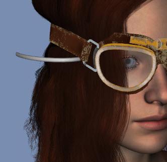

    t. Add a texture to the belt planes. Hide the cylinders if they are visible in your view. I also created a small cube to act as the door jamb anchor for the belt. Here are two final renders of the belt in use.
    Just wanted to give a huge THANK YOU! for this wonderful tutorial. I needed to strap G8F into an airplane seat with a 4-point harness. Used a vatiation of this method - I added a torus shape to the middle of the lap belt, then ran two shoulder belts from it up over each shoulder. Worked out perfectly, and I couldn't have done it without this tutorial!

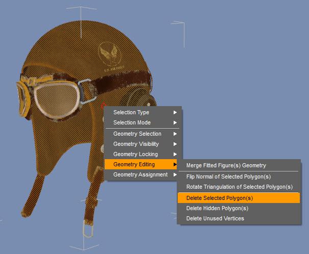

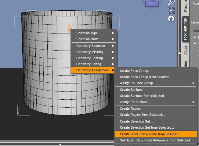

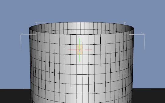

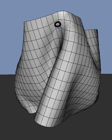

    90. Rigid Follow Nodes
    These nodes allow you to attach objects to a shape that is being deformed by dForce so the object follows along. While helping Nath with her bag, I observed some unusual behavior with the simulation results varying depending upon having or not having a dForce modifier on the object attached to the node. Results depend upon the starting state, clearing or not clearing a simulation before doing a new simulation, and whether the object attached to the rigid follow node has a dForce modifier added or not.

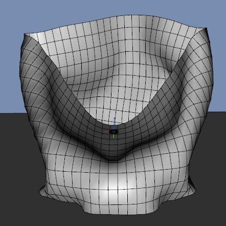

    a. Create a 3-foot plane and set at Y-translate -3.
    b. Create a Y-positive cylinder which is 12 inches high, 12 inches in diameter and has 12 segments and 64 sides.
    c. Select the cylinder and use the Geometry Editor to delete the triangular polygons on the top and bottom faces.
    d. Still using the Geometry Editor, use the polygon selection tool to select one face near the top edge of the cylinder. Then right click in the viewport and choose Geometry Assignment/Create Rigid Follow Node from Selected and give it the name A. In the Scene pane, the cylinder will now have a child that looks like an I-beam labeled A.

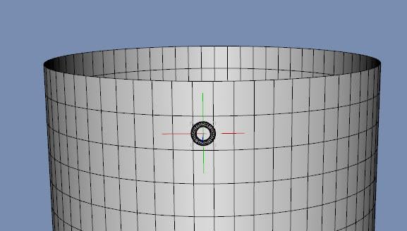

    e. In the viewport, the location of the node is indicated by a 3-way axis of red-blue-green lines. It should be located at the position of the face you selected but I often times find it offset. If it is offset, use the translate dials to move it to the position of the face.

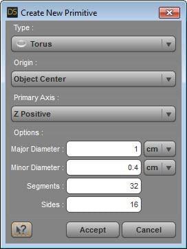

    f. Create a Z-positive torus that is 1 cm major dimeter, 0.4 cm minor diameter, with 32 segments and 16 sides.
    g. In the Scene pane, use the pane menu to check that Parent Items in Place is unchecked. Then parent the torus to the I-beam. The torus should end up centered in the middle of the face you selected.
    h. Add a dForce dynamic modifier to the cylinder.

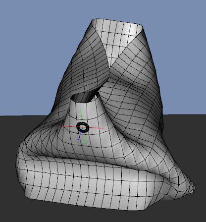

    i. Set dForce gravity to 0.35 to avoid the complete collapse of the cylinder. Run an animated dForce simulation. You’ll see the cylinder deforms and hang from the original location of the torus.
    j. If you clear the simulation and re-run it you’ll get a similar result with the bag hanging from the original location BUT if you run a new simulation without clearing the original, the bag will collapse further. Run it again without clearing the simulation and it will collapse into a different state. Repeating this process results in these two states being repeated alternatively. Not sure why this happens other than perhaps the simulation is starting from the simulated position not the original.
    k. Clear the simulation.

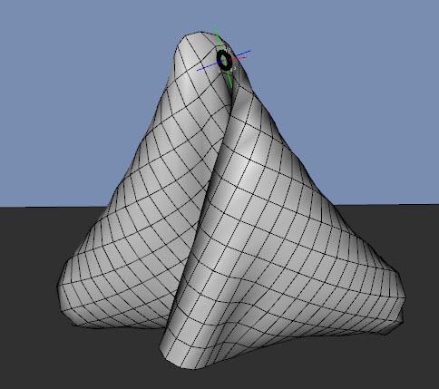

    l. Add a dForce dynamic modifier to the torus. In the Surfaces pane, under Simulation parameters, set Visible in Simulation to Off.

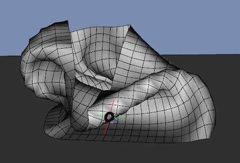

    m. Run an animated simulation. The cylinder will drape from the location of the torus. You get less distortion than you do in step i.
    n. Repeat the simulation without clearing. Unlike step j where the bag varied in its deformation, it will drape the same without clearing the simulation. This is so, even though the dForce modifier on the torus is not visible to the simulation.
    o. Set gravity to 0.75. As expected, you’ll find the cylinder collapses much more but the torus stays in position.
    p. Clear the simulation.
    q. Remove the dForce modifier from the torus. Run a simulation. Now the bag is hanging from the original location of the torus and does not collapse as much as in step o.
    These examples indicate you can get different draping results depending upon the starting state, clearing or not clearing a simulation before doing a new simulation, and whether the object attached to the rigid follow node has a dForce modifier added or not.

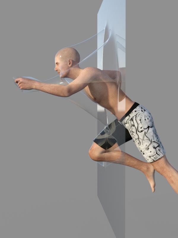

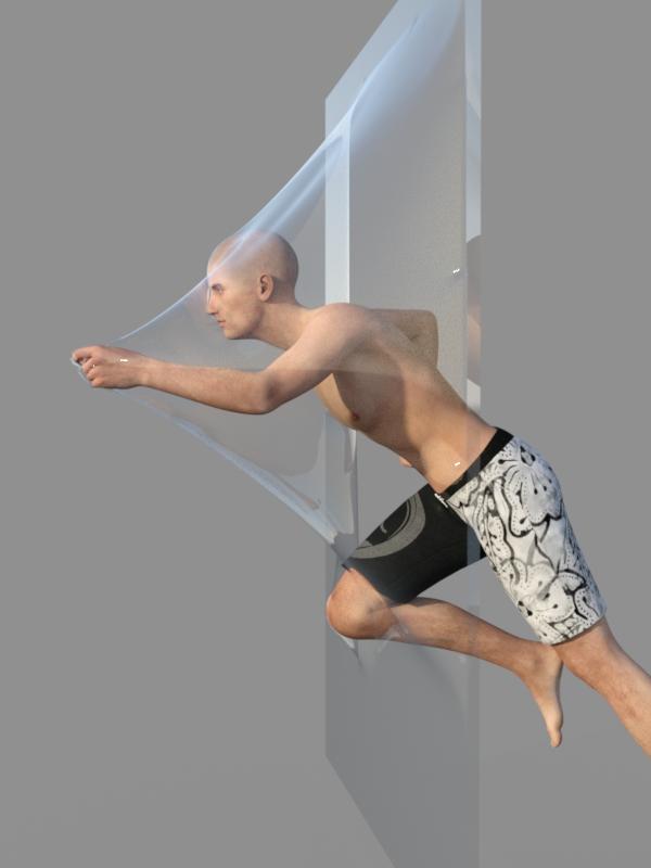

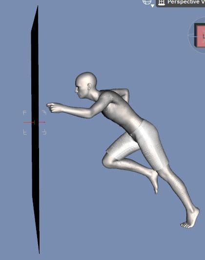

    This was a dForce topic that I heard about today. Unlike sometimes, it came together pretty quickly.

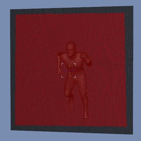

    91. Cling Wrap
    Bluefeathers posted to the Daz Forum looking to get the effect of a character breaking through a sheet of cling film. I gave it a try and came up with a reasonable representation of that happening.
    a. Create a plane with 250 divisions.
    b. Add a dynamic dForce modifier to the plane.
    c. In the Surface pane, set the Simulation parameters as follows:
    • Stretch, Shear, and Bend Stiffness to 0.01
    • Buckling stiffness to 100%
    • Buckling ratio to 0%
    • Density is 600
    d. Add a dForce modifier weight node to the plane. Using the Node Weight Map tool found in the Tool Settings pane, click Add Map to create an influence weight map. Then right click in the viewport and choose Selection Type/Polygon Selection. Draw a rectangle on the plane slightly end from the borders. That will select the center of the plane.
    e. Right click in the viewport and choose Geometry Selection/Invert Selection to select the outside faces of the plane.
    f. Right click in the viewport and choose Weight Editing/Fill Selected and choose 0%. This will lock the edges of the plane in place, while allowing dForce to deform the center of the plane.
    g. Add a figure (I’m using Genesis 2 Male) and pose it how you like. Move the figure so it is almost touching the plane.
    h. With the figure selected and using the timeline, click on the +key to add a keyframe at frame 0.
    i. Go to frame 15 and move the figure so it is protruding through the plane to whatever depth you want. When animated, the figure will move towards the plane and push it forward. Moving the figure and not the plane prevents dForce momentum effects on the plane.
    j. In the Simulation Settings pane, set Environment/Gravity to 0. All we want is deformation from movement, not gravity.
    k. Run an animated simulation. You can stop after frame 15 is reached as once the figure stops moving momentum effects begin to take over.
    l. Select whichever frame you like best to render.

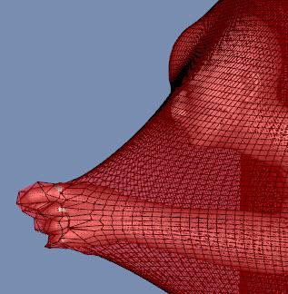

    m. For the pose I used, the hand presses forward and stretches just a few polygons giving a triangular look to the film. One way to correct this is to use a product like MeshGrabber to move any offending vertices to a more suitable position. You will need to do this after every simulation.
    n. Another way to correct this is to use an animated sphere so more polygons are located by the hand.
    1. Create a 5 inch sphere with 16 sides and 16 divisions.
    2. At frame 0, position it so it overlaps the figure’s leading hand. Click on the +key to set a keyframe.
    3. At frame 15, reposition the sphere so it is over the moved hand. Scale it down so it is just larger than the hand (I used 80%).
    4. Run the simulation.
    5. The sphere keeps more polygons near the hand and avoids the jutting polygons. It does mean the head doesn’t project as much at frame 15 so I picked frame 12 to render as it gave the best overall look.
    ETA: You can leave off the weight map, scale down the plane, and use a more extreme figure movement to get something like this:
    486 x 486 - 131K
    420 x 531 - 24K
    393 x 537 - 21K
    291 x 286 - 28K
    254 x 243 - 7K
    225 x 188 - 7K
    317 x 324 - 50K
    600 x 800 - 119K
    600 x 800 - 124K
    800 x 640 - 121K

    92. Putting Goggles Straps on Over Hair
    When you use an item such as goggles on a figure with long hair, you would expect the person to put the goggle straps on over the hair rather than take the time to pull the hair out and over the goggle straps. You can use dForce to do this. This approach could also be used for headbands and scarves that are wrapped around the hair.
    a. Load a Genesis 2 female figure (I use G2F as it is faster to load). Add a hair. I used Kyle Hair
    b. Load the helmet from Pilots Uniform of WWII. Go to the parameters pane and set GogglesUp to 0%.
    c. We only want the goggles, so choose the Geometry Editor in the Tool Settings pane. Right click in the viewport and select geometry Selection/Select By/Face Groups/Helmet. Right click again in the viewport and select Geometry Editing/Delete Selected Polygon(s). That will leave the googles without the helmet.

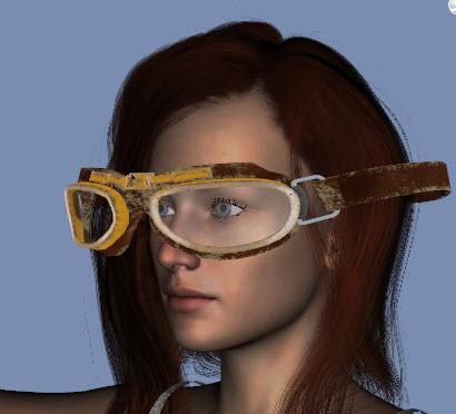

    d. Position the goggles over the eyes of the figure. Go to frame 10 on the animation timeline and add a keyframe by clicking on the +key icon. Go to frame 0 and scale the goggles to be clear of the hair. I used Scale 95%, X-Scale 175%, Z-Scale 138%.
    Frame 10: note goggle strap under hair which is the default
    Frame 0: goggles scaled to be clear of the hair

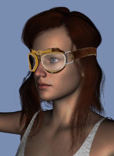

    e. Add a dynamic dForce modifier to the hair.
    f. Add a dForce modifier weight node to the hair.
    g. Select the Node Weight Map brush in the Tool Settings pane. Add an influence weight map.
    h. Hold down the Alt key and use the paint brush to remove influence weight around the top of the hair above the goggles. Paint with the brush so the color changes from red to purple. This will keep the hair in place on the head while allowing the hair with a red color to change with dForce.
    i. In the Simulation Settings pane, set Gravity to 0. We want the movement of the straps to change the hair, not gravity.
    j. Run an animated simulation.
    k. If you look at the right eye, you’ll see hair is partly locking the eye. Not good for a pilot! We can use a helper object to pull the hair aside.
    l. Create a thin torus large enough to go around the lock of hair we need to move. Use the geometry Editor tool to select half the torus and delete those polygons so we have a hook. This is so we are moving the front hair and not the hair on the side and back of the figure.
    m. At frame 0 position the torus half at the front of the face. At frame 10 set it so it is pulled back.
    n. Run an animated simulation.
