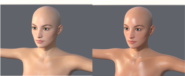

    here a skin test from me. I think a little to much reflection but not to bad :)
    1. normal shader
    2. modified
    2000 x 825 - 949K
    The focus of the thread is hairstyles more than skin. If you have any good settings for it, let us know.
    Still, I will say your modified skin looks a bit too plastic. Definitely needs a little work.
