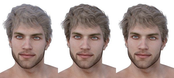

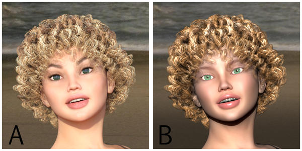

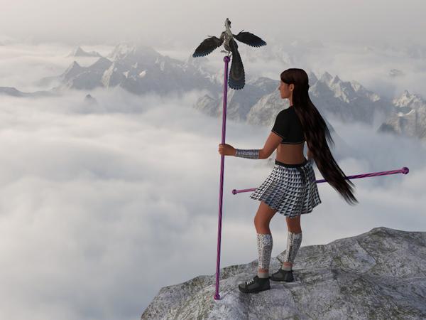

    My favorite result of something I worked on personally is this one.
    Combination of the right lighting and adjustments to the texture.
    800 x 768 - 802K

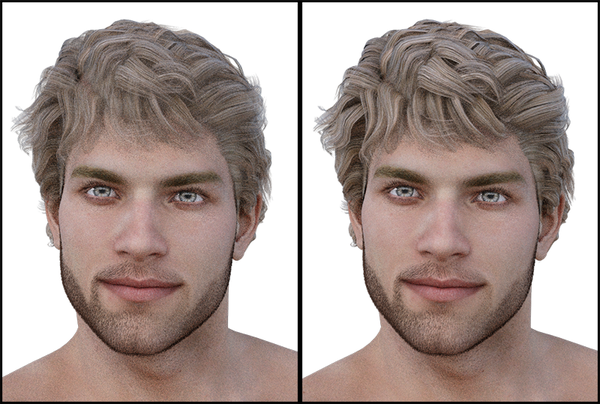

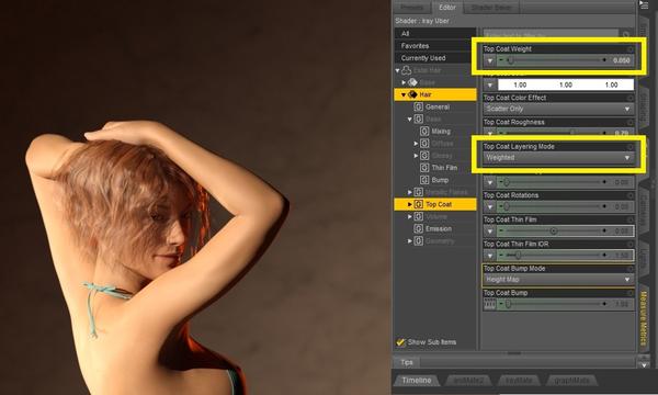

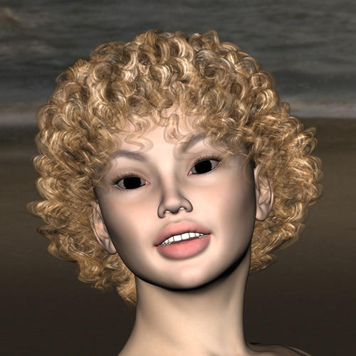

    Toyen said:
    Here is my result:
    I like how softer the hair appears and the translucency but I can´t get the glossiness right.
    For that you could try and add a Top Coat to your hair (if you haven't already) and then set "Top Coat Layering Mode" to "Weighted".
    Using "Top Coat Weight", you can control how much light is reflected back from the surface. A value of 0.05 f.e. means, that 5% of the incoming light is reflected.
    1080 x 648 - 161K

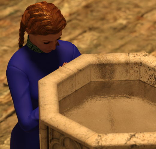

  • SloshSlosh Posts: 2,391
    I have been tossing back and forth for a few days on whether to reply to this thread or not because I don't want to come across as opportunistic. I have a hair shader product coming out for Iray "soon"... it is through testing and just waiting for a release date. It comes in 24 colors, 2 versions of each (wide textures and narrow textures, depending on the hair it is applied to), and there are several settings to compensate for glossiness, shine, and transparency issues. Basically, the shaders replace the original hair textures with my custom textures, but leave the original transparency maps. The reason I did this was so that I could match my bump, displacement, and glossiness maps to the textures. I won't derail this thread with excessive details, but here is just one of the promo images...
    1000 x 1300 - 998K

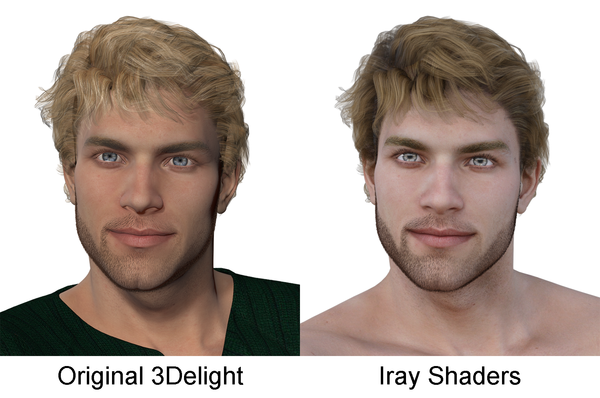

     3Delight to Iray Conversion - Transparency Maps: On a transparency map grey basically equals translucency...and with 'natural' translucency the 'extra' from the grey areas on the map will make it almost 'not there', it's so translucent/transparent... Option: Convert to the Iray shader and then turn the opacity up to more than 1. Also: Set the material for the hair strands to the Iray base material then reset the the Cutout Opacity to a value of 2; and yes, big difference. Add a displacement map (basically the hair bump map) then set SubD to a value of 3 and the hair looks to have even more depth.
    3Delight to Iray Conversion - The Lighting Model: This adjustment option works more for the benefit of 3DL as the settings no longer appear in the surfaces editor after converting a shader to any of the Iray ones. Just a quick note on this; the primary effect the Lighting Model has is to change the way the material is auto-converted to Iray. So, it's not useful in Iray, but if you change the Lighting Model before converting, the conversion will be different. This also helps if you are leaving your materials in their standard mode, but you want them to behave a little better in Iray. (For instance, I changed a wallpaper from Plastic to Matte, because when it was Plastic the autoconverted material was reflecting a nearby light. Once I changed it to Matte, the autoconversion no longer made it as reflective.)
    3Delight to Iray Conversion: The modeling of the hair makes a huge difference. Some works just fine out of the box, others, not so much. One thing we tried, mostly successfully for hair that don't work out of the box, is to use two instances of the hair, scale one slightly differently (Larger or smaller depending on the hair) and add a little translucency. Instanced using the same maps should add little to the weight of the scene. As for the "scalp" it looks like the best Cutout Opacity setting is between 0 and 0.1. The hair looks best with the higher Cutout Opacity--set at: 3.0--even though it looks more plastic (not using a translucent echo).

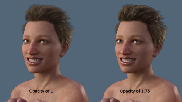

    Cutout Opacity: In situations where the Opacity map just seems blurry, you can sometimes use a quick sharpen filter (Photoshop or GIMP). You will see hairs, not just hair. What may be going on with the uber-transparent hair: Transparency maps were no longer being auto-corrected for gamma. So, you may want to try manually tweaking/shutting off the gamma correction on the transparency maps. The results are consistent with the maps being grey instead of black and white.
    Opacity Maps: This could have something to do with the 'blacks' of the trans map not truly or fully black and the whites not being fully white for that matter. There was mention of the incorrect gamma being applied to the trans map by default; shunting blacks to a gray shade which would make more of the geom transparent. Note: trans maps that go in as jpeg are assumed to have gamma 2.2 applied and are not corrected by iray, something along those lines. HDRs stay at gamma of 1.0.
    Regarding Transparencies: One fairly easy thing I've done is to go into Cutout parameter settings, disable limits, and then set cutout opacity to 1.5 or so. This effectively makes the map scale higher, and, thus, become less transparent/cut. (You can do the same in Refraction, if that's your method of choice, or whatnot)

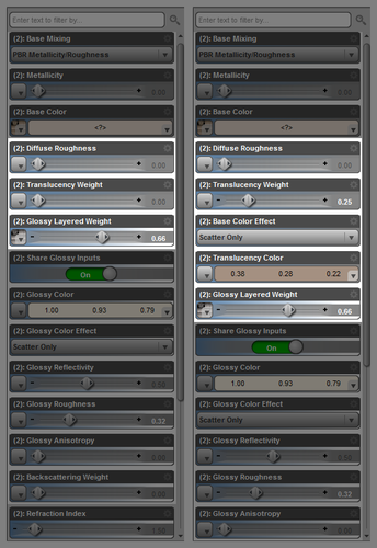

    Nice compilation, thanks. But I found some errors, the ones marked in red. The color black, or "0" as given, would rather be (H 0, S 0, V 0), since (H 0, S 0, V 255) would be plain white! If someone not that experienced would put that into the "Emission Color" parameter, it will make that hair an emitter. I'd also recommend to better either use common sRGB (0 - 255) or linear space values (0.00 - 1.00) to list the respective color values for the R, G and B color channels. Hue, Saturation and Value are rather seldom used. The one marked in green are defaults, and for that reason I wouldn't explicitly list them. Dropping those would make a parameter value listing less "wall-of-text" and IMO easier to read and work off.
  • L'Adair said:
    I have OOT's IrayPair Hair Shaders, but I have a number of hair items that don't work well with it. I really appreciate having all the settings in one place, where I can refer to them when the hair shaders don't give a satisfactory result. (Loved this so much, avmorgan, I put it in a Word doc and created my own pdf of your post! Thank you for the effort.)
    That's basically what I did, then I came back here and dropped in the whole summary. laugh
    Oooo. Glad you caught that. Obviously, I copied the original verbatim; that's exactly the kind of thing I'd follow to the letter and go crazy trying to figure out what I'd done wrong! cheeky I corrected the blacks to rgb (they seem to have been redundant even as HSV values in the original, but I'll leave the clarifications in) I also cut out the defaults you recommended. Thanks!

    Sometimes, when you apply the Iray Uber Base to a 3delight material, the Emission Color parameter will automatically receive a RGB 255,255,255 color in the process. The Fairy Queen: Dynamic Royal Dress is one of them f.e. Barely noticeable in bright daylight, but in dim lighting the dress "starts" to glow in a "Clash of the Titans" fashion (the one from 1981, not the remake of 2010). That's why I became accustomed to always check the Emission Color parameter after converting a 3delight material into an Iray one. smiley
    Most of the time I use MEC4D's "Unshaven 2 for Genesis 2 Male(s)" presets and multiply bump strentgh by 10.
  • Arnold C said:
    Been there, done that. cheeky And then I wondered why in all heavens would someone make the head of a figure turn into a lightbulb. laugh
    I have not run into the emission conversion glitch, but I appreciate the tip! There are a few iray hair shader presets I'll use for convenience; f.e. the ones in Subsurface Workshop - SSS Shaders for Iray, as well as Mec4D's Unshaven 2 for Genesis 2 Male(s). I'll remember the bump multiplication--half the time I seem to forget to adjust that. The thing that got me to tinkering with hair shader settings was my desire to make better redheads--and even blonds can be hard to get right. Mostly, I want to see the right interactions with my lighting, so I play with the translucency, transmission and gloss quite a bit.
  • BookieBookie Posts: 82
    These are my tests regarding hair and IRAY. Hope the picture is self explaining.
    1280 x 505 - 170K
    Seems mostly it's the texture quality and then the light settings. I just save as a shader preset the settings for a hair that looks good in iRay & then apply those shader settings to a hair that doesn't look as realistic. Different iRay settings though can change which hairs look good and which don't. Sometimes iRay settings and shader settings just aren't enough to make a hair realistic for iRay.

  • AngelAngel Posts: 1,204
    edited February 2017
    I didn't read the whole thread so if this was already mentioned. Sry. One of my favorite tricks to the double up hair props. (Half the opacity but 2 wigs) Resulting in double the strands, double the morphs and twice the volume. Making them appear soft, and silky. Rather then looking like straw, or wood.
    Examples Below
    Post edited by Angel on
  • kyoto kidkyoto kid Posts: 42,408
    ...nice work.  The first two are totally adorable.
    I've done this myself a couple times.
  • nelsonsmithnelsonsmith Posts: 1,337
    Examples Below
    Thanks!  That's a great tip and some fantastic renders.  Can't wait to try it out!
