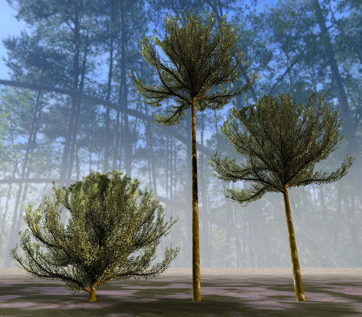

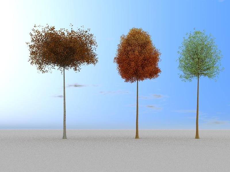

    This is an experiment. Bryce trees usually have short trunks and are difficult to use in a forest. When adding a cylinder the roots come in the way. They can be made transparent using a simple texture in channel D. Here, I used an Arbaro tree and instanced it twice. At left the original, in the centre and at right with a 40% tapered cylinder as long trunk. There are no roots but the trunk gets wide at the end. This part was made transparent. If you compare the original at left you can see at what position the tapered cylinder was added using the same material except the texture in channel D. The backdrop is from an HDRI I made a few weeks ago and shows how thin and long tree trunks can be in a forest.
    Long Trunks

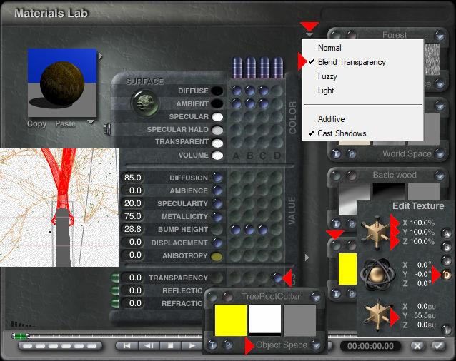

    If you are interested in the subject, here are the steps (reading takes much longer than actually doing it):
    Mat Lab
    1. Select the Bryce tree. If you use an object tree (here Arbaro), select the trunk, skip step 2 below and enter the Mat Lab.
    2. For a Bryce tree open the Tree Lab, click on lowest Edit button at left (Branch/Trunk) to open the Mat Lab.
    3. Put a dot in channel D of Transparency, this creates a random texture.
    4. Open the Material Options (on top) and enable Blend Transparency.
    5. Open the DTE from the random texture in channel D.

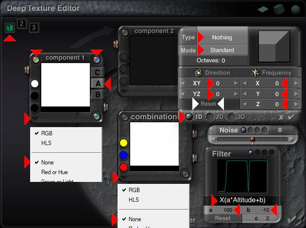

    DTE
    1. Keep only component 1, set the colours as shown (white/black/black).
    2. Set the Color Mode to None, also for combination.
    3. Enable only [A]mbient (no [C]olor, no [B]ump).
    4. Open the Noise Dialog.
    5. Click on Reset (white arrows), all settings are now as shown (red arrows).
    6. Open the Filter Dialog.
    7. Set the values as shown (red arrows). Note: a and b are a bit difficult to adjust. Go as near as you can, release the left mouse button then press it again and adjust, repeat.
    8. Accept to get back to the Mat Lab.
    A. Set the Texture Mapping Mode to Object Space.
    B. Open Edit Textures and set X/Y/Z each to 100% (top).
    C. Set Y (bottom) to 75BU for Bryce trees (here 55.5 for the Arboro tree shown above). Note: increasing Y narrows the transparent range, decreasing enlarges it.
    D. Exit the Mat Lab.
    - Create a Funnel / Cylinder Tapered (Objects > Installed > Additional Primitives) and give it the same material as used for the trunk, except channel D.
    - Adjust Size X and Z so that the upper part matches the size of the trunk (can be a bit fiddly).
    - Adjust Size Y to get the desired length, then move tree and cylinder so that the cylinder joins the still visible trunk.
    1200 x 1050 - 327K
    638 x 506 - 75K
    630 x 470 - 49K
    Post edited by Horo on

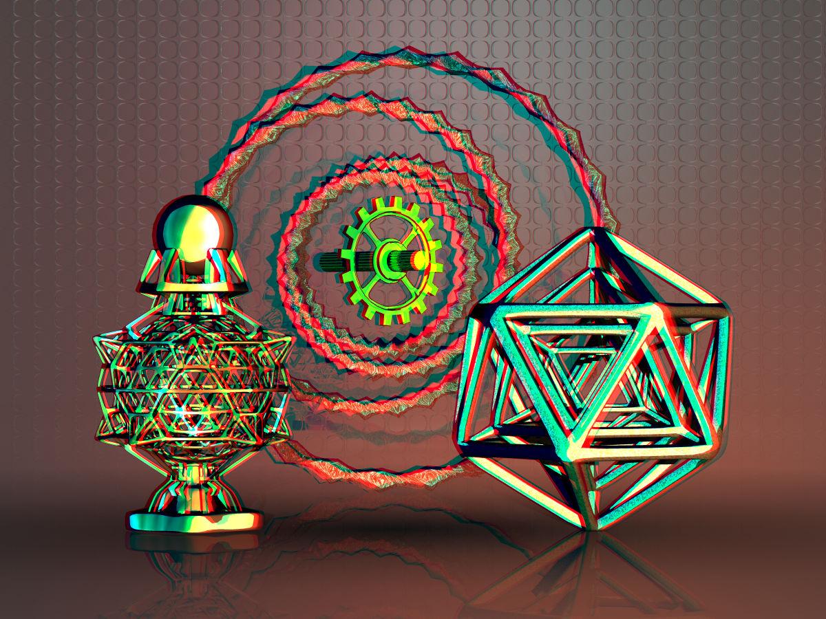

    The objects left and right are by Steven Ray, the cogwheel by David Brinnen and the spiral comes with Bryce. The materials are self assembled. The objects stand on a fading disk and everything is within a cone with some transparency and a pattern from Stylised Rendering. The negative specularity by the self made Burns HDRI, the positive specularity by the sun.
    Some Objects
    And here the anaglyph.
    Some Objects Anaglyph
    1200 x 900 - 276K
    1200 x 900 - 319K

    Superb setup and render, Horo  nice material and lighitng, the anaglyph is awesome.

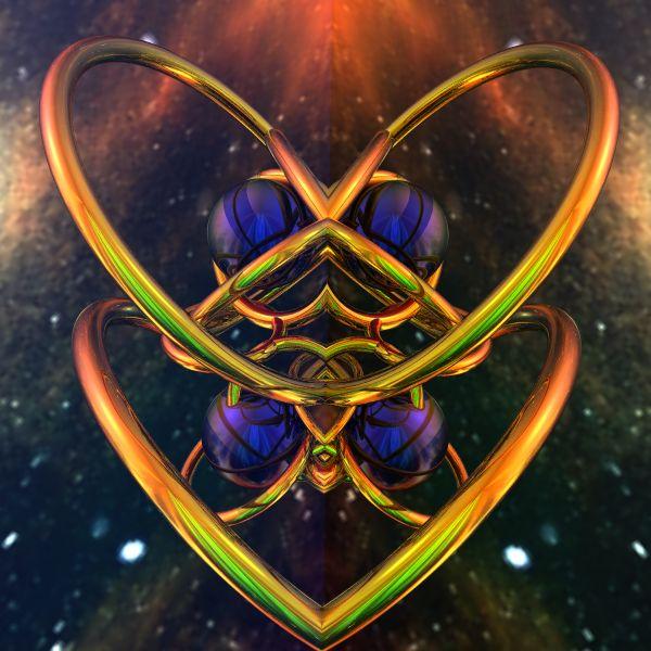

    A simple abstract : a few tori,spheres, a plane and a HDRI sky.
    600 x 600 - 84K
    Post edited by adbc on

    adbc - thank you. Looks like intertwined golden hearts, beautifully done.

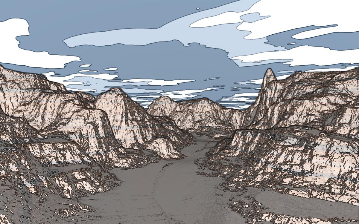

    CEL Shading and Drawing Effects combined. The terrain is from the Crater Construction Kit (author unknown) rendered several times, except for TIFF4816 (free on my website under Documents) to convert a render into a terrain, everything was done in Bryce. First CEL (Contour Enhanced Lines) Shading after Stylised Rendering and then after Drawing Effects - Specular Method (PDF on my website under Documents), finally all renders in the Materials Lab combined.
    Drawn Scene
    1200 x 750 - 233K
  • HansmarHansmar Posts: 3,180
    Very nice drawing like render, Horo!

  • mermaid010mermaid010 Posts: 6,156
    edited November 2021
    Cool drawing effect render Horo.

  • HoroHoro Posts: 11,525
    Thank you Hansmar and mach25.
    mermaid - thank you. That abstract came out very nice.
  • adbcadbc Posts: 3,115
    Horo : awesome drawing, sky and terrain are in perfect harmony.
