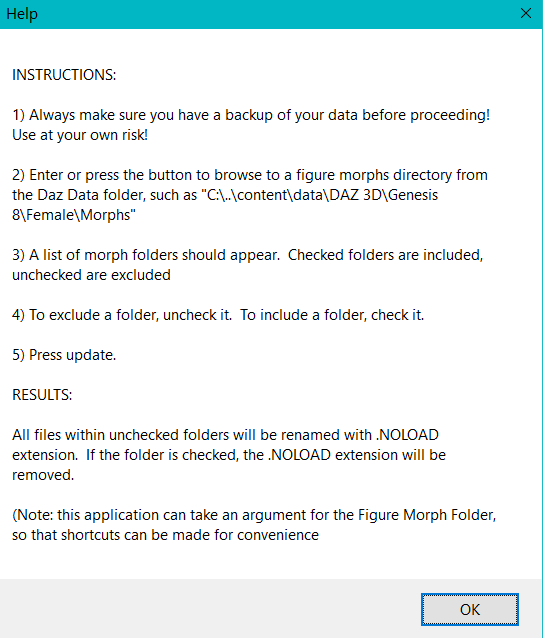

On my freebie page linked in my sig, I made a small utility to turn off morphs, by adding a .NOLOAD extension to the morph files.  You choose the figure morph directory,, and it lists all the subdirectories.  You then deselect folders that you do not want to load.  When you press update, all files within those de-selected directories will get a .NOLOAD extension added.
If you want to add them back, just check them, and they will get the .NOLOAD removed.
- (NOTE:  The below post on its usage from Catherine3678ab is incorrect, another explanation and use case is given further below, if it is not clear)
When you open it again to that directory, it will identify the folders as either being checked or unchecked by the presence of the NOLOAD file extensions.
Basically simplifying a tedious method to turn on and off morphs.  There are a lot of figures I just never use...but dont want to worry about uninstall/reinstall...
It does accept a command-line argument of the Figure Morph folder, so you can make a shortcut to it to open right into the G8F Morphs folder, for example.  Then shortcuts to other figures, etc.
There are much better solutions Daz or other probably could provide, but maybe this will help someone?  It does what it does, I probably won’t expand too much on it, as it works for me.  It decreased my load of one of my scenes from 6 minutes to 1 minute 10 seconds, by not loading a bunch of figure morphs I rarely use.
EDIT - Updated picture
EDIT - I dont see the picture anymore, so I added it in the post...delete image function appears to be broke.

    Installed! Shortcut to Desktop! Will try it out next time D/S is open :-) Thank you :-)
    update: So glad I read those instructions first! I thought the selection process would have worked the other way 'round ;-)
    Also: um, once we have unchecked a folder the files will be renamed with .noload extension.
    BUT next time 'round then, all folders that were unchecked will be excluded from the list ERGO there would be no way to check them to have that extension removed. hmm ... no thanks.
    2nd update: isn't the English language wonderful. So now, all folders that were unchecked ARE included on the list, that's why it was said they would be excluded from the list, I dunno ... anyhow ... as long as the entire list of morphs reappears so one can check or uncheck all those morphs and then hit the update button, all should be well.
    Maybe there's a way to select a mass of them at once, I have a lot of morphs ... decided to simply rename the folder and move into a new morph folder the ones I want to use. Because yes, loading times decrease dramatically if one is not trying to load in a figure with many Gs of morphs!

  • 3dOutlaw3dOutlaw Posts: 2,481
    So...this above is incorrect.
    • If it has a check = you want the morph (i.e. it will remove .noload if it exists)
    • If it is unchecked = you dont want the moprh (i.e. it will add .noload if it does not exist)
    Example story of a person using this:
    Today I ran the script for the first time, and everything is checked.  I unchecked two folders, and pressed update.  Files in those folders got a .noload extension, and are no longer loading with DS!  Yay!
    ...24 hours later... (spongebob voiceover assumed)
    OMG, I changed my mind!   I started it up, and everything is checked but those two folders, as expected.  I re-added a check to one of the folders and pressed update.  Hallelujah!  The .noload is gone from the files in that folder and only the other unchecked folder is now excluded!  Sweet!

    Very happy to hear that. Because the way it was written it could be read the way I did. We would want "all" the morphs showing, checked or not, in the list.

    Hi, the amount of times it saves depends on the amount of morph folders (thus files) you uncheck, and choose not to load.
    As far as sharing the code...it is 95% Windows Forms interface, 3% overhead and 2% actual code.  You can probably do what it does with your own batch file.  Here is the secret sauce, so you can give it a go!  laugh  You can do this manually as well.  I literally just automated a suggestion from one of the other threads, because I was not going to manually rename, zip or move files...because I am lazy, lol!
    For each folder listed:
    • If (Folder is Un-checked) then:
      • Loop through files and add .noload extension to file
    • else: //Folder is checked
      • Loop through files and remove .noload extension, if it exists
    (there is a little more to it than that, but that is basically it...)
