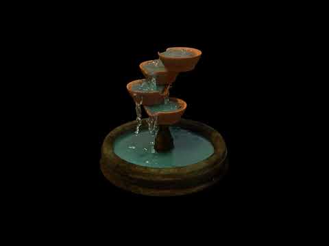

    Some more progress.
    I did manage to align the objects with the simulation and get a render.  Had to set the completion at 0 for frame 1 and at 100% at last frame.
    Despite my edits, the statue must have a hole.  Will double check the ears.
    https://youtu.be/Ld-xWfCmZ5U

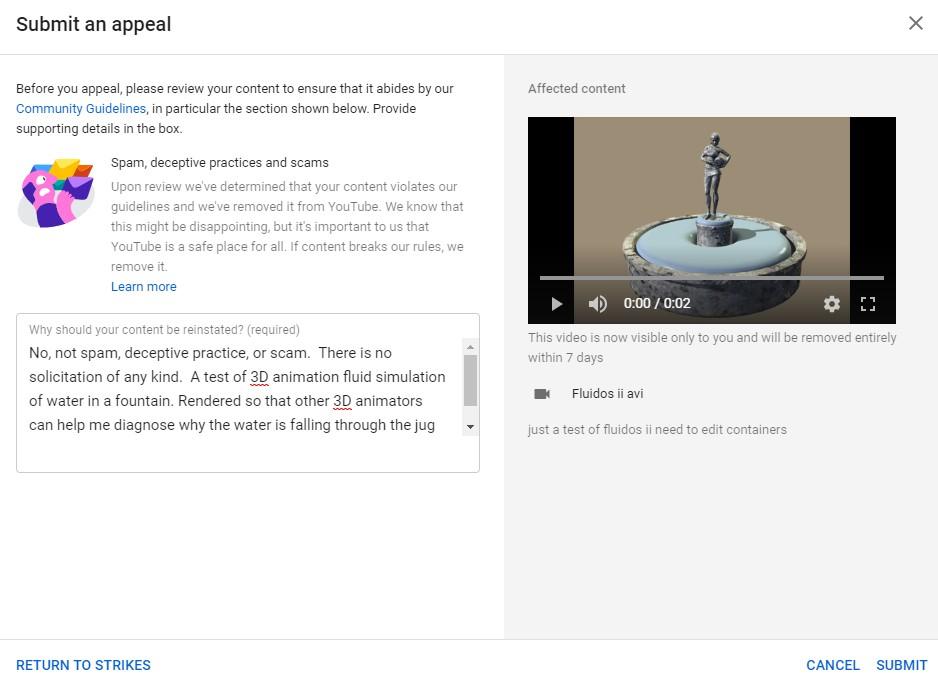

  • DiomedeDiomede Posts: 15,439
    edited April 2020
    Argh.  angry
    938 x 682 - 85K
    Post edited by Diomede on

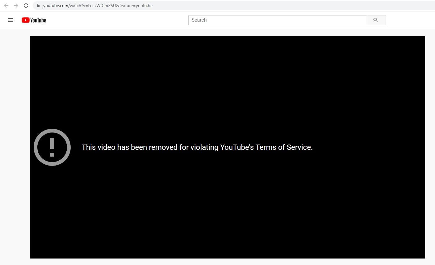

  • HeadwaxHeadwax Posts: 10,562
    Double Arghhhhhhhhhhhhhh :)
    This video has been removed for violating YouTube's Terms of Service.
    they have it in for you
    maybe just start with the water bowl and make it more complicated gradually by adding statue etx

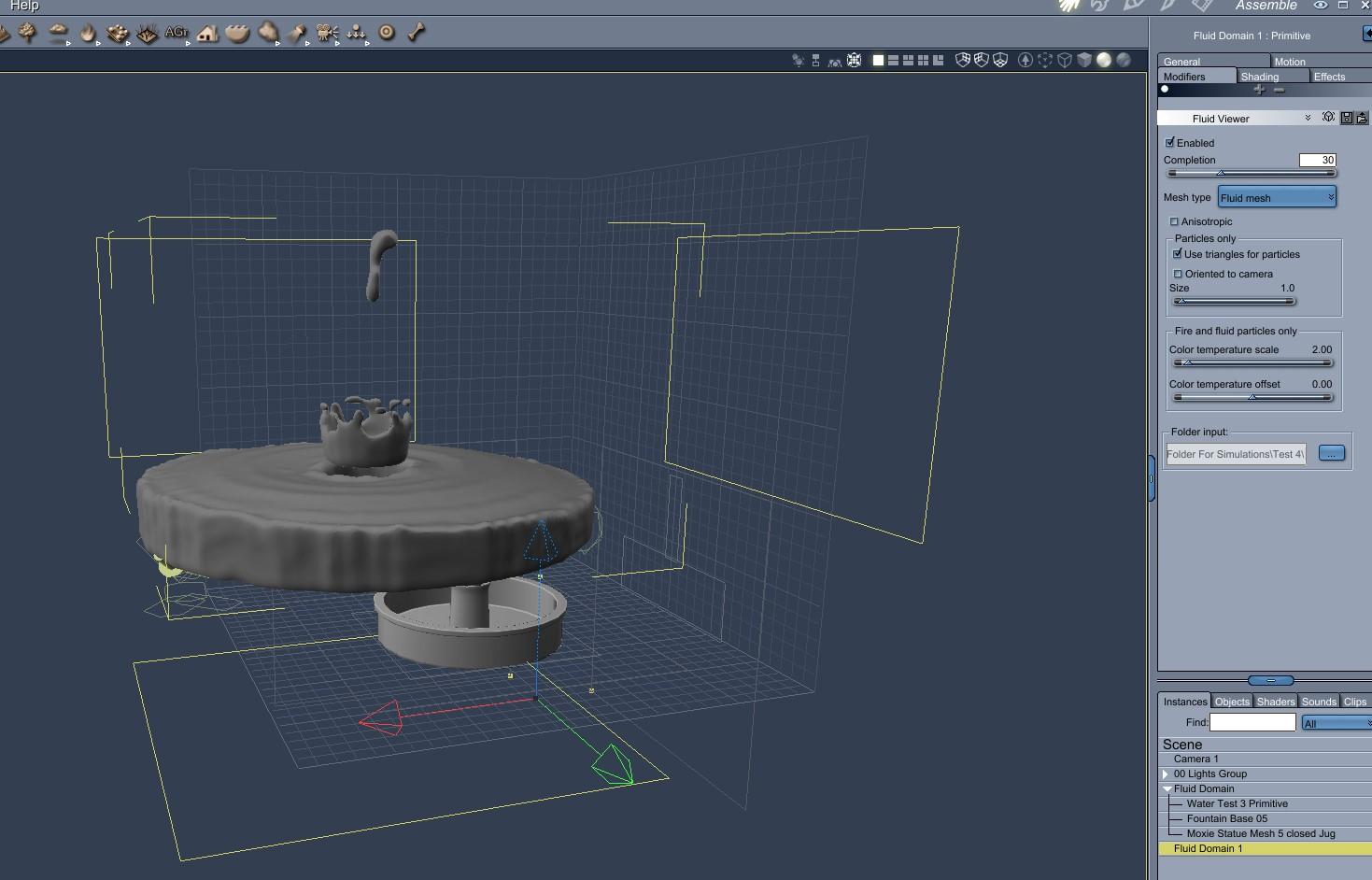

    Diomede said:
    Some Progress - But Not There Yet
    In this test, I can see the simulation by advancing the completion slider.  But its not linked to the sequencer or renderer.  Also, it doesn't fit the set.  I made sure that the original Fluidos domain and the Fluidos viewer domain were in the same location and the same dimensions.  Both were set at dimension scale 20x, 20y, 20z, and at coordinates 0x, 0y, 0z.  In the completion slider, the calculated fluid is a larger scale and different location from the original.
    But - you can hopefully see that the water in the base of the fountain did well and the water from the jug did well.  I will have to see if I missed a hole in the pedastal.
    How do I...
    - make sure the original fluid domain and the fluid viewer domain are aligned other than matching scale dimensions and x,y,z coordinates?
    - get the compeltion percentage in the viewer to advance with the sequencer for animation?
    attached are the completion  percentage at 15 percent increments
    Hi!
    How do I...
    Don't try to match the scale dimensions of the viewer. Change its scale or size only if you want a special effect.
    Be sure the tweener of the Completion modifier is a Linear one.
    Let me know if there is any other problem, please.
