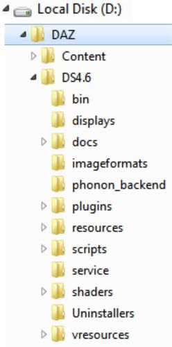

    I tested it the way I had it (and you hadn't posted and I'll have to read those posts) and this is what doing it that way looks like. (I'm studying the folder structure) so far as D goes.
    So what exactly should I do with this- suggestions?
    BTW, Content has Runtime (Geometries and Support)
    and Scripts.
    634 x 1277 - 70K
    1500 x 812 - 99K
    Post edited by Novica on
  • fixmypcmikefixmypcmike Posts: 19,714
    Yes, that looks fine.
  • JaderailJaderail Posts: 0
    Looks fine. Just point DIM to the Content folder for installs and your ready to go.

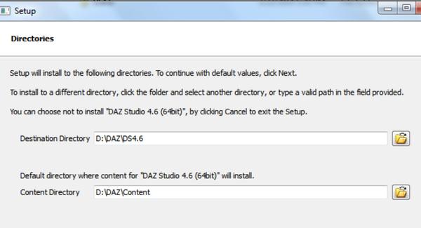

  • NovicaNovica Posts: 23,925
    Let me ask about the Studio first- I should just leave this as is, right? (showing the steps in case anyone else is interested in what I'm encountering.)
    1000 x 743 - 84K
    Jaderail said:
    The CMS is a System Process and IMHO should be allowed to stay on the OS drive. The CMS Database is only a text file and very small and if in default location much easier to fix when needed.
    Yes, leaving it there :) I read somewhere in the docs that it only increased in size slightly for every 5 products added, and the Content Management Service uses about 40k of RAM
    Novica said:
    Let me ask about the Studio first- I should just leave this as is, right? (showing the steps in case anyone else is interested in what I'm encountering.)Yes Leave as is...

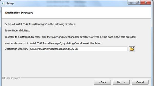

    Hmmm, I think I have a problem. (Well, I know I do.) I was fairly sure I had taken all references off from the previous DIM (including the C:\Users\\AppData\Roaming\DAZ 3D\InstallManager (which isn't on my computer anymore) but I am getting a funky Destination as I am going through the popups to install. Is that AppData still where the default installation is?
    Checking the whacky folder it is going to, it required Administrator and earlier, it wouldn't let me delete it, but I could delete the contents. It STILL won't let me delete it (even as Administrator) but there are no contents. I have done the App Data (see image) for the path. Is that right?
    1500 x 840 - 102K
    Or do I need to add a subfolder under that which says Install Manager? In other words, will it create one or do I need to have one in that destination path?
    edited March 2014
    Well, to test it I made one (InstallManager) and that was the correct thing to do. It didn't duplicate it and didn't put another subfolder (InstallManager) under it. So if you've screwed up your installation previously, just put what I had in the image above, but add an InstallManager subfolder and click to that destination. (if its still the default folder, according to this, which is where I got the information about it.)

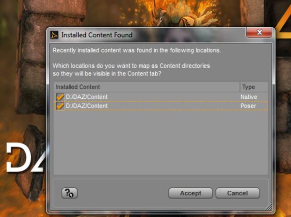

    For Path for installation, is that going to be D>DAZ>Content? It gives me a popup that says it contains files not installed by DIM (Has Runtime and Scripts) and suggests I use another folder by DIM or an empty one.
    And MJC1016 already answered that for Application (plugins,etc) that would be D>DAZ>DS4.6 and the DIM did it automatically.
