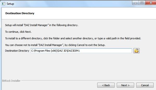

    Um.. Dim is a program and Not Data. If not in AppData/Roaming should work but the default install of DIM is to C:/Program Files (x86)/DAZ 3D/DAZ3DIM1 for the executable file, Appdata is for the Data files it generates...

  • NovicaNovica Posts: 23,925
    Okay, I'll uninstall and do it to the default install. That file name didn't look right, I thought I must've renamed something wonky and it was still recognizing it. :)

    And for those not computer saavy, aka, like me, if you mess up the installation of the DIM, just go to the bottom left to your Start options, click, and select All Programs, then under DAZ you'll see the option "Uninstall Daz Install Manager" and a popup will ask you if you want to delete it and all its modules. Done in about two seconds.
    EDIT: Here's what you should see, the correct destination folder that Jaderail mentioned. See image.

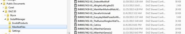

    Okay, so here's my question. Why, when I just launched the DIM, does it still have my products that were previously installed? They were installed to C>Users>Public>Documents>My DAZ3d Library, which no longer exists. Yet all my products are still showing as installed in this new DIM. How do I delete all of them- there's a lot of them!
    And under C>Users>Public>Documents>DAZ3d there is >Install Manager (with subfolders InvalidProducts, Manifest Files, and Settings) and I don't do anything with those/ think they have anything to do with it.

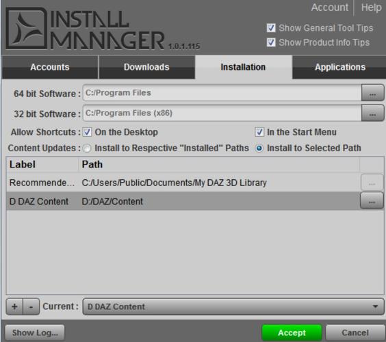

    In my quest to drive you all nuts, more questions. (Still doing DIM)
    On the Installation page, as mentioned by Fixmypcmike, I can go ahead and do D>DAZ>Content for the path. Here's what this looks like (to help others visualize it.)
    The question: What is the difference in Install to Respective Install Paths vs the Install To Select Path? I changed it to the Selected Path because I only want one installation place- but...
    1. can DIM install content to two different programs at once? Is that what the first option is for?
    2. would it make a difference if I only had one path, to leave the first option (the plural, paths) selected?
    (for people learning to do this, you go to the bottom and select + to add your directory/folder.)
    The second image shows you that DIM automatically selected where the studio was located for Applications.
    1000 x 945 - 74K
    1000 x 887 - 94K
  • JaderailJaderail Posts: 0
    If you have DIM set to install content to many folders for different Software. Not needed just for DS4.5+
    That Install Manager folder in documents is where Install Manager records what it has installed -- they are in the Manifestfiles subfolder. Delete the .dsx files in there and Install Manager will consider them uninstalled (you could also select them all in the Installed tab and have DIM uninstall them -- there aren't any files to uninstall, but it will then treat them as uninstalled).
  • fixmypcmikefixmypcmike Posts: 19,731
    Install to "Respective Install Paths" and "Selected Path" are for installing updates. The first option (the default) will install updates to the same folder as the package was previously installed; the second will install to the content location you currently have selecgted, even if previously it was installed in a different location. If you only use one install location it makes no difference. In my case, I install DS4, DS3, DS2, and Poser versions in different locations, so if a product has separate packages for different version of DS/Poser, they get installed to different locations. If that product is updated and all the different versions are updated, I can use the "Respective Install Paths" option and each update gets installed to the correct location, instead of having to change it manually for each one.
    BLESS YOU. :)

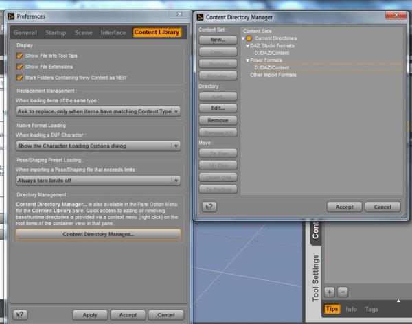

    Okay, in Studio- to sync up your DIM with the Studio, you just go to EDIT>Preferences, and select Content Library in the top tab. At the bottom, select Content Directory Manager and you'll see the second popup. The sidebar will tell you what to do, if the wrong path is there, just click on it and Remove. To add a new one, you would select either the Daz Studio Format or the Poser Format and then Directory-Add and select your path.

    Here's what those manifest files look like that fixmypcmike was talking about- the ones that I can delete to make the DIM understand that those products are no longer installed. If you don't delete these, (the products you deleted from files, like I did- I took everything off by erasing entire folders, but not using DIM) then they will still show up as being installed.
    EDIT: FYI- for 1,937 products, it was 35.3MB and only took 6 seconds to delete. Yippeee, off I go to customize the categories in the studio.

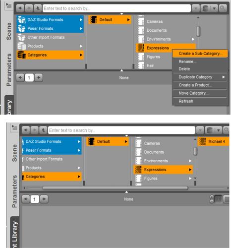

    Okay, click on Categories>Default.
    Right click and select Create A SubCategory.
    Popup appears. Name it Expressions. Click OK.
    Now you have Expressions as a menu option. Easy! :)
    edited March 2014
    Now let's put sub categories (M4, V4 etc) under Expressions.
    Select Expressions and right click.
    Click on Create A Sub-Category.
    The popup comes up and name it Michael 4
    Click Okay and you have a Michael 4 sub-folder under Expressions.

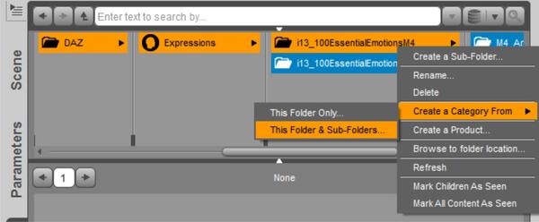

    Go back to the product location (Poser Format.DAZ-Exprressions) and select the 100 Emotions for M4. Right click.
    Select Create A Category From
    Because this product has quite a few options in the next sub-folder (hidden from view, look closely. It's options like anger, sorrow, etc) you choose the "This Folder And Sub Folders" so everything gets brought along.

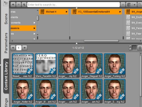

    Select Expressions, and M4 will appear as a sub-menu under it. select it and Accept and there you go, your 100 Expressions for Michael 4 can be easily found in Categories by going to Expressions>Michael 4. :)

    Here's the final screenshot. (showing Categories, it's too wide to get in the scrolling area.) Just repeat these steps and make a sub-folder "Victoria 4" under Expressions by right clicking and selecting "Create a Sub-Category" then repeat what we just did. You can also go under Poses and make sub-folders for all your figures too. Fast and easy to surf in to what you want.
