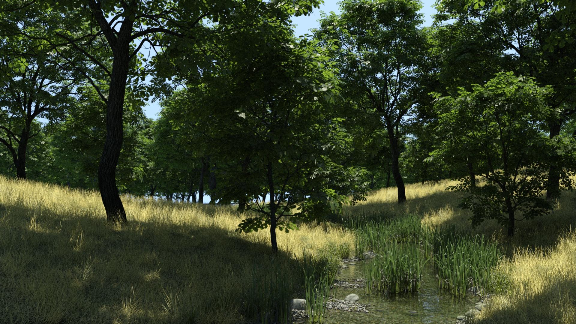

    I'm enjoying all the images everyone is posting here. I got the AM Brown Bear in fast grab the other day, so I put him in Harpwood 1 ecology with a pond.
    Great stuff!  Can I ask what you used to light this image?
    Cheers,
    Alex.
    Thanks, Alex. The lighting is the USC Late Morning render settings preset that comes with UltraScenery. My camera is pointed toward the back right of the scene, so I changed the SS Time from 11:30 AM to 4:30 PM, to get lighting on the bear's side of the pond. No other lighting or tone mapping changes were made.

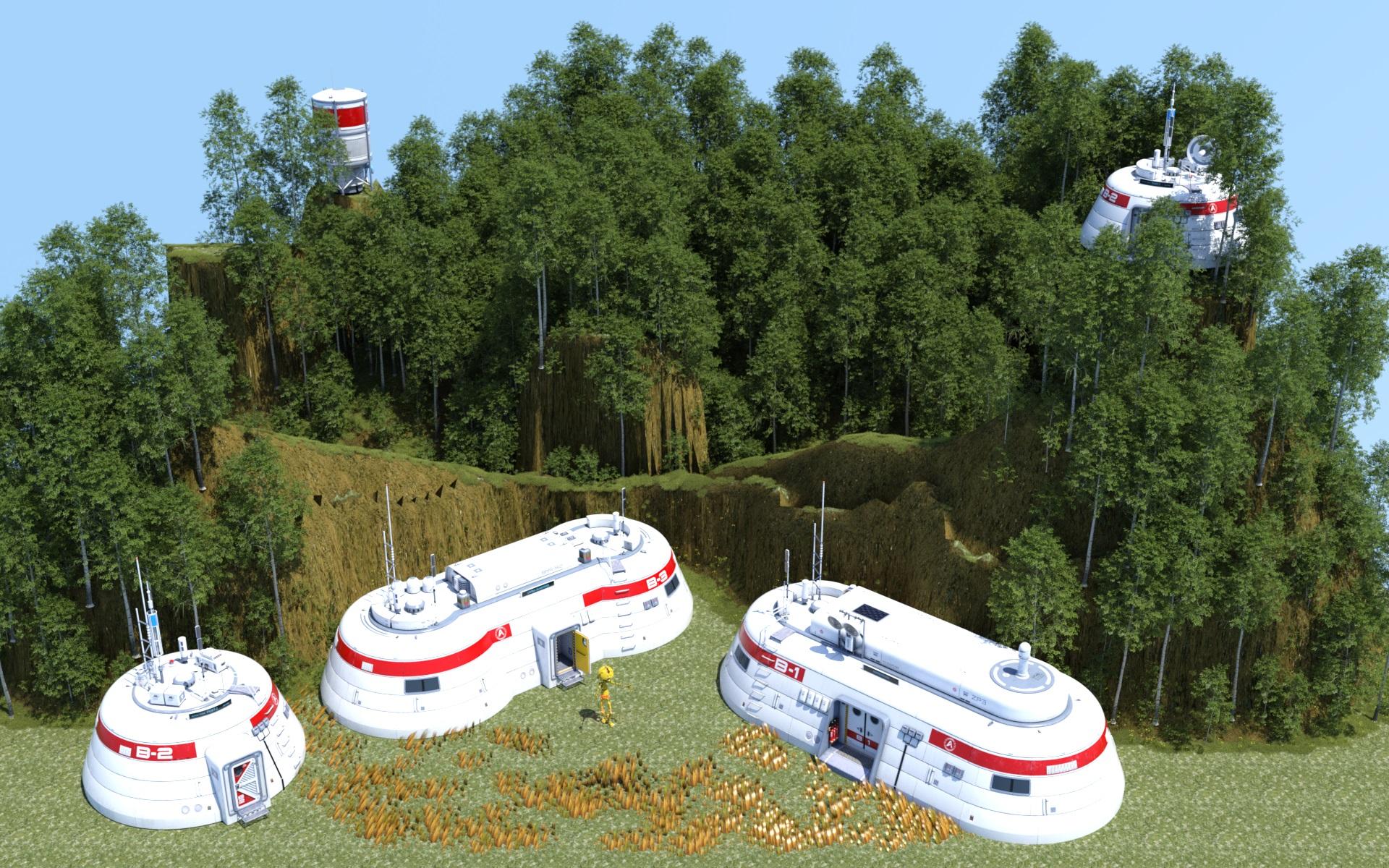

    I also think, that the possibility to create flat areas without vegetation in UltraScenery is one of the best and powerful features in it.
    Will wait impatiently for another update, then.

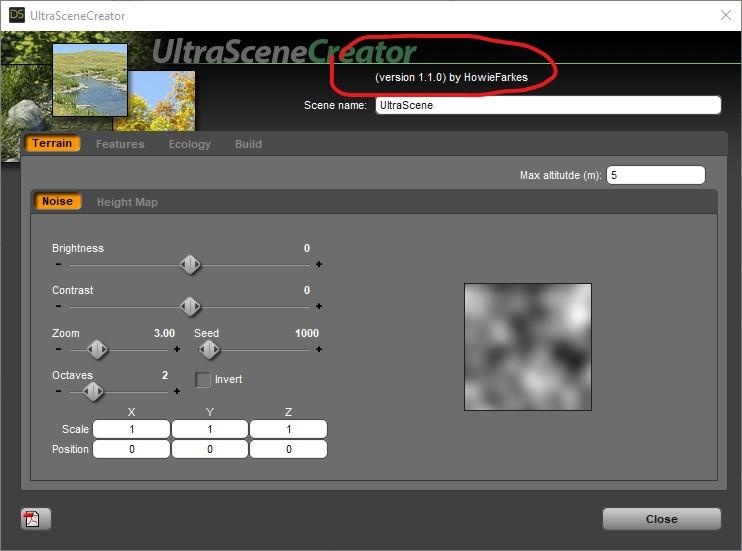

    Howie,  I manually download and install...how would I know if I have the updated one?
  • barbultbarbult Posts: 26,504
    edited June 2020
    3dOutlaw said:
    UltraScenery 1.1.0 looks to be available for download now. Most obvious change is the ability to have the script build the forest 200 metres past the bounds of the terrain to give some background depth. The rest is mostly bug and code clean-up.
    I'm not Howie, but I can tell you that there is a version number near the top of the script dialog box when you run the script.

    OK, that works, thanks.
    EDIT:  It's also updated in the PDF cover page, in case you want to check that prior to installing (located in Content\Environments\Landscapes\UltraScenery\Resources\)

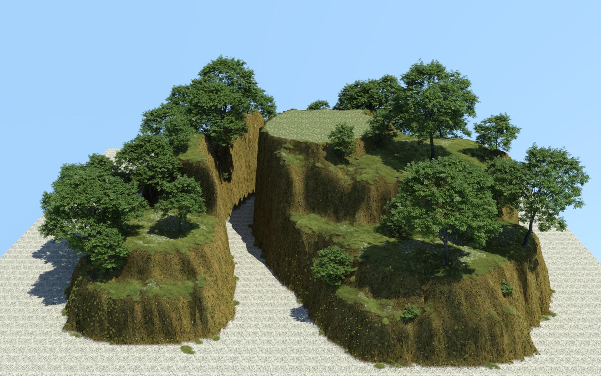

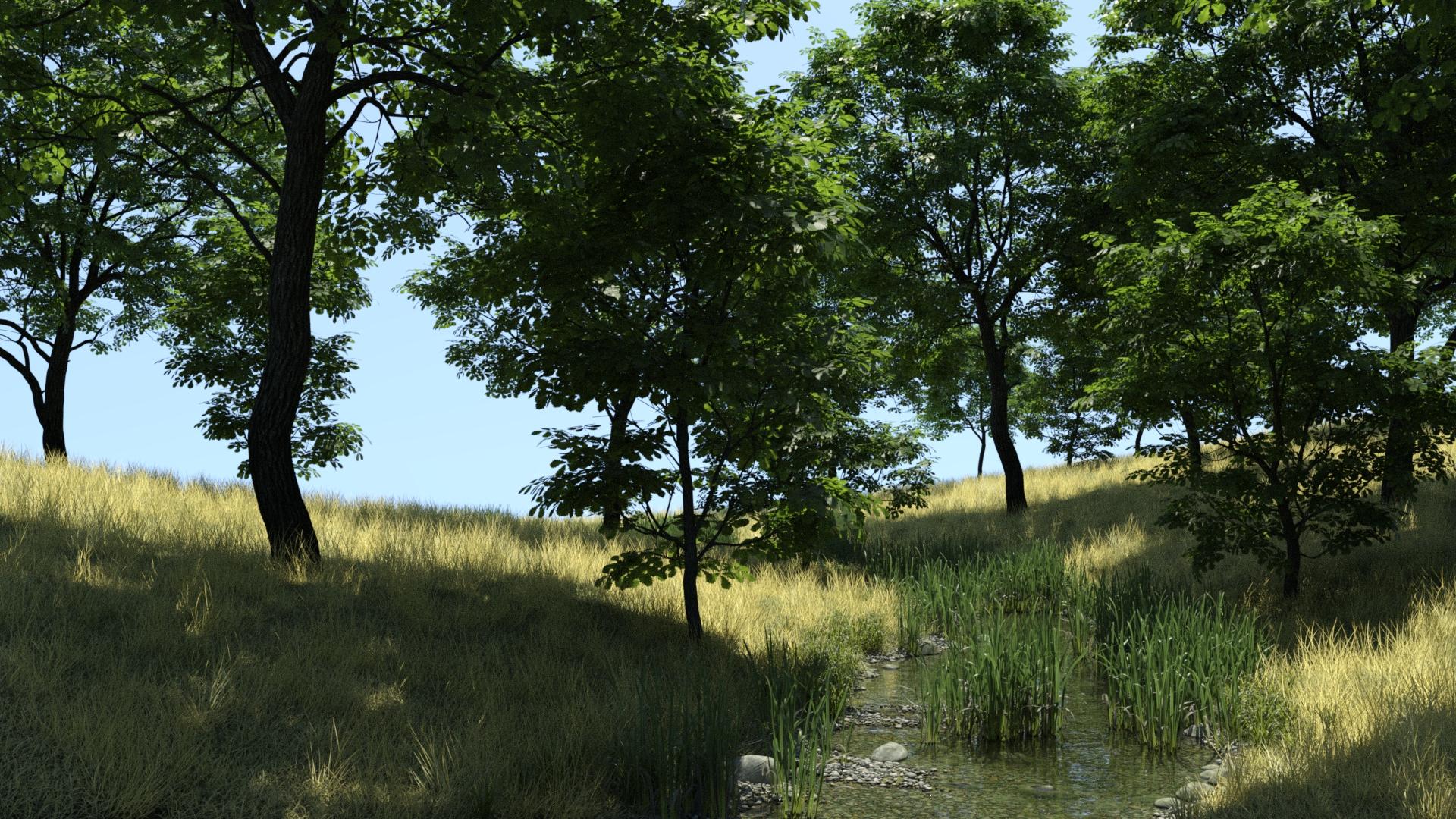

    Have you tried the new Extend Forest option on the build tab? Here is a quick example if with and without Extend Forest. I didn't render either one very long, so there is still noise in the shadows. This is Feature River 1 and Ecology Oaks 2.

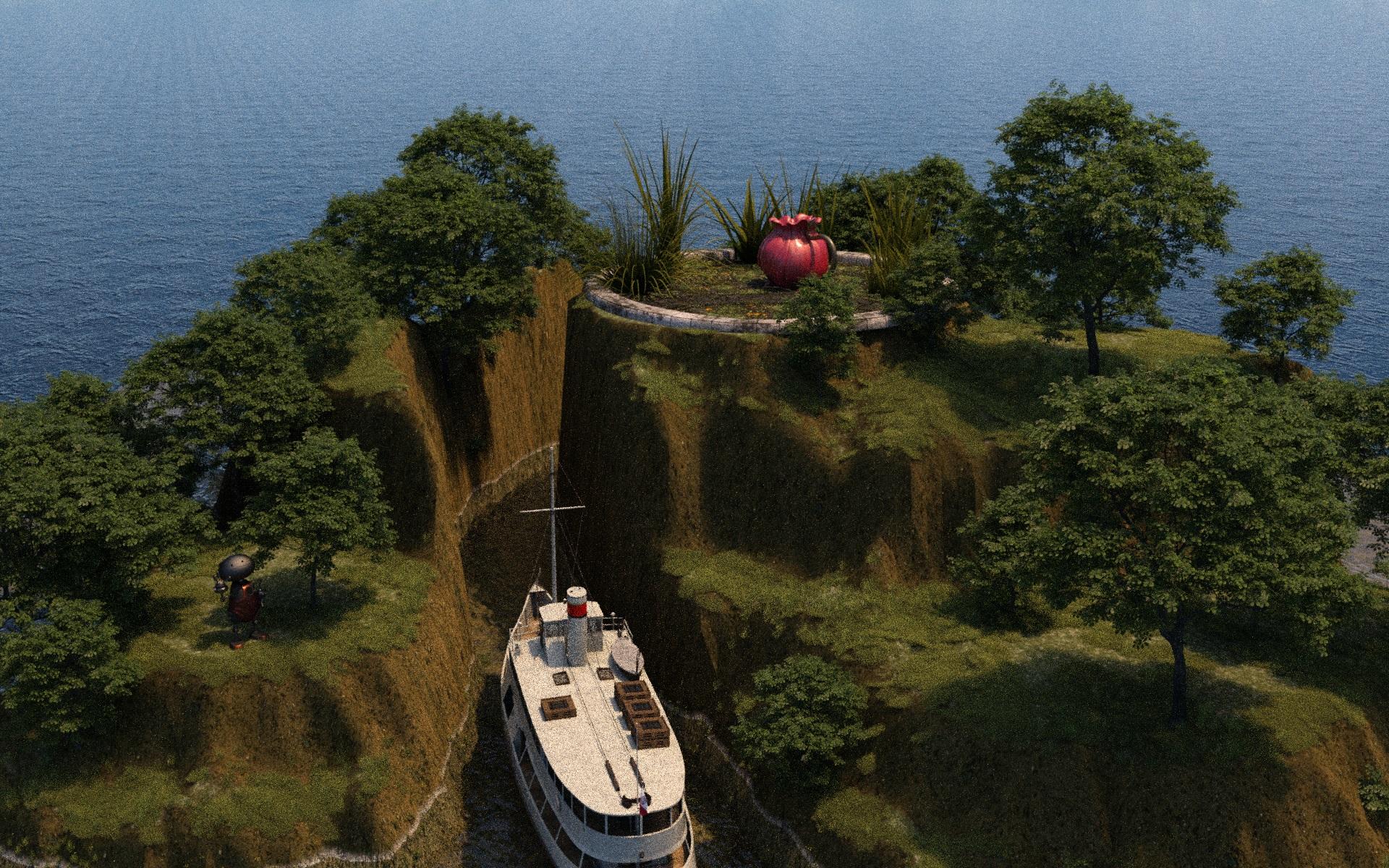

    I have created a height map for the island, but the rendering was so intense, that I have stopped it after 2 hours 12 minutes.
    The progress bar was still at 0% and my GTX 1080 has only made 141 iterations during this time.
    1920 x 1200 - 1M
    Post edited by Artini on
    It looks interesting. Do you think all the added items caused it to fall back to CPU? Or maybe that ocean or the boat were hard to render?

    It is a big difference in rendering time, when rendered only UltraScenery's generated terrain itself.
    Rendering Time: 12 minutes 8.83 seconds
    Below is the render made with the lights included with UltraScenery.
    I also attach the height map used to made the terrain.
