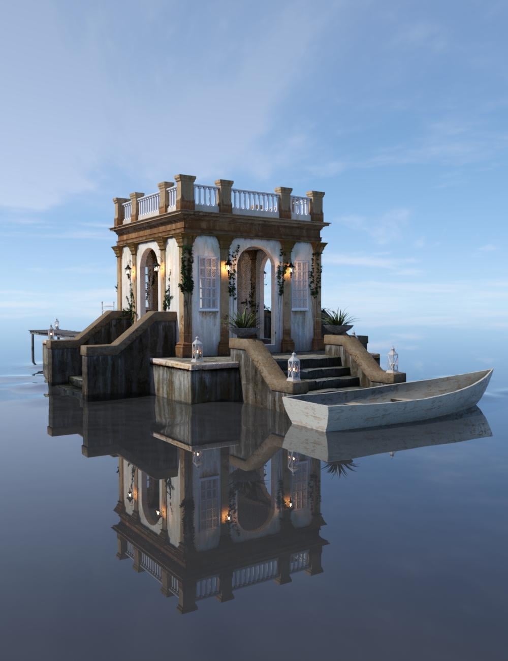

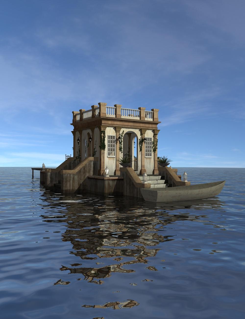

    Hmm.  a test shows the OP is correct.. Looking at the surfaces, I see no normal maps, but the 3dl surface has "lacunarity" and "octaves" settings, which control the amount and size of the waviness... The Iray material has no nornal map, either..
    Stock scenes -
    Iray:
    3DL:
    1000 x 1300 - 510K
    1000 x 1300 - 635K

    4.12.086 also does not render Lakeside Folly correctly in Iray on my sysstem.

    hmmm, 4.11.0.231beta also doesn't render correctly in iray.... so it's not the result from a recent change. 4.10.0.123beta did render it correctly as far as i can tell. added 2 images: 4.10.0.123beta and 4.12.0.86 (not beta)
    edit to add; filed a support ticket for this. Now just wait and see if there's something that can/will be done.....
    1000 x 1300 - 547K
    1000 x 1300 - 512K
