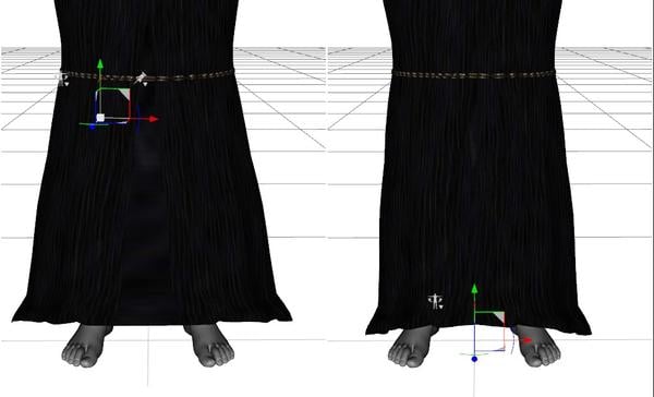

    Even if Gen4 dresses have some fit issues, such as stretches in the skirt, the fact that SRMS preserves the handles, which the regular autofit does not, makes it easy to make some slight bends to fix these issues.
    1000 x 607 - 86K

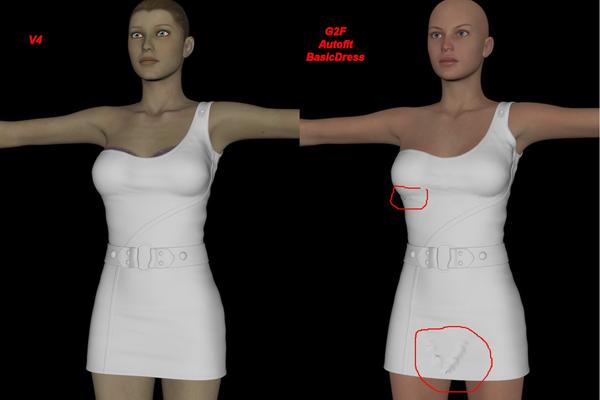

    I'm with a problem here, the images below rendered in poser

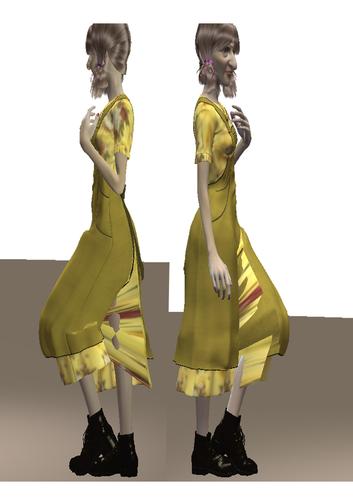

    The SRMS is a winner in my book. I used one of the toughest armors I have for V4 and M4, the Supreme Armor by Powerage. These are for Poser only and using them in DAZ Studio means a lot of work on the materials, displacements, and even the use of SubD on many of its pieces.
    The V4 shoes can't be used in DAZ Studio, I tried to get help at Separate V4 Shoes? but it wasn't going to happen with my current level of experience. The M4 versions of the shoes however don't have any issues and are even better to use on Genesis after conversion. They fit much better because they are wider, no poke through.
    The final result is a clean armor.
    Here is the finished armor. The metal and water shaders are by Phoenix22 available at ShareCG.
    900 x 900 - 407K

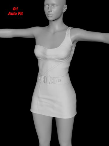

    I have been having some problems with Auto Fitting shorter dresses onto G2F. I have both the Sickle Rigging and Morphing System for Genesis and the Sickle Dress Rig Genesis 2 Female. To image below illustrates the problem. This is dress is Japanese Style Fashion Space Cadet V4. On the left I show it on V4 and on the right what is looks like when auto fitted to G2F. This auto fit was selecting V4 figure the dress was made for and Dress -> BasicDress as the type. I have tried the Knee Length Dress and V4 Skirt with the same result. I have circle the V shape intention in the dress between the legs and there are some minor problems under the breasts too.
    I'm wonder what is the best way of dealing with this. In the next post I will show the best I have been able to do.

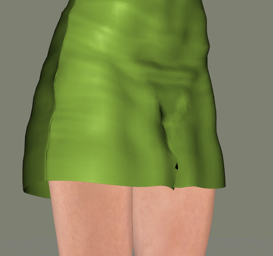

  • mark128mark128 Posts: 1,029
    The best I have been able to do is to use the Transfer Utility method. I enable the "Near Vertices" option and increase the value to 1000%. This produces larger, more spread out V shown on the left in the image. On the right is what happens when I up the smoothing modifier to 20. It has mostly smoothed out the V shape.
    I don't like using smoothing modifiers at 20 iterations. They sometime cause the clothes to blow up and they are slow.
    The only other thing I've found that might work is to send the dress to Hexagon and push the mesh around to get rid of undesirable indents. I'm not very good at Hex, but I was able to push the mesh around to create a morph for the dress that mostly got ride of the V. It was just a lot of work.
    Any better ideas of what I could try?

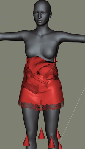

    One additional note, this problem is worse on G2F than on G1 with this dress and most of the other dresses where I have seen this problem. This shows the same dress auto fit to G1 Female shape.
    750 x 1000 - 37K

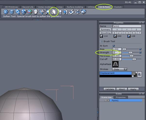

  • FistyFisty Posts: 3,416
    Bridge to Hex, run that over a few times til it's nicer (be careful around the edges and fold-overs, you night need to do a little manual vertex pushing there instead) Bridge back to DS, save as a morph and leave it on, or delete G2, export the dress as an obj, then load another g2, load the now g2 shaped dress, and run the transfer utility on it again.
