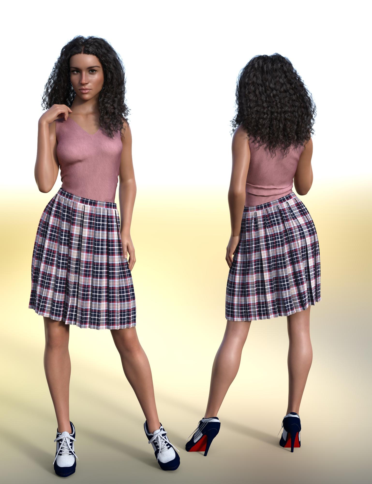

    Here is my pleated skirt (box pleats). This was imported from Marvelous Designer and simulated in Daz Studio with dForce.

  • PhilWPhilW Posts: 5,162
    @barbult That's lovely!
  • barbultbarbult Posts: 27,515
    Thanks, Phil. I really struggled with those pleats. Even though the pleat fold tool has 3 pleat type options and either 2 or 3 internal lines per pleat, the pleat sewing tool always seems to sew in 3s and box pleat was all I could coax out of it. But it did come out nice. I was surprised how well it worked in dForce. I expected the layers of the pleats to cause explosions, but I didn't have any issue. I think Daz has improved dForce quite a bit. I'm using DS 4.12.1.16 beta.

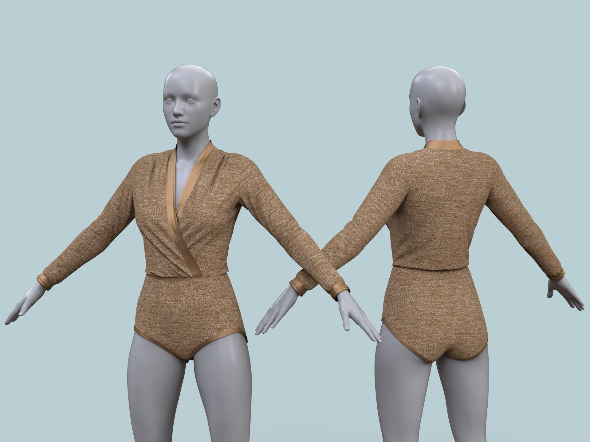

    I made this bodysuit for G8F. The learning challenges in this one were the pleats at the shoulder and the wrapped bodice. The bands that connect at the back to form the collar were tricky, too.
    Here is another version where I changed the fabric type in Marvelous Designer to a knit type. The previous one was silk charmeuse. The knit has a lot more wrinkles. I also added some internal lines in the bands and some "elastic" on the sleeve bands.
    @barbult You continue to impress - very nice designs.

    Barbult you have certainly got a flair for this. Some nice work here. Well done.

    @ barbult Those are lovely! The knit version is quite realistic looking.

    Barbult, may I ask why you simulated in dForce in Daz? I don't have MD yet, but isn't its simulation capabilities much faster/better?

    I did it just for convenience. To simulate in MD requires that you export your model from Daz Studio in one specific pose and simulate on the garment in MD for THAT pose. Then you have to export from MD and import back into Daz Studio. If you need an animated drape, you have to export an MDD file (requires Animate2 paid version) too. If you change pose, you have to go through the whole routine again. By applying dForce in Daz Studio after the first import, I can save the garment as an asset in my content library and use it just like any other dForce item, without all the import/export hassle every time I change the pose. MD simulation results are more realistic than dForce in my experience so far. DForce is more convenient for me for something that I think I want to save and reuse.

    Thank you for that detailed response... I'm close to breaking down and buying it :)
