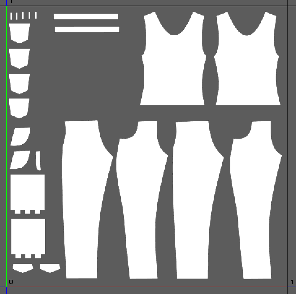

    So, I thought I figured out how to do texturing within MD.
    But, while the diffuse maps come out fine using the MD UV editor, on the other hand the Normal and Roughness maps just dont work properly when using graphic/decals.  The graphics are not lining up in the normal vs diffuse map views (which i guess i could correct manually for each one, but why this isnt automatic i dont know?). But also where a graphic doesnt have a normal map, the auto-generated normal map just shows up completely black.  So i guess I would need to make a corresponding normal map for every graphic i use.
    1056 x 1011 - 83K
    993 x 359 - 43K
    974 x 363 - 54K

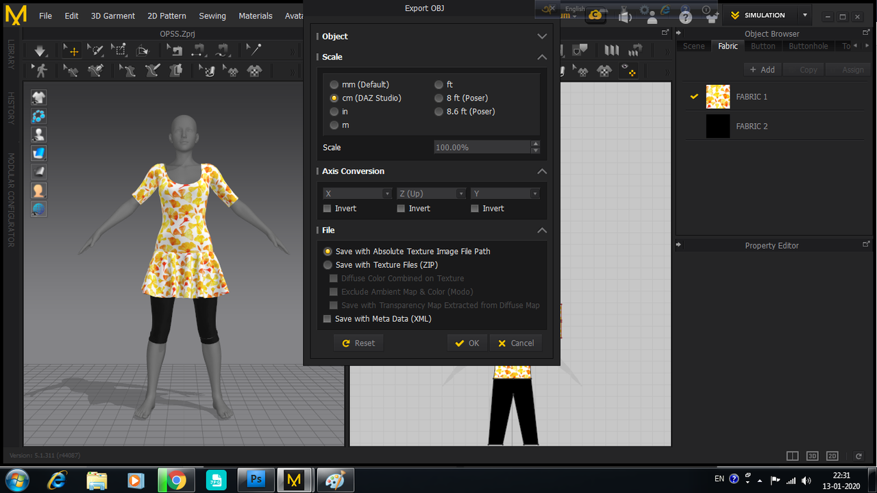

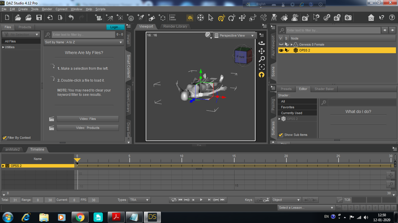

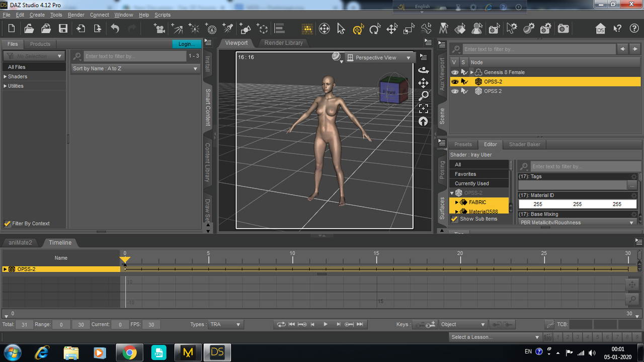

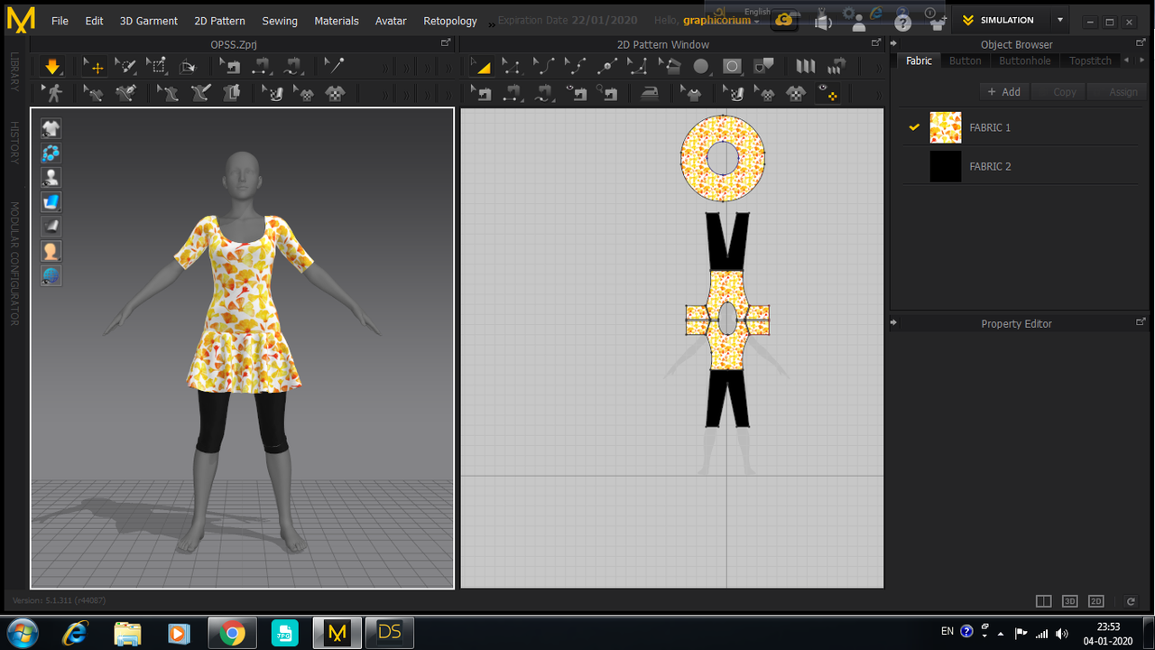

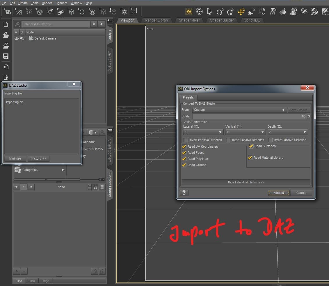

    I had Created this dress in Marvelous Designer 9 :
    Now I wanted to import this dress in DS 4.12 and use it on the Gen8 female figure, I saved it as OPSS 2.obj But it did not show up after import, although it can be seen in the Scene Tab. I renamed it again as OPSS-2.obj, but still it did not show up :
    I need help on this
    UPDATE : One user suggested that :
    Maybe it is a scaling problem on the export and/or import of the OBJ. Hide G8F. Select one of the OPSS-2 items in the scene pane. Type Ctrl-F to frame the selected object in the viewport. Can you see it now? If so, it may have been scaled so tiny it was inside of G8F or so large it was way outside of the viewport.
    I did exactly that and this happened :
    Now what to do?

  • lilweeplilweep Posts: 2,879
    edited January 2020
    So .... Zoom out?  Where is that in reference to scene origin?
    Also, you have evidentally exported your avatar from MD with the garment together.  So you would need to fix that.
    Orientation of your exported garment-avatar combo from Marvelous Designer also seems rotated.
    What are your export settings from Marvelous Designer?  The 1st page of this thread has recommended export settings.  (Note: to export your textures from MD as a diffuse texture, you would need to check a few extra boxes.)
    Post edited by lilweep on
  • bbaluchonbbaluchon Posts: 34
    edited January 2020
    Looks like you exported both the dress (patterns) and the figure (avatar), on incorrect scale.
    Check only "patterns" : select all needed patterns > export Obj(selected), uncheck "export avatars", and select cm (DAZ) scale. It should work without trouble.
    Use "thin" and "weld" options as well.

    These are the Settings : NOTE : I Had unchecked the Select all avatars option.
    edited January 2020

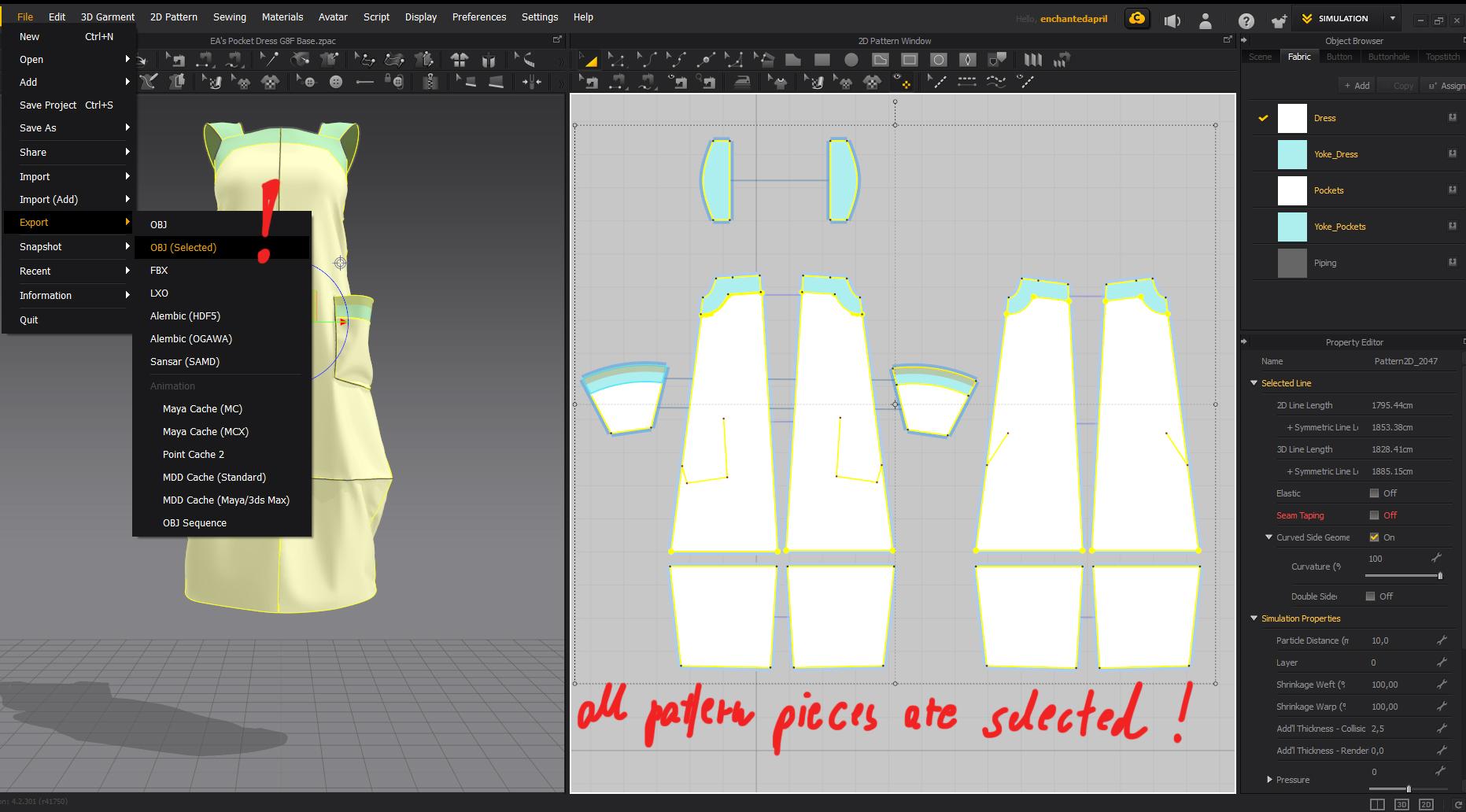

    Weird.  Maybe humour us and try again using the Export Settings Enchanted_April describes on the first page of this thread and see what happens when you import into Daz?  Export settings from Marvelous Designer can be a bit particular.
    If you are still having issue with exporting your Avatar together with your clothing, then delete the avatar before export. (Avatar>Delete All Avatars)
    The secondary issue of your Imported Obj potentially being far away from scene origin or very small/large, and therefore not visible upon import when viewing the scene at origin, could be due to either:
    • Export settings from Marvelous Designer
    • Export settings of Avatar out of other program (I assume Daz Studio?)
    edited January 2020
    Your axis should be X, Y(up) and Z when importing avatar, and exporting.
    Scale issue may be caused by incorrect importation of avatar ; check you exported your Genesis base at daz default settings, with 100% scale, and imported into MD with those settings :
    Import (add) OBJ > add / load as avatar / Scale cm (DAZ) 100% (uncheck auto-scale) / Axis X, Y(up), Z (uncheck all invert) / Translate 0,0,0 (uncheck align bottom).
    If your avatar is still exported with garment, check if you didnt mistakenly import your genesis figure as garment.
    Try deleting avatar in MD (avatar menu) to see if your figure is deleted, then export to see what happens.
    Post edited by bbaluchon on

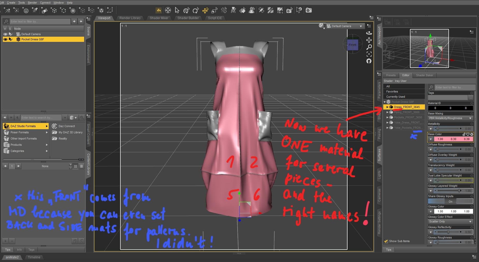

    I have a weird thing happening.
    I exported my garment and textures from MD.  I see a problem when i put the textures into Daz, where one of the textures is rendering lighter than it should.
    See attached 3 textures for different areas of garment.  The 3 textures applied to character look the same colour in viewport and in the textures. When rendered, one of them appears lighter than the other two textures.
    All the surface variables look to be exactly the same for every surface zone the textures are applied to.
    Hmm nevermind, I moved the offending textures to a different UV tile in the UV Editor and I also imported my garment OBJ without reading material library.
    Not sure which one solved the problem but looks okay now.
