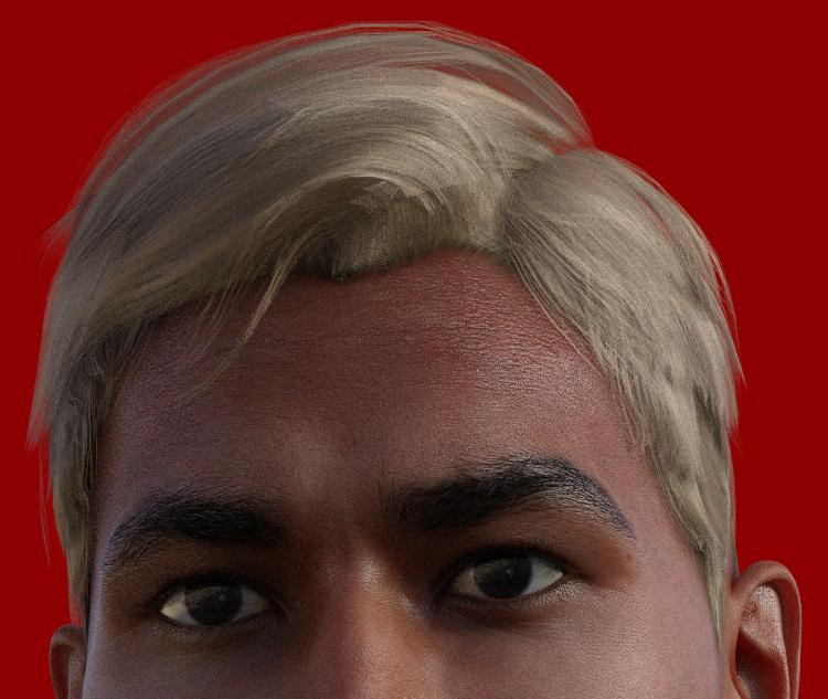

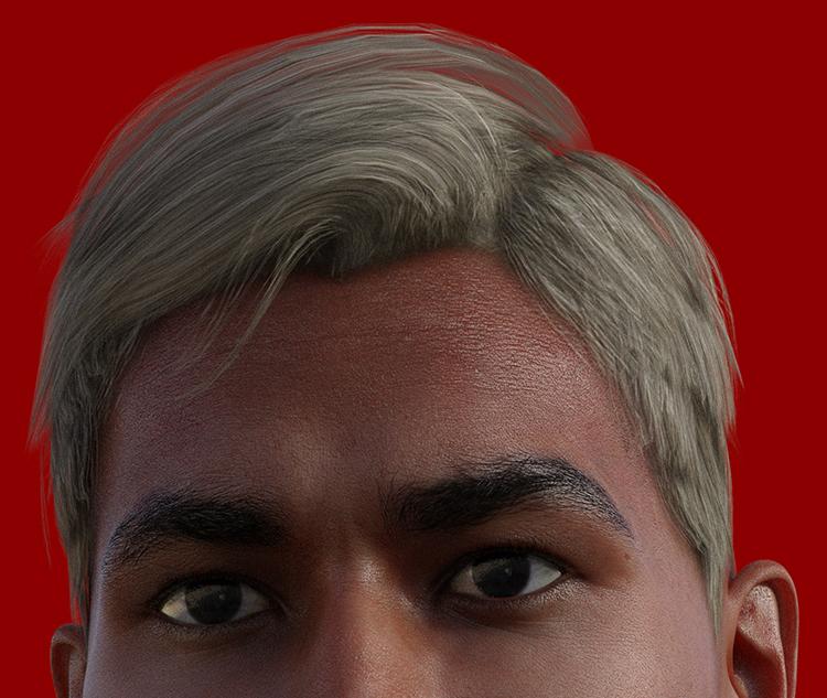

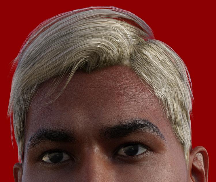

    L'Adair said:
    carrie58 said:
    L'Adair  aren't there hair shaders for Iray,you could use on the older hairs??
    Yes. I should give it a try. I have OOT's IrayHair Pair Shader.
    However, I don't think either OOT's shaders or Slosh's UHT shaders will help where sections of hair appear to be floating over the head... I'll show you what I mean, but I'll have to render it first...
    Okay. Here are three closeup renders of the hair. I used a dark red background with blonde hair so the empty space would be more obvious. While playing around with it, I did determine that from most angles, it's not obvious. And if the contrast between the hair color and the background is low, it also isn't as obvious.
    In these images, the worst area is the "part," at the top. The "empty" area below the top hair, near the part, is more obvious when not using any background; Something I do a lot of, but which is easier to fix in postwork...
    The first image is refit hair on G3M with only the Iray Uber Shader applied.
    Testing Iray hair shaders, GQ Event on G3M, first image, by L'Adair
    The next image is the same, but with OOT IrayPair Hair Shader applied over the Iray Uber Shader.
    Testing Iray hair shaders, GQ Event on G3M, second image, by L'Adair
    And the last image use OOt IrayPair Hair Shader and textures.
    Testing Iray hair shaders, GQ Event on G3M, third image, by L'Adair
    Applying the textures from OOT's product didn't work that well. Closeup, anyway, you can see straight edges that should be strands instead. As it turns out GC Event is one of the small percentage of hair products that doesn't have the "UV-mapped in a straight, square format." Still, just applying the shader made a big difference.
    750 x 633 - 462K
