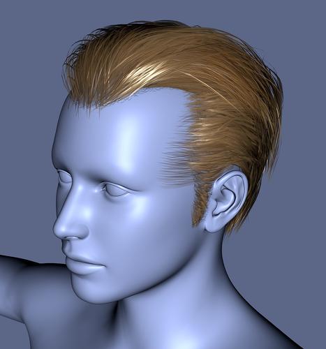

    OK.. home from work. Well this person def has some good little hair props. I downloaded the Gaga one... since i'm one of her little Monsters.. lol Came over beautifully with all morphs.
    Here is what I do when I'm not sure if a prop is made for a figure... I DON'T assign it to one..
    1) make sure the hair is parented to the head before you convert it to a figure
    2) convert using the Transfer Utility but DO NOT choose a clone, just leave it at default.
    3) Do NOT check off any extra boxes except for adding a smoothing modifier, the rest leave at default.
    4) Choose your hair type, short or long so it's auto conformed to Genesis.
    Convert... should work.
    1327 x 671 - 295K

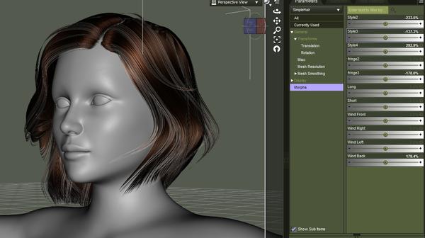

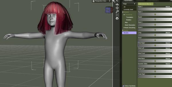

  • RAMWolffRAMWolff Posts: 10,382
    Simple Hair converted just fine. Follow my tips and you should be good to go. The morphs on this hair prop are not very well executed though. They totally need reworking. The Gaga hair performs better. The long morph just goes out forward and the others are kind of ... just OK... and others are a total miss for me.
    1228 x 687 - 317K

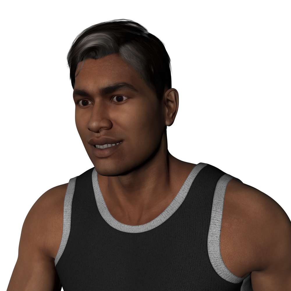

    Hi,
    Thanks to that brilliant hair tutorial I was able to get Guillaume Hair to work on M6, it mystified me as to to why Neftis made that an hr2 (That's a Poser format, and FiberMesh hair won't even load in Poser.) and not a conforming style, if it had been then I could have used autofit. Still, the tutorial worked and I can now use it as I intended to.
    I owe you a big debt of gratitude, as I would have returned the hair (which I actually did a year ago when I previously bought it for Poser) had I not found your tutorial
    CHEERS!
    PS (The render took 4 1/2 hours!)
    576 x 745 - 245K

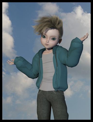

    Nikkou hair fitted to the BalljointBoy (a bit in a hurry - with more time I could do better) and rendered in PP2014
    He doesn't know what you are talking about ... LOL
    (Just a fun render, because I had to test your statement)
    Merry Christmas!
    738 x 960 - 169K
