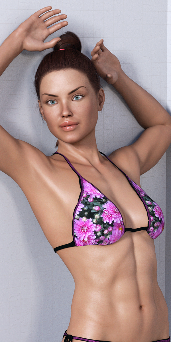

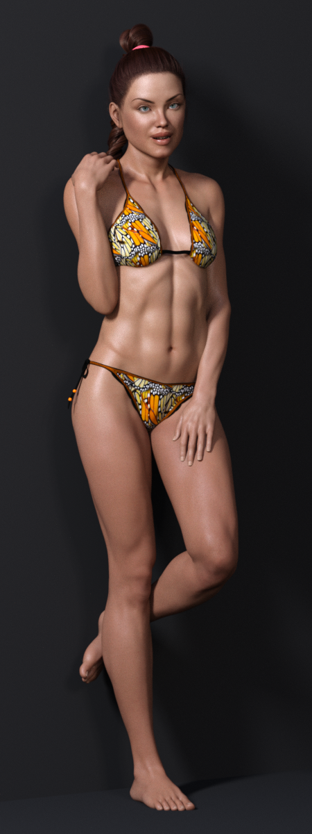

This is using that Premium Portrait Poses- Wall pose, walls, and lighting. I moved one of the lights and changed the brightness (use Surface pane) You get one long rectangle mesh light to the side, and one torus (ring).
TIP: Using Metallicity and Metallic Flakes
What I'd like to show you is the addition of metallicity to your characters to change skin sheen. It helps if characters' skin is a bit flat, without highlights. Even those who aren't may benefit from a little more pizazz when lit. Metallicity to the rescue. To be more specific- a teeny, tiny, miniscule addition of it. Here is a few settings to get you started and you can play around with them from there:
Metallicity at .098
Glossy Reflectivity .80
Glossy Roughness .50
Base Bump 1.34
Metallic Flakes Weight .0010 PUT THIS IN FIRST, then the rest of the menu will open up.
Metallic Flakes Size .00070
Metallic Flakes Strength .35
Metallic Flakes Density .23
EDIT: The metallic additions will probably darken your skins and make them a bit blue. Here's more fine tuning to add even more realism- and the link showing it in action. Click HERE. It will show you the suggestions listed below, as applied to a character.
1. Look at the Tranlucency Weight setting. Whatever it is, lower it and se how you like it. This offsets the darkening of the metallicity. The translucency is .45 on many characters, lower it to .34
2. Next, the Dual Lobe Specular is usually 0. Try .010
3. The Dual Lobe Specular Weight, try .010 with the Reflectivity- from .50 (depending on other settings the vendor uses) to .77 (I start high and then go lower, but the one's I've tried do great at .77 IMO)
4. The metallicity / translucency / dual lobe may darken / change skin tones to more blue, so in the SSS Reflectance Tint, do MINISCULE color changes. Try 255 / 242 / 239 to correct blue skin tones. It's a really, really light whitish pink, barely noticeable but makes a big difference.
5. Make sure Glossy Reflectivity is at 1.00 Turn down your Glossy Roughness a couple tenths. (Many are .50 so turn that down to .48)
6. Last, increase your Saturation 1.15 to 1.28 to bring color back into your person. (Saturation is in the Render pane, in Tone Mapping.)
The characters below do NOT have these newest edits.
So open each in a separate window and click back and forth for the first four. The first one is the default skin, the second is mine with the metallicity and metallic flakes, etc (for the portrait one, and the first standing pose.) Then the last two are with the metallicity and fine tuning. I like a more "sweaty" skin for outdoor people, but even indoors- some of the characters seem a bit "dry." It will all depend on your lighting too.
@worldsedge You're welcome. I just checked, that was with just the default Iray lighting. I did allude to it in the post, but your lighting will make a HUGE difference so far as the reflections. I'd try increasing the bumps before lowering the metallicity or flakes, etc.

Brenna for Ophelia 7 SwimWear for Genesis 3 Female(s) Audrey Hair for Genesis 3 Female(s) Premium Portrait Poses-Wall
Metallicity at .098
Base Bump 1.34
Default
With Metallicity
Before and After
Afters
Wow the skins look fab with metallicity added. I’ll be using this tip. Thank you,
