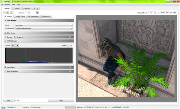

    Single Distant light (sun sky2), Auto Linear, twelve hours, smidge over 400 S/p. Normally I'd do some postwork (a quick contrast mask) to lighten up the shadows a bit, but this time I set up a white plane-primitive to bounce light towards the scene, like the opposite buildings and things in the street would do normally. This morning I tried to postwork it, but nothing I could come up with looked better than the base render! :ohh:
    Tourist Sitting in a Shaded Alcove
    2000 x 1600 - 2M
    1682 x 1018 - 650K
    1020 x 817 - 188K
