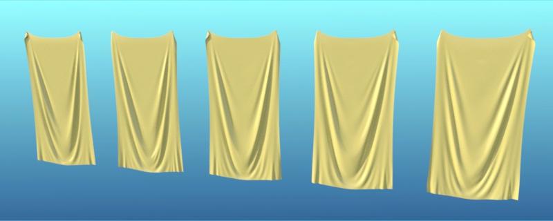

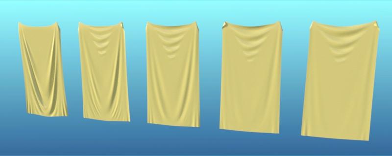

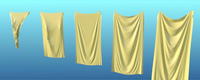

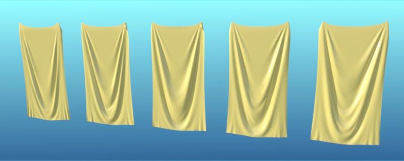

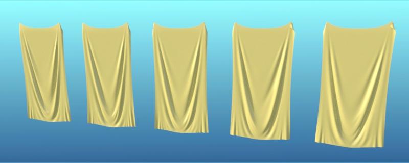

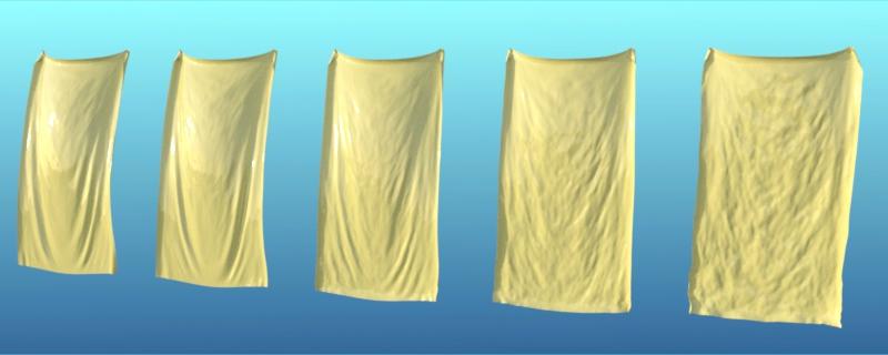

    13. dForce Surface Parameter Tests.
    To test out the influence of various surface parameters, I've created a test rig of five towels having the same influence weight map as I used in 11 and 12 above. This map has two small areas where the clothes pin hold the towel. Note that once you have the influence weight map, you no longer actually need any pins or clothesline, the towel will be held in mid-space as these upcoming images show. Default values are used unless noted in the description.
    a. Dynamic Strength. After Friction, this is the next surface parameter in the Simulation tab on the Surfaces pane. This parameter is meant to be applied to accessories like belts, buckles, buttons, etc. to keep them from distorting. A value of 1 allows the vertices to move freely and a value of 0 stops all movement. Intermediate values suppress movement but I have found it acts quickly. The image below shows 5 towels. From left to right:
    1. 1.0 (default)
    2. 0.96
    3. 0.92
    4. 0.88
    5. 0.84
    As you can see, by 0.88, most of the draping has been suppressed. At 0.8 (not shown) it all is.
    The above image doesn't show much since it was draped vertically with gravity alone. The next image has wind applied. As you can see, there's a lot more variation on towels 4 and 5 then what shows with the vertical draping. Since the folds that form in towel 1-3 are mostly suppressed, you wouldn't want to use these levels of dynamic strength for a towel, but you may want to for a piece of paper that was crumpled and then unfolded. If you take the Dynamic Strength down to 0.25 (not shown), the towel ends up flat and smooth.

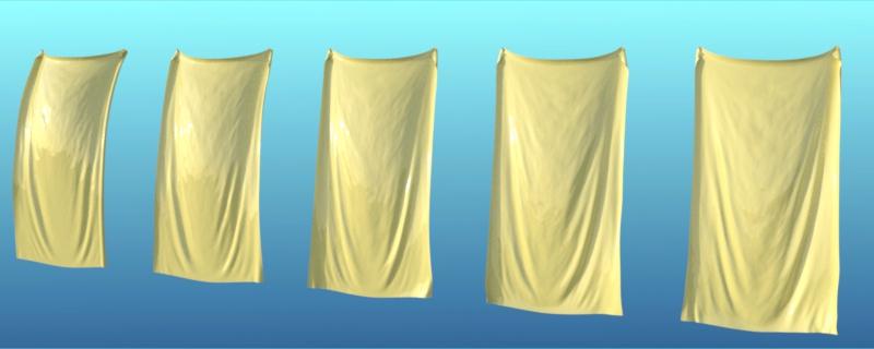

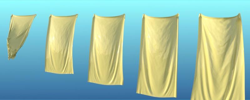

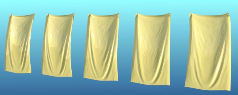

    b. Stretch Stiffness. The higher the value, the less a mesh will stretch. In the following image, from left to right, values are:
    1. 1.0                      less stretch
    2. 0.8 (default)
    3. 0.6
    4. 0.4
    5. 0.2                      more stretch
    Without wind, the biggest changes are found in the lower corners, where there are fewer vertical folds, and along the lower center where there are more but less deep folds.
    With wind, most differences are gone although a little less wavy in the lower corners.
    The changes are subtle which is true for a number of these comparisons.
    800 x 320 - 131K
    800 x 320 - 143K
    800 x 320 - 130K
    800 x 320 - 137K

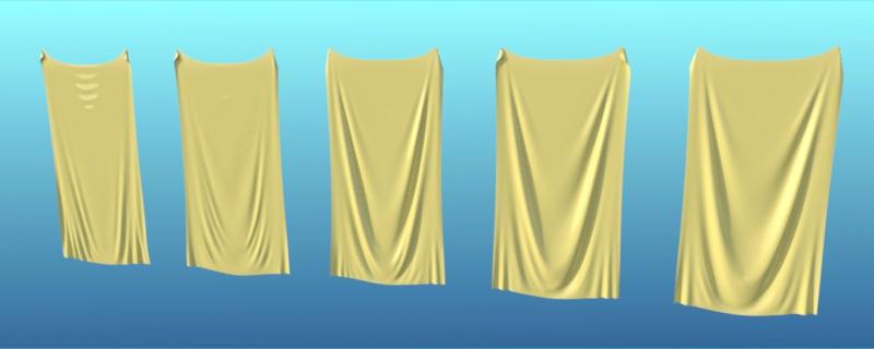

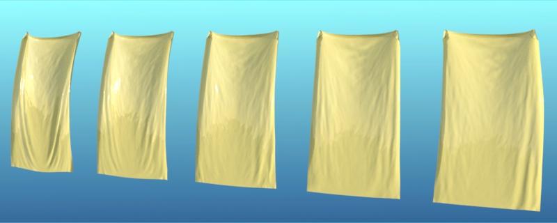

    c. Shear Stiffness. Controls the amount of resistance to lateral shifting and twisting. The higher the value, the less a mesh will stretch. In the following image, from left to right, values are:
    1. 0.2 (default)
    2. 0.4
    3. 0.6
    4. 0.8
    5. 1.0
    Without wind, you can see how the center drapes dramatically at the default value (left towel) and disappears as you go to the top value of 1.0 (right).
    With wind, you see a similar pattern.
    d. Bend Stiffness. Higher values will result in broader folds and shapes and lower values approximate thin and flexible materials. In the following image, from left to right, values are:
    1. 0.1                    thin material, fewer folds
    2. 0.3
    3. 0.5 (default)
    4. 0.7
    5. 0.9                     thicker material, more folds
    Without wind, you can see the enhanced folding at higher values (right). At lower values, the center section becomes smooth and seems to be draping more.
    With wind, there’s a surface disturbance that develops and some of the folding is reduced.

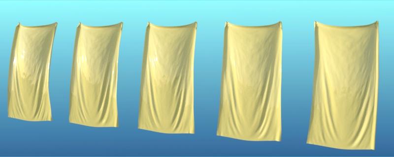

    e. Buckling Stiffness. Controls the amount of resistance to compression. In the following image, from left to right, values are:
    1. 5% (default)
    2. 25%
    3. 50%
    4. 75%
    5. 95%
    Without wind, it’s subtle but you’ll see the centers of the towels have somewhat more draping at higher values.
    With wind, it’s again subtle but you’ll see draping starts higher up the towel as the value increases.
    f. Buckling Ratio. Higher values should behave more like flexible silk while lower values behave more like denim. In the following image, from left to right, values are:
    1. 10%                        denim
    2. 30%
    3. 50%
    4. 70% (default)
    5. 90%                        silk
    Without wind, not a lot of variation…
    …nor is there with wind.
    800 x 320 - 134K
    800 x 320 - 138K
    800 x 320 - 130K
    800 x 320 - 136K

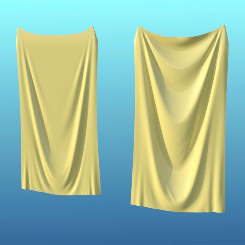

    i. Combined Effects. The above image series were single-variable tests. Obviously you can combine these parameters in many, many different ways. I went through and chose settings that tended to cause more folds in the towel. The image on the left shows the default dForce surface values while the one on the right shows the combination (note: in the PDF I have the image descriptors flipped in this paragraph, the words here and in the table are the correct order). You can see that the settings I chose did indeed enhance the amount of folding. The settings used are:
    Left Towel
    Right Towel
    Dynamic Strength
    1.0
    1.0
    Stretch Stiffness
    0.5
    0.2
    Shear Stiffness
    0.2
    0.2
    Bend Stiffness
    0.5
    0.9
    Buckling Stiffness
    5%
    95%
    Buckling Ratio
    70%
    50%
    Density
    180
    180
    Contraction-Expansion Ratio
    100%
    105%
    j. Note regarding these tests: The towel images above are static figures after simulation is complete. If you watch the objects while they are undergoing simulation, you can see more variation for some surface properties than in the finished results. As these are also free-hanging towels that are not interacting with other portions of clothing or other objects, they may not reflect the results you get while draping clothes on a figure.
    800 x 800 - 268K

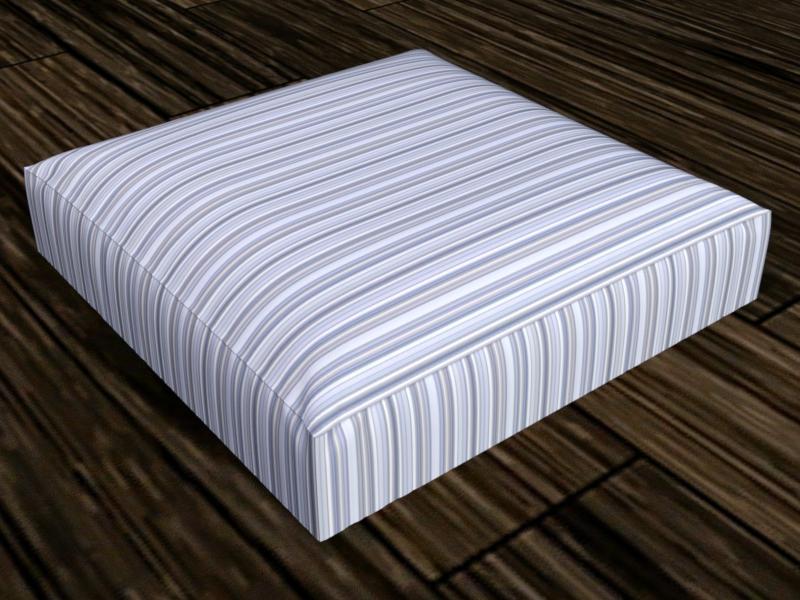

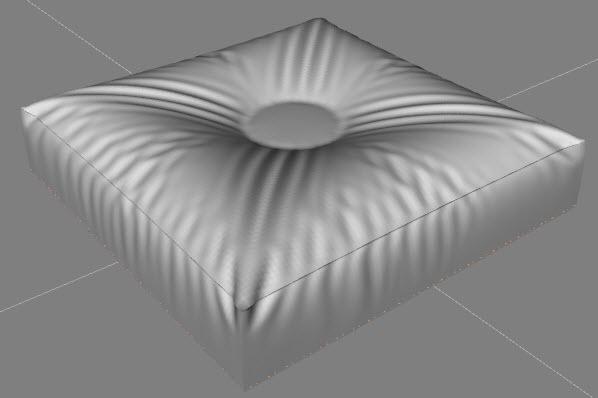

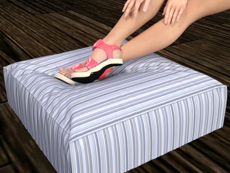

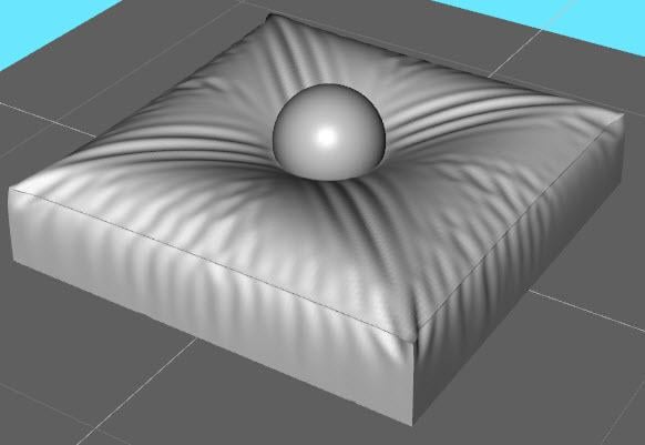

    14. Creating a Foot Stool.
    This is an example showing how you can use a primitive cube and negative gravity to create a foot stool which will react to objects and figures sitting on it.
    a. Create a primitive cube and scale it to be squat. You need enough polygons in the cube so it can distort, so set Divisions to 100 when creating the cube (Create/New Primitive). Select the cube in the Scene pane and then from the main menu select Edit/Object/Geometry/Add dForce Modifier: Dynamic Surface.
    b. Create a smaller primitive sphere and position it partially embedded in the middle of the cube. EDIT: Create a primitive plane to act as the floor. It needs to be at least as large as the cube. This acts as an anchor to hold the cube in place so it expands upward. See image below. Neither the sphere nor the plane receive a dForce modifier.
    c. Go to the Simulation Settings pane and set Environment/Gravity to -0.1. During simulation, this will cause the cube to expand instead of collapsing in on itself.
    d. Run the simulation and you will get something similar to this image. The negative gravity causes the fabric to push up and around the ball. It also causes wrinkling along the edges of the cube and pulls the material in from the corners. This gives the appearance of a plush foot stool being pushed down on by the ball.
    Without the ball, it looks like this:
    After rendering:
    This is a render without the ball. You can see that it’s partially puffed but without all the surface disturbance caused by the ball.
    e. Replace the ball with a pair of feet partially embedded into the top of the stool.
    Here’s the finished render showing a comfortable foot stool for tired feet!
    415 x 161 - 7K
    592 x 399 - 16K
    582 x 401 - 25K
    598 x 398 - 22K
    800 x 600 - 417K
    800 x 600 - 385K

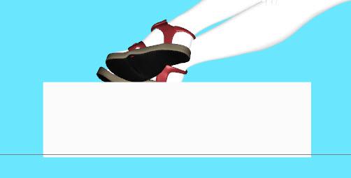

    502 x 255 - 15K
    800 x 600 - 374K
    Post edited by RGcincy on

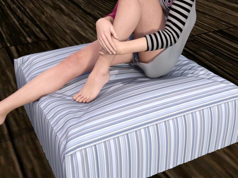

  • RGcincyRGcincy Posts: 2,862
    edited November 2017

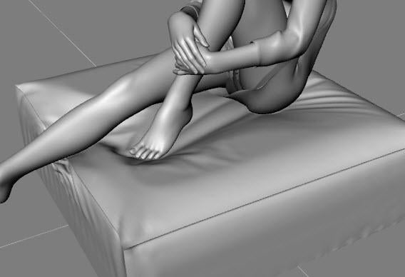

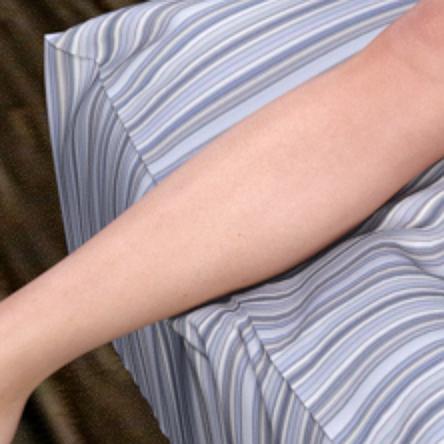

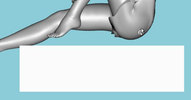

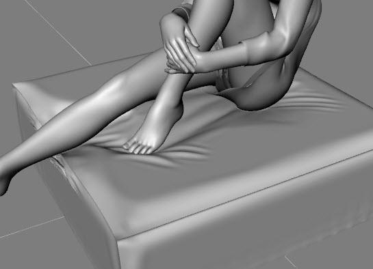

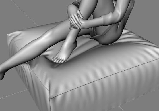

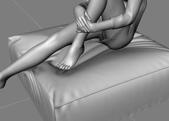

    f. Replace the feet with a young girl sitting on the stool. In this case, the figure is hovering over the stool before simulation, but the growth of the cube with negative gravity will push up into the figure.

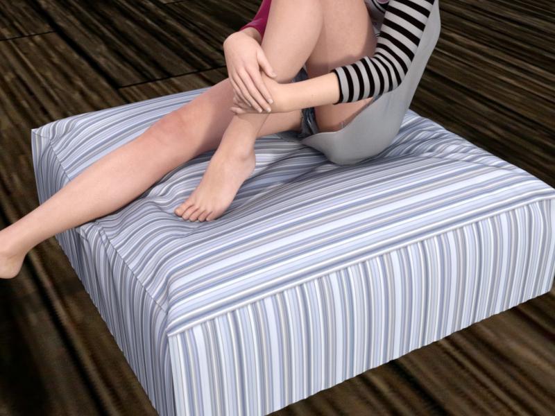

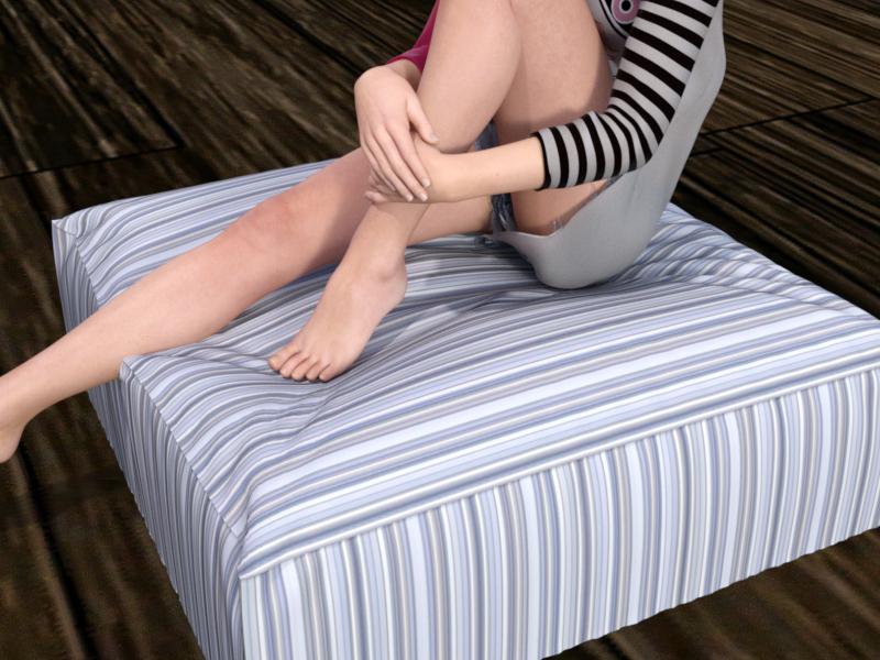

    g. In this example, we move the girl further into the stool.  Now you see more surface interaction then above, but you also see that the extended leg does not depress the edge of the stool as you might expect; instead, it’s like the leg cuts into the edge.
    Closeup:
    h. I didn’t find a way to use dForce to solve the problem but I could use a D-Former to push the edge down. I used a very small weak field as you can see in the right image.
    Here’s the resulting render:
    In this closeup, you can now see some space between the leg and the fabric which looks more like you would expect in the real world:
    When you use a D-Former or Push Modifier to modify a simulation, remember that you are moving away from a physics-based outcome. So use judiciously, more to nudge things rather than make dramatic changes.
    616 x 322 - 19K
    800 x 600 - 391K
    640 x 310 - 18K
    800 x 600 - 483K
    444 x 444 - 186K
    413 x 350 - 23K
    460 x 439 - 36K
    800 x 600 - 370K
    444 x 444 - 181K

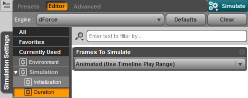

  • RGcincy said:
    f. In this example, we move the girl further into the stool.  Now you see more surface interaction then above, but you also see that the extended leg does not depress the edge of the stool as you might expect; instead, it’s like the leg cuts into the edge.
    Closeup:
    g. I didn’t find a way to use dForce to solve the problem but I could use a D-Former to push the edge down. I used a very small weak field as you can see in the right image.
    Animated drape, or drape from memorised, with the leg initially raised?

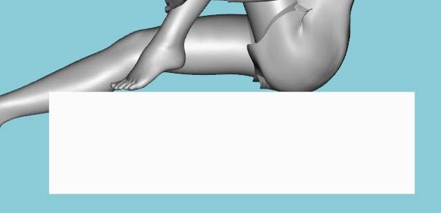

  • sapatsapat Posts: 1,735

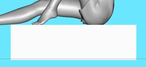

    I'm putting the sphere on the flattened cube and running the sim, but my cube isn't doing anything.  I have a plane, then the flattened cube, and the sphere partially submerged in the cube.  Then I add a dforce dynamic modifier to the cube because even though you didn't mention it in the scenario, the sim won't run without it.  I set the gravity to -0.1 as you said.  When the sim is done it pretty much looks like it started out.  No dent and no wrinkles.  Am I doing something wrong?
    746 x 546 - 23K
    Post edited by sapat on
    sapat said:
    I'm putting the sphere on the flattened cube and running the sim, but my cube isn't doing anything.  I have a plane, then the flattened cube, and the sphere partially submerged in the cube ... I set the gravity to -0.1 as you said.  When the sim is done it pretty much looks like it started out.  No dent and no wrinkles.  Am I doing something wrong?
    The only thing that comes to mind is how many divisions does your cube have? It should have something like 50-100 to give it enough polygons to work with. If you don't recall what it had when made, set your viewport to wire shaded to check). I'll add this to the directions.
    Good point, I keep forgetting to mention that step. I'll add this in too.
    RGcincy said:
    Good point, I keep forgetting to mention that step. I'll add in it.
    Yikes, my cube only had 24 divisions.  I'll really have to amp it up, thanks for the tip.  Oh, and yeah, that pesky dforce modifier, LOL!
    It was a static pose with the cube and the figure in the final position. Draping the figure from a memorized pose (T-pose) causes a crash as the feet catch and wrap the cube around the figure. Because of your astute question, however, I tried an animated pose with the leg initially raised and it works much better. I'll be updating the writeup to reflect animation. Thanks!

    Ok, I ramped up the cube divisions to 100 and it made all the difference.  Great spot for kitty to curl up and sleep!
    1198 x 888 - 104K
    Cute!! Glad you got it to work. I updated the write-up to cover the two points your question raised.

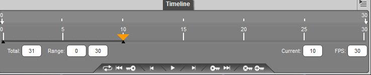

    15. Animated Posing for the Foot Stool.
    An astute question by Richard Haseltine led me to try a better way to bend the edge of the cushion: animate the extended leg so it comes down onto the cushion rather than starting within the cushion.
    a. Set everything up the same as in section 14. Be sure Start Bones From Memorized Pose is turned OFF in the Simulations Settings.
    b. If not already open, go to Windows/Panes (Tabs) and select Timeline.
    c. Set the total number of frames to 31.
    d. On the timeline, click on frame 10 then click on the + Key icon in the lower right of the pane. This sets the pose we’ve been using as the final pose.
    e. On the timeline, click on frame 0 then click on the + Key icon again. Next select the figure’s shin and bend the leg so it just clears the edge of the cushion.
    f. In the Simulation pane, under the Duration tab, select Animated (Use Timeline Play Range) from the drop down box.
    g. I found that 10 seconds was enough time for the leg to move down and depress the edge of the cushion in a natural fashion. However, if you only have 10 frames in the timeline, that was not enough time for the cushion to fully expand so the figure did not look like it was sitting into the cushion.
    The final render:
    h. This was the first time I’ve used an animated figure pose. Besides the advantage of removing interference between the extended leg and the edge of the cube, you can use the timeline to see how the simulation is progressing and choose an intermediate time for a render.
    Here is the 10th frame:
    15th frame:
     20th frame:
    30th (final) frame:
    i. There’s another way to do an animated pose (set Start Bones From Memorized Pose to ON) but in this situation it will just cause a crash. The figure will start from the T-pose, dive down into the cube as it moves into the desired pose, and wrap the cube around its feet in the process. As it wraps, all goes haywire and Daz Studio will shut down.
    [Edited to Add]image You can change the Memorized Pose to one that will work. In this case, move the extended leg as in step e. so it clears the edge of the cushion. From the main menu, select Edit/Figure/Memorize/Memorize Figure Pose. Now move the extended leg back down into the cushion where it was before. In the Simulation Settings pane set Start Bones From Memorized Pose to ON and run your simulation. I found this to be slower than setting up the animated scene but others may find this a better approach. Here's a render, which is only slightly different from the animated result:
    738 x 149 - 20K
    508 x 233 - 15K
    495 x 196 - 33K
    800 x 600 - 368K
    444 x 444 - 184K
    545 x 394 - 23K
    568 x 388 - 23K
    547 x 391 - 24K
    559 x 392 - 24K
    800 x 600 - 366K

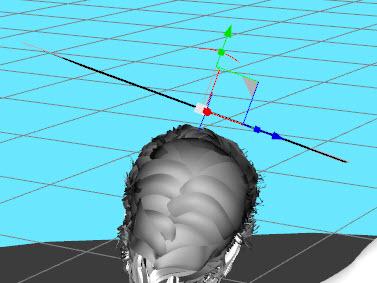

    16. Head Scarf and Telephone Wires. This shows two other objects you can make with primitives and dForce. These are pretty straightforward if you’ve performed the steps in the previous sections: position the object, apply the dForce modifier, run the simulation.
    a. The scarf in this image is a square plane positioned over the head to match the rotation angles of the head. The center point of the plane is vertically above the center point of the head so it's centered when gravity pulls it down.
    b. The wires in the next image were made from primitive cylinders. After applying the dForce modifier, I then added a dForce weight node and removed the influence from just the tips (paint while holding down the Alt key to remove weighting, see section 11 for details). I found a Gravity of 2.0 and a Stabilization Time of 0.3 allowed the wires to sag without the tube going flat.
    377 x 283 - 43K
