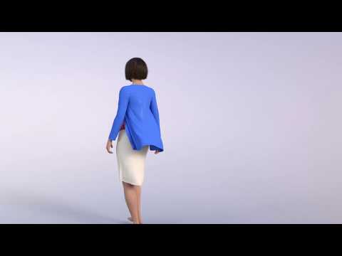

    I haven't had the chance to read all this thread yet (21 pages already!) but I just wanted to share this little animation of clothing I made myself with Marvelous Designer and animated using dForce.
  • PendraiaPendraia Posts: 3,618
    It drapes really nicely...great job!
