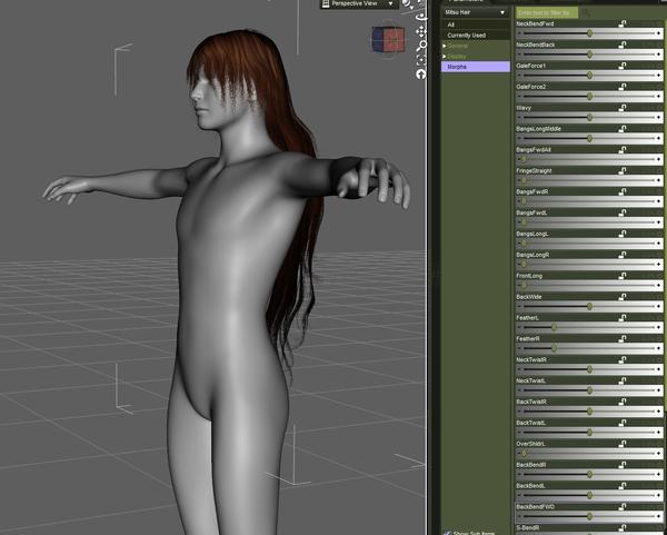

  • AeonicBAeonicB Posts: 166
    Unfortunately, I tried to bring over the Mitsu Hair included with the old Aiko 3 bundle, and it hasn't seemed to have kept its morphs. At least its a cheating way to fit on Genesis, but its useless without the posing morphs. Any clues?
  • RAMWolffRAMWolff Posts: 10,381
    edited September 2012
    Is Mitus hair a CR2 or an HR2 file? I'm assuming it's an HR2 file but it SHOULD retain the morphs. I just loaded it up. I don't have the time tonight to try messing with it but the morphs are there so they SHOULD transfer... oh what the hell.. now I'm going to wonder about it... Be right back.....
    OK, just ran my tutorial and it works fine and the morphs are there. Make sure you followed the tutorial to the letter except choose Aiko 3 as your morph target (number #6 in the tutorial).
    Suggestion, make sure, before you save it out as a .duf file to Convert to Sub-D since the conversion does tend to kink up the area where the shoulders are in the hair. Sub-D smooths that out just fine.
    Have fun! :-)
    1271 x 1019 - 394K
    Post edited by RAMWolff on
